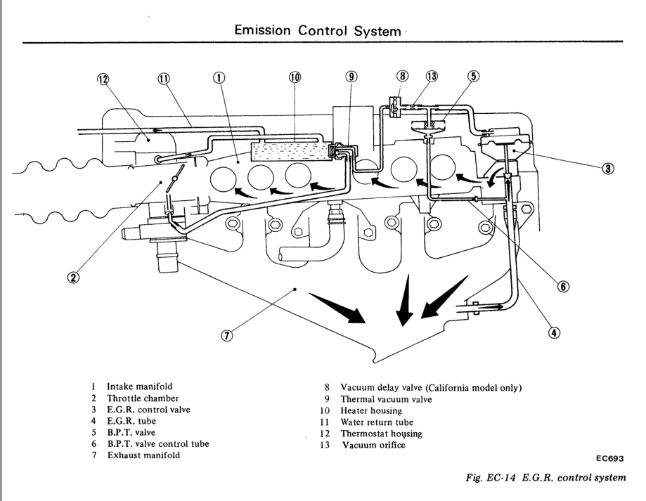

Recently I noted a leakage in the coolant tubes on the engine block, and in the one in the thermostat housing, so I purchased new ones to replace those. The problem came when I actually tried to replace them: I found that my car had an extra line that came out of the tube on the front of the block and to a part that sits on the upper side of the intake manifold, that has a lot of what I think are vaccum lines to different parts of the car, and another line to the thermostat housing.
I didn't found those in the diagram that comes in the FSM (then again, I'm kinda bad reading diagrams), and I don't know what are those line for. The parts that I bought are for that model in particular, but the tube doesn't have this outlet.

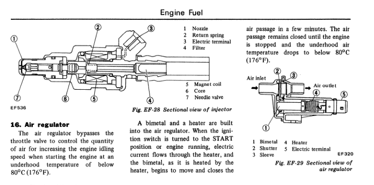

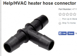

Those lines run to your Auxiliary Air Regulator (AAR) mounting block, and,probably, the EGR system.  You could get a T fitting to put in to the hose for the return line.  I think the hose size is 5/8".  I posted a picture but the size is wrong so don't buy that one.  An auto parts store will usually have a selection of sizes.
