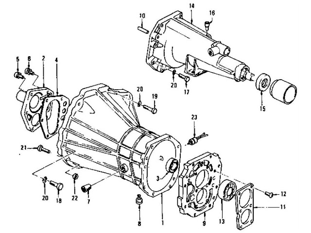

280zx 5 speed
18
BOLT-FIXING T/M TO E
08131-06510
5 SPEED
1
19
08131-06010
5 SPEED
3
20
WASHER-LOCK FIXING T
08915-24010
5 SPEED
4
21
08110-82510
5 SPEED
2
