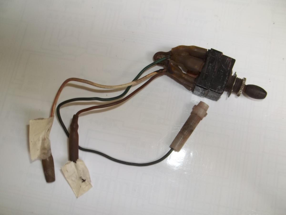

+1 on an alternative antenna switch possibility.  The female connector is likely the power into the switch, the other two will be power out to the up and down sides of the motor.  However - an antenna switch has 3 positions: neutral/up/down.  If this switch has only 2 positions, all bets are off.
