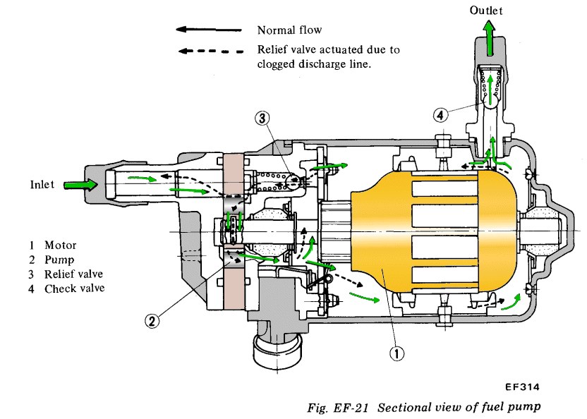

I can't edit that post but this thread talks about the check valve in the original fuel pump. It works like a valve stem for a tire but backwards, it lets fuel leave but not flow back in.
That photo has a small error. It would be better to call the " check valve " the pressure relief valve. Its meant to relieve pump pressure back to the pump inlet. It generally relieves at about 55 to 65 psi. When you clamp the FPR return line shut, the pressure you see is this relief valve pressure and not the maximum pressure the pump can produce.
The check valve is in the replacable discharge nozzle.

The pressure leak down mentioned in this thread is mostly a problem with hot engines. I don't think you have this problem. I have not seen you mention cranking for long periods when hot.
I fitted a gauge and noticed this problem. The pressure would fall to zero in a minute. The hot engine would then cause vapour lock pushing more fuel through the check valve back to the tank.
I know EFI doesn't normally suffer from vapour lock, the pressure is normally high enough to prevent it, but my gauge would read 0 psi and then its possible with a hot engine. Sometimes it would take upto 10 seconds to get it started again.
When it was cold it would start reasonably quickly, but run really rough for a couple of seconds then run ok. I think that was because the cold start valve had less resistance (bigger hole) and would add fuel atlower pressures. That way it would start ok, but then rough until pressure built up.
A lot of searching and I found the check valve on the internet and that solved the problem. Still have a couple spares if someone needs one. It now starts in 1-2 seconds even after sitting 2 months.
