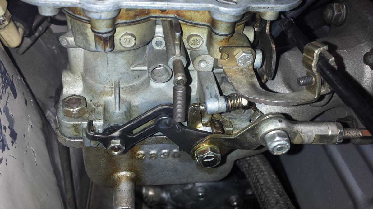

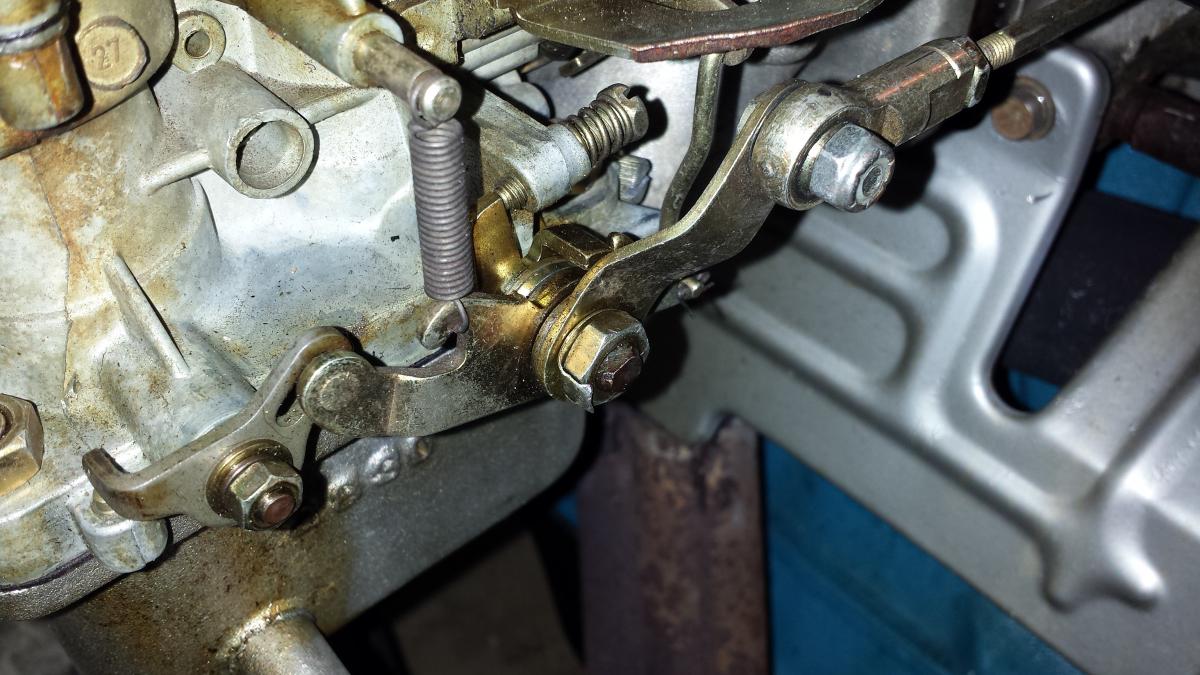

Redline also suggested a 10-15% performance improvement could be made by converting the linkage from progressive to synchronous operation. With a progressive linkage, the throttle travel operates only the first barrel for the first half of travel and starts opening the second barrel after that. With synchronous operation, both barrel open together. While this doesn't affect wide open throttle performance, it provides the equivalent of a 49mm single barrel carb compared to the 48mm of our SUs. The standard 32/36 DGV operates solely on the primary about 90% of the time.

I have installed the linkages and richened the main mixtures by three steps as well as leaning the idle mixtures to the proper sizes.
Mid throttle response, where we live 90% of the time, has dramatically improved since I'm using the full 49mm equivalent rather than the 36mm of the original setup. It makes driving the car a much more enjoyable experience.

The original progressive linkage

The new synchronous linkage
