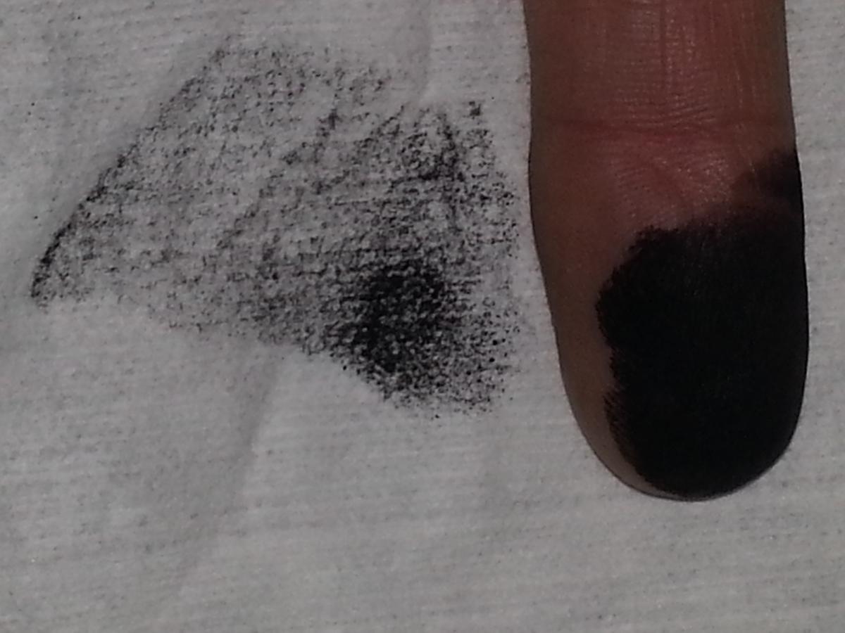

I have to take my ailing get dog to the vet in the morning, but in the afternoon I will pull the plugs and photo them. And stick my finger in the tailpipe. I can tell you now tho, it looks very black. I Think when they put the AFM on that she was running lean. Think.

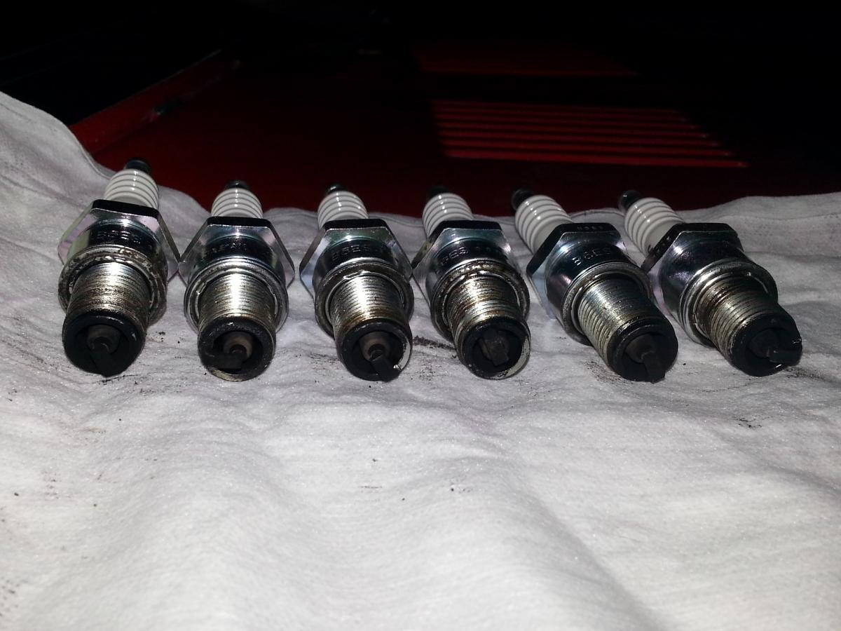

Finally getting the spark plugs and the swipe of the exhaust pipe photos uploaded. I was not able to lighten the photos, there is a confusion between my cell phone and my tablet.
They are both pretty sooty. The spark plugs were put in RedBird on August 15. But because of the problems with her, I doubt I have driven her more than 50 - 75 miles max.

I don't really see any signs of moisture either.  Coolant in the cylinders tends to clean them up.  The good - it doesn't look like a major engine problem.  The bad - still unknown.
Maybe Steve should have put those 240Z carbs on there...
Are those the same plugs from "before" the new AFM? If so maybe cleaning them and putting them back in for a few miles, 100 or so, and then read them again.
Could there be water in the tank? I don't understand the temporary white smoke.
Yes, those plugs were in RedBird since August 15, and the AFM was put in a week ago yesterday.
