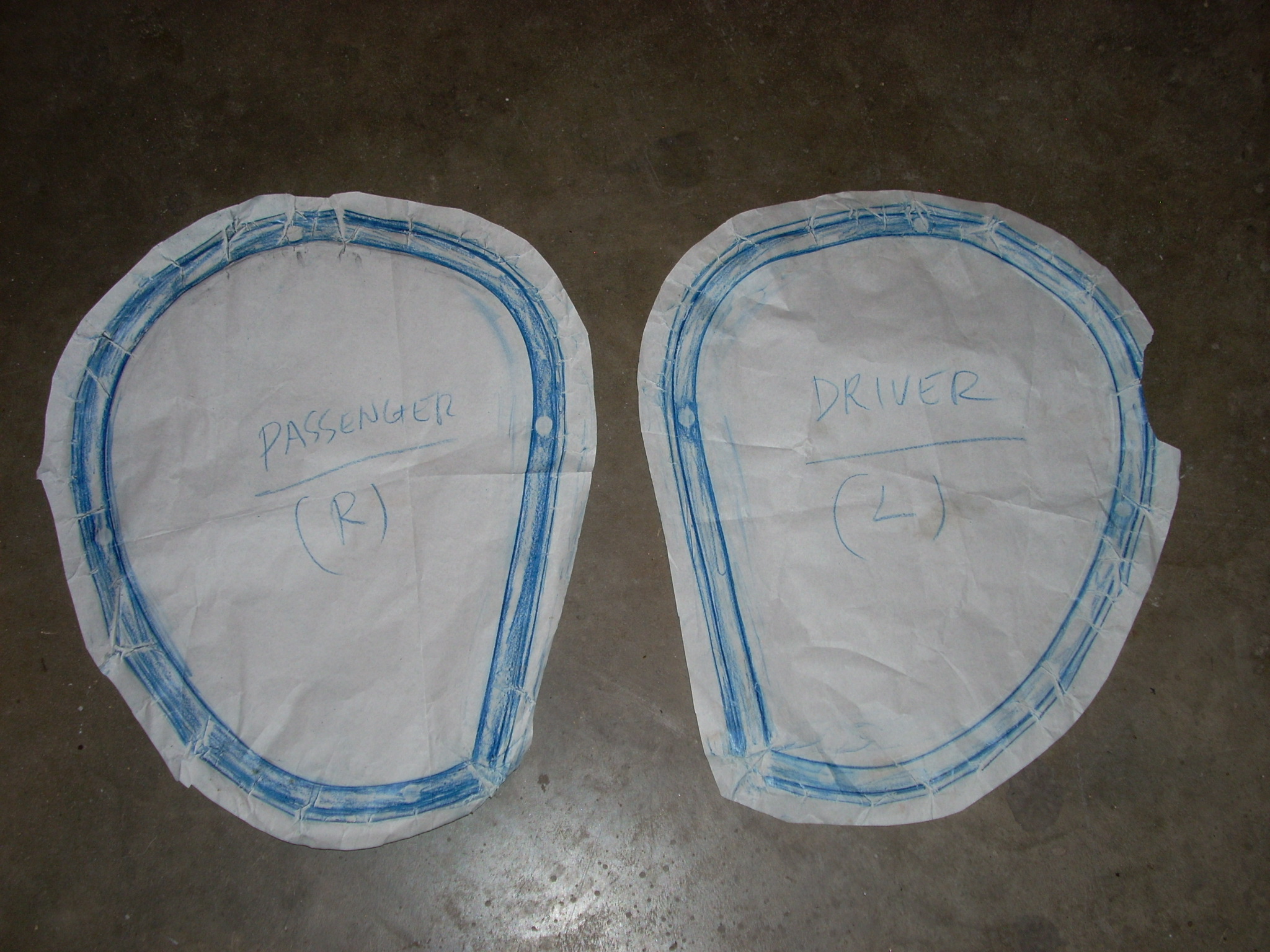

Just a minor update. I was talking to a friend who does industrial fabrication. He has a really nice waterjet and is going to cut the revised forms for me. That is going to save me a ton of time. Once he cuts them for me I simply have to shape (curve) them to fit the buckets (following the tracing of the Original I was provided) and then I'm in business.  Should cut down on the fab time significantly.  Stay tuned. :)

I don't know about the u shape Looks flatter than that like in the above pic. What I'll be making will be very close to those. All the water jet will do is cut out my forms so that I can shape them to fit a headlight bucket and my tracing. By forms I mean hammerforms. That is how I will make them once the forms are completed.  As for the asymmetric part all the blanks will be oversize, I'll simply trim to fit. One side high, one side low. Then finish (very slight roll)the edges.
Look I get that you don't think I can do it. Do I care what you think? Not really. . Spread your negativity somewhere else please. If you had any experience in sheetmetal fab you would know this is not anywhere near impossible. Google "Cass Nawrocki" He did stuff that most considered impossible. Hell most Ferraris in the 50's and earl;y 60's were formed with little more than a stump, hammers and a helve hammer. Crude basic tools but in the hands of someone who knows what they are doing they created beauty.  Will I replicate the shape exactly? Probably not. Will it be a very nice approximation? I definitely think so, and I think that is what people will want.

Couple more things Alan, maybe if you had provided me some reference pics when I asked you for your help instead of telling me "I don't think you can do them so I'm not going to help" I might have a better grasp of them.  Also you make a big deal of the asymmetric part. Of course they are going to be asymmetric, the inside edge of the trim ring is going to be shorter by the thickness of the cover. If not they wont fit on the cover correctly.

I have never claimed they will be exact reproductions of originals. But with the information I was provided they will be the same width, and shape of the original that I was provided a tracing of. I think they will be darn close.
  I do wish to thank you sir for providing me with a little extra motivation to see this through.
Perhaps this will make it a little more clear how I will do this. These tracings give me all the info needed. I will then have 2 sets of forms(top and bottom or male and female) for each side cut from 1/4" to 3/8 " steel After that I will shape the forms to fit the headlight bucket and lens.  When that is done I will clamp a blank of 20 gauge stainless between the 2 forms (top and bottom) and hammer them around the bottom form using corking tools such as hardwood and steel until the desired shape is achieved. Then trim the sides to the desired length.
