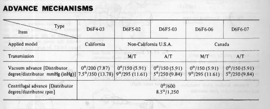

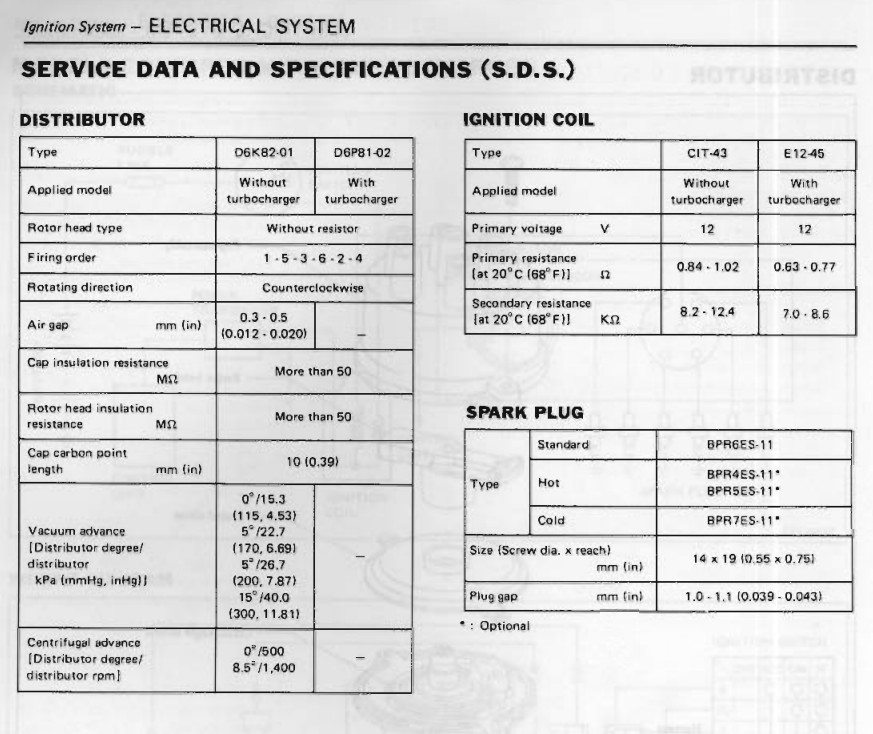

Probably not a benefit.  And the vacuum advance curve of the 83 may be different.  Looks like it has a dual stage curve, I can't remember exactly how it works.  I think it uses the high vac advance when EGR is actuated so you'd probably be on the 10 degree curve if you just use one vacuum port, as opposed to the 15 or 18 degrees of your 78.
On the other hand, that 77 distributor will work just fine with your 78 ignition module.  If the breaker plate bearings and other parts are good, it would be worth getting, for a spare.
Also, note that the 83 probably uses an E12-92 or -93 module (ID should be molded in to the module case), which takes extra wiring to work right, as opposed to the E12-80 module.
Of course, if any of the engines use a rebuilt distributor, all of this may be different.  The rebuilders don't match specs. exactly.
Stuff to think about...

Thanks. The distributor is a D6K81-01 but it appears to have a E12-92 ignition module although it is stamped only as IGM-08. It has two separate connections. I think I'm going to tackle another project and just be glad it only cost me $5 dollars and some time in the hot sun.
