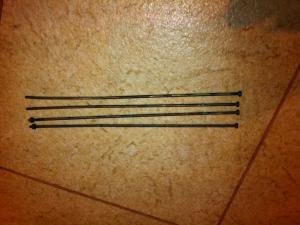

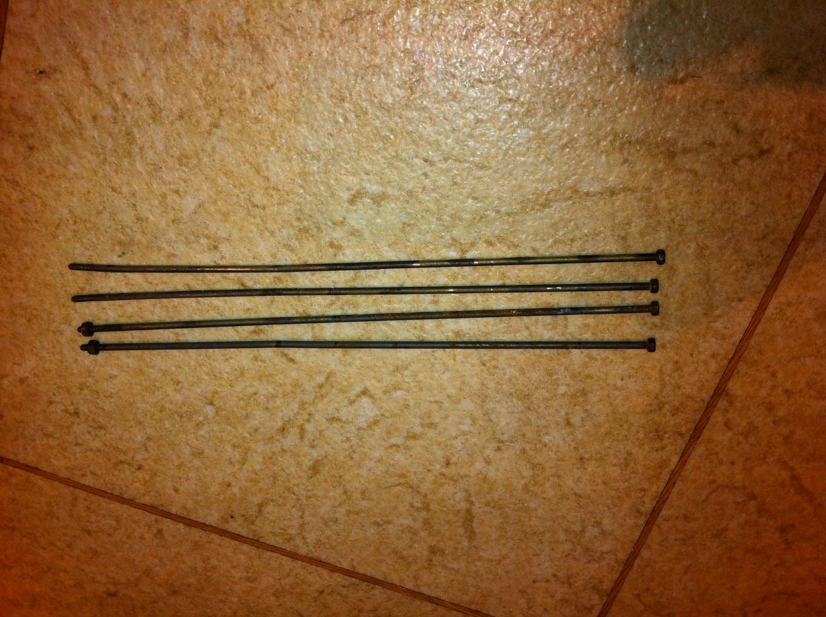

I'm in the middle off restoring the grill on the front of my 73 240z. Unfortunately I've lost the nuts off 2 of the 4 vertical rods that hold the grill together. Despite various attempts I've been unable to identify the correct thread to replace the nuts. Any chance someone knows what thread these should be?

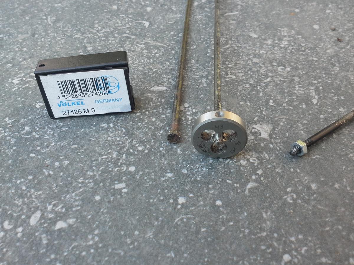

You will have trouble finding M3 x235mm bolts. I ended up buying 3mm stainless rod and welding M3.5 nuts, thats a ISO262 size and cut the thread on the other end.
M3 will work, but the M3.5 was easier to tig weld. They can take a little more heat without burning. Not all shops have them and in the states it might be harder to locate.
M3 is spanner size 5.5mm.
M3.5 is spanner size 6mm
Thanks Chas, I've got the original rods with threads intact (pic above) they're a bit scruffy with corrosion, but I was planning on cleaning them up and maybe painting them (though I do want them to look as original as possible). Thanks again for the advice.
Paul
