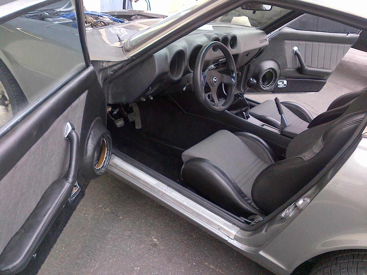

He has a 280Z and those MSA mounts are for a 240Z. The ECU is in the way on the left side. I building a 240Z turbo for a friend and the only real option was to cut the door panels and modify the door. I put them as far forward and down low as possible. The window crank needs to clear the speakers.

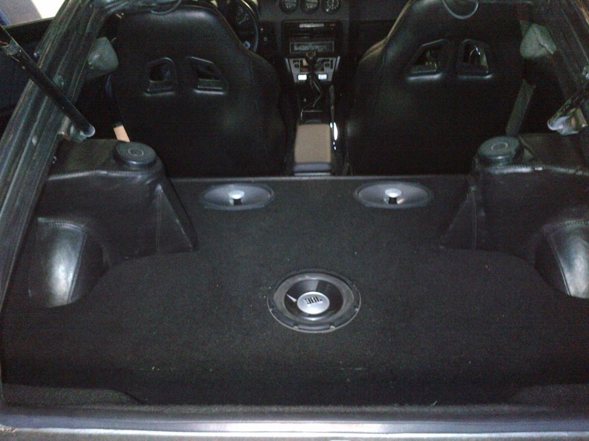

I bought some custom fiberglass door cards with built in speaker holes for my 260 which was already cut up by a previous owner.  My speaker system consists of 5-1/4" speakers in the doors, 6x9's in the toolboxes and an 8" sub in the spare tire well.  I am really picky about audio but am not quite audiophile status which is why i tried so hard to get a nice system installed, but it ended up being overkill.  From my experience my best advice is to get a pair of 6x9's behind the seats and fire them up toward the ceiling with a slightly forward tilt before cutting up your car.  The 6x9's in the toolboxes didn't require any modifications that weren't reversible: I simply removed my toolbox doors and built a wooden frame for the speakers using the toolboxes as speaker boxes.  Should i want to return to stock i only need to pull the wood out and re-mount my toolbox doors.  After all was said and done i found the front speakers werent making much of a difference in sound quality because the 6x9's were closer to my ears.  It sounds like audiophile blasphemy but try it out before cutting up your doors.
