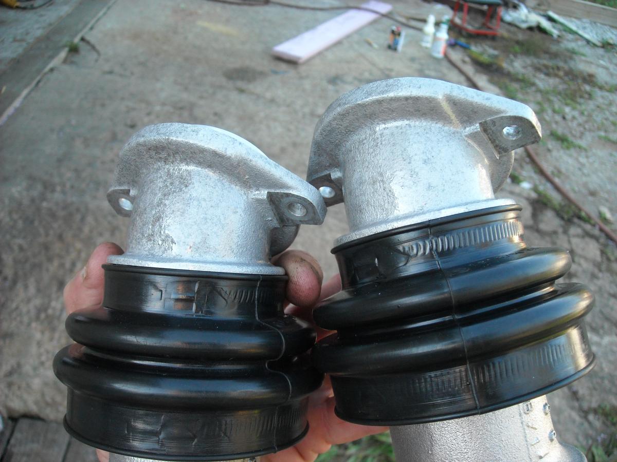

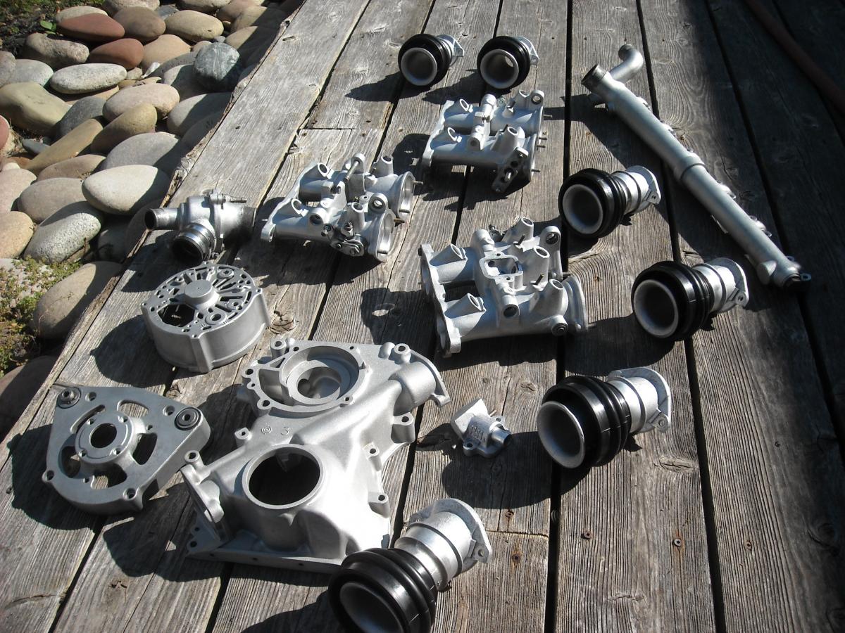

Some pics,
post-25243-0-80945500-1443264693_thumb.j
post-25243-0-84738800-1443264739_thumb.j
post-25243-0-34552900-1443264766_thumb.j
post-25243-0-00477900-1443264827_thumb.j
post-25243-0-43032000-1443264855_thumb.j
post-25243-0-38590500-1443265165_thumb.j
post-25243-0-89852400-1443265212_thumb.j
post-25243-0-22668300-1443265244_thumb.j
post-25243-0-82697300-1443265270_thumb.j

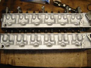

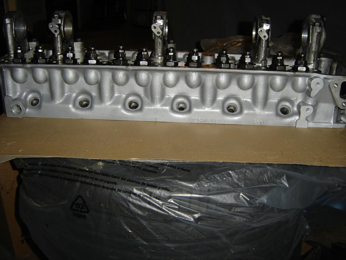

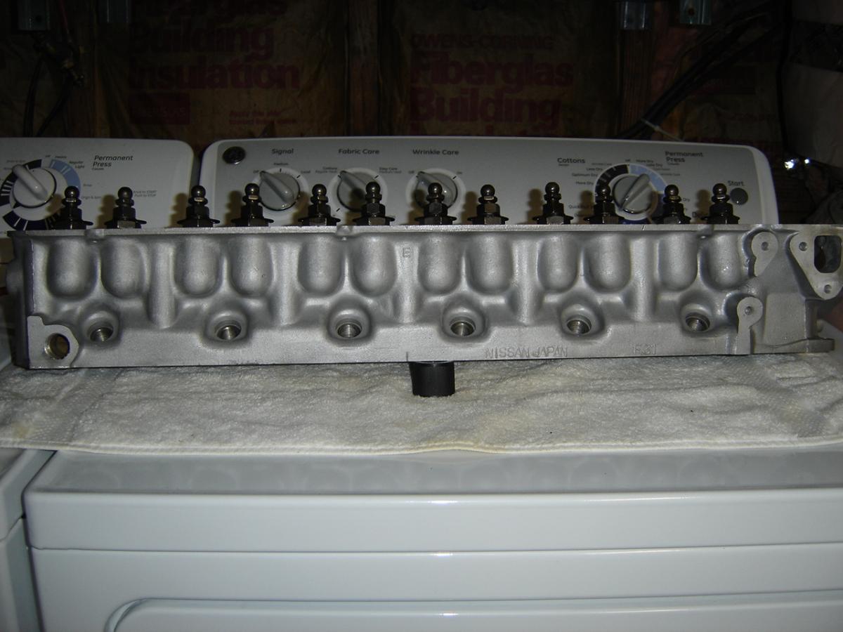

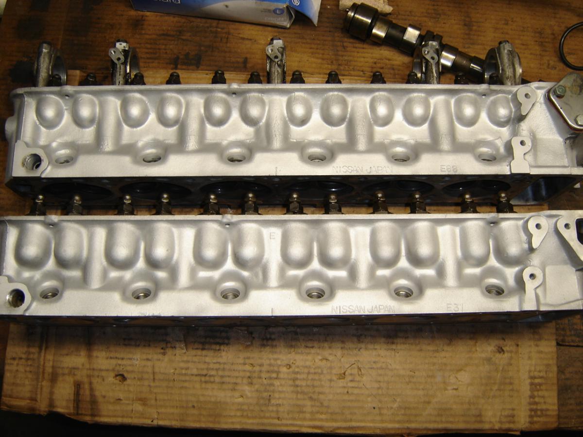

I used some stuff from Eastwood, Diamond Clear Satin.  I'm hopeful it won't yellow or peel off.  It doesn't lay on top, it soaks into the fresh aluminium I'd glass bead blasted.  It was my first attempt at sealing aluminium, I love that fresh look.  Thanks for doing this, I'll be interested in your findings.
The head on the bottom has been media blasted and sealed.  The one on top has been steam cleaned at a machine shop.
post-23570-0-81104300-1438368980_thumb.j
EDIT:
I'm pretty sure these are after the Diamond Clear, the one above was just after cleaning.
post-23570-0-77026300-1443275748_thumb.j
post-23570-0-28804000-1443275754_thumb.j
Edited by siteunseen

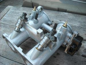

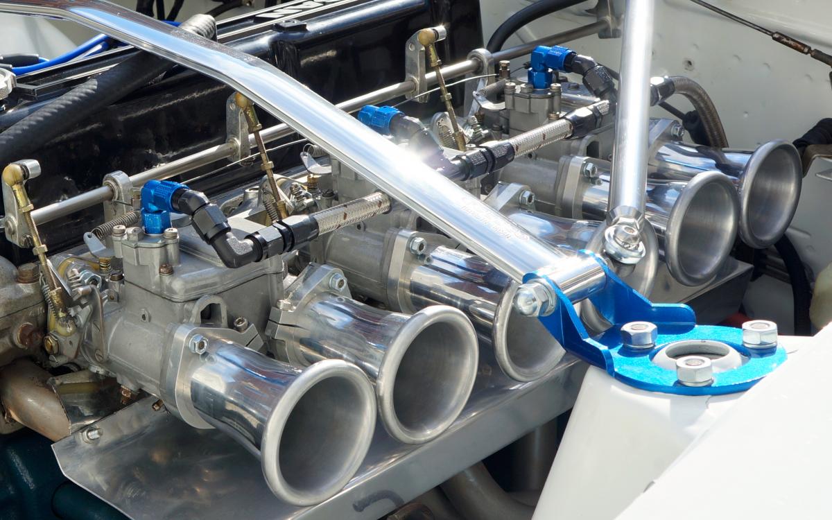

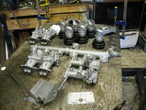

I used Glisten PC on my Mikuni carbs after I blasted them.  It's held up very well in the 6 weeks or so I have been driving the car with them on the engine, zero discolouring or flaking.  I also struggled with the brush marks though - I found it helps to lay it on as thinly as possible and build up multiple layers.
Not easy to really show it, but this pic is the best I could find of the coated carbs.
post-26646-0-46150400-1443461433_thumb.j

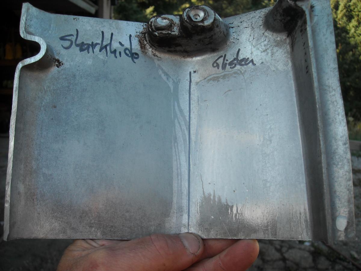

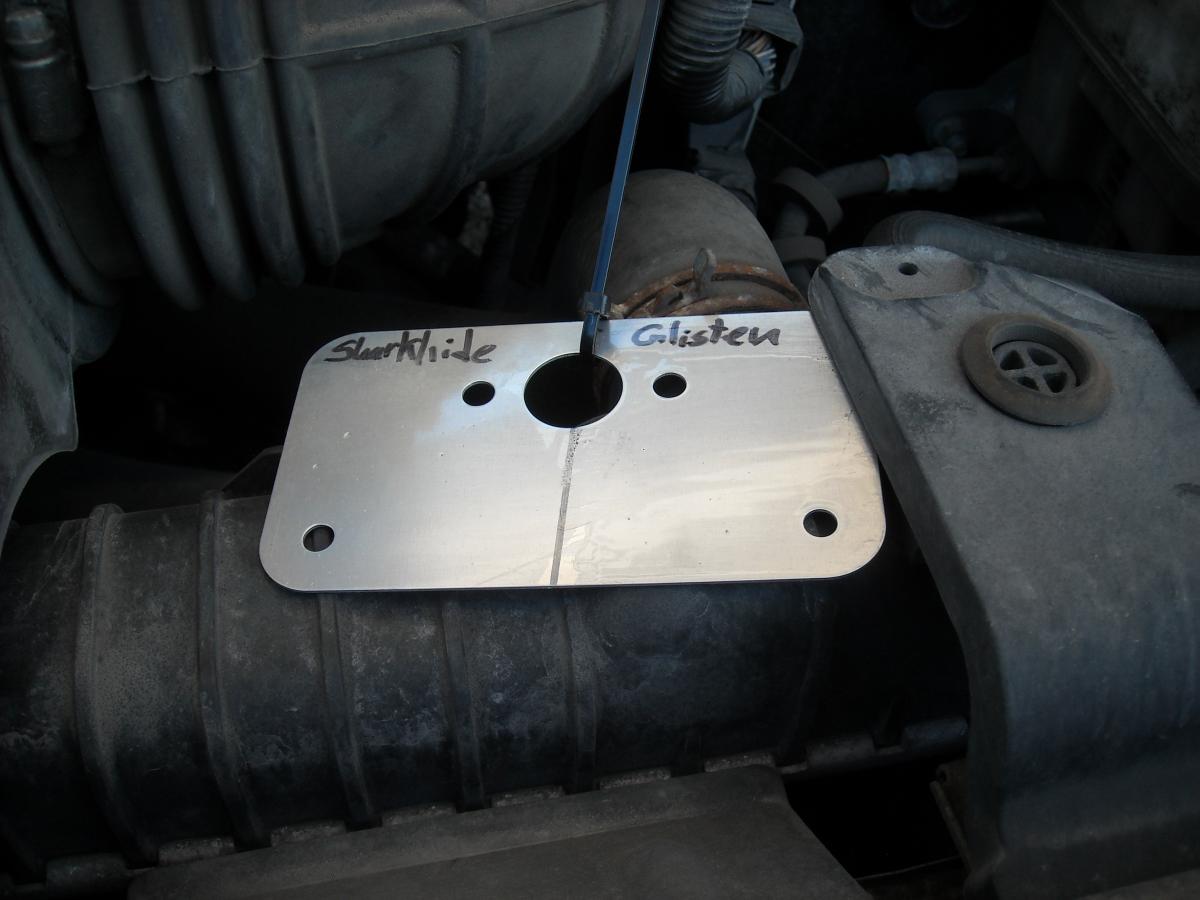

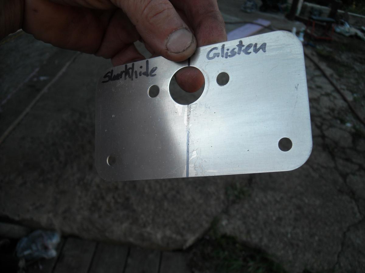

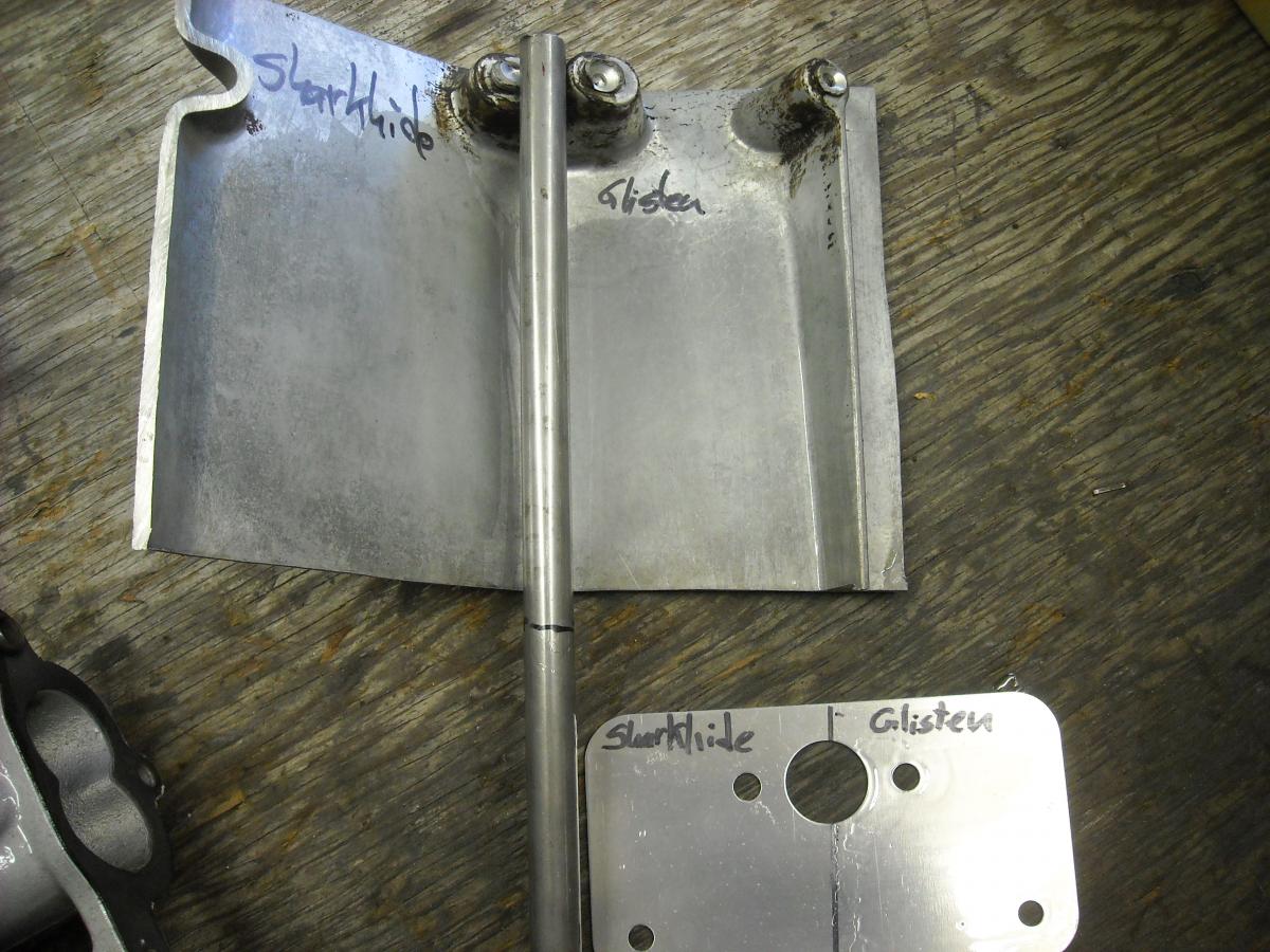

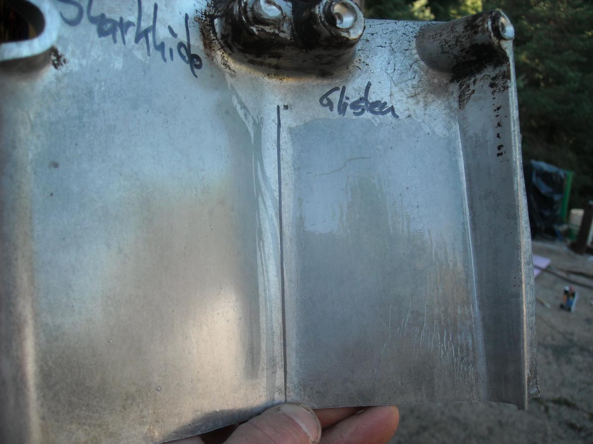

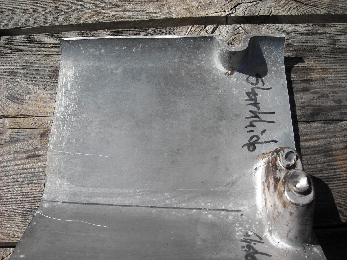

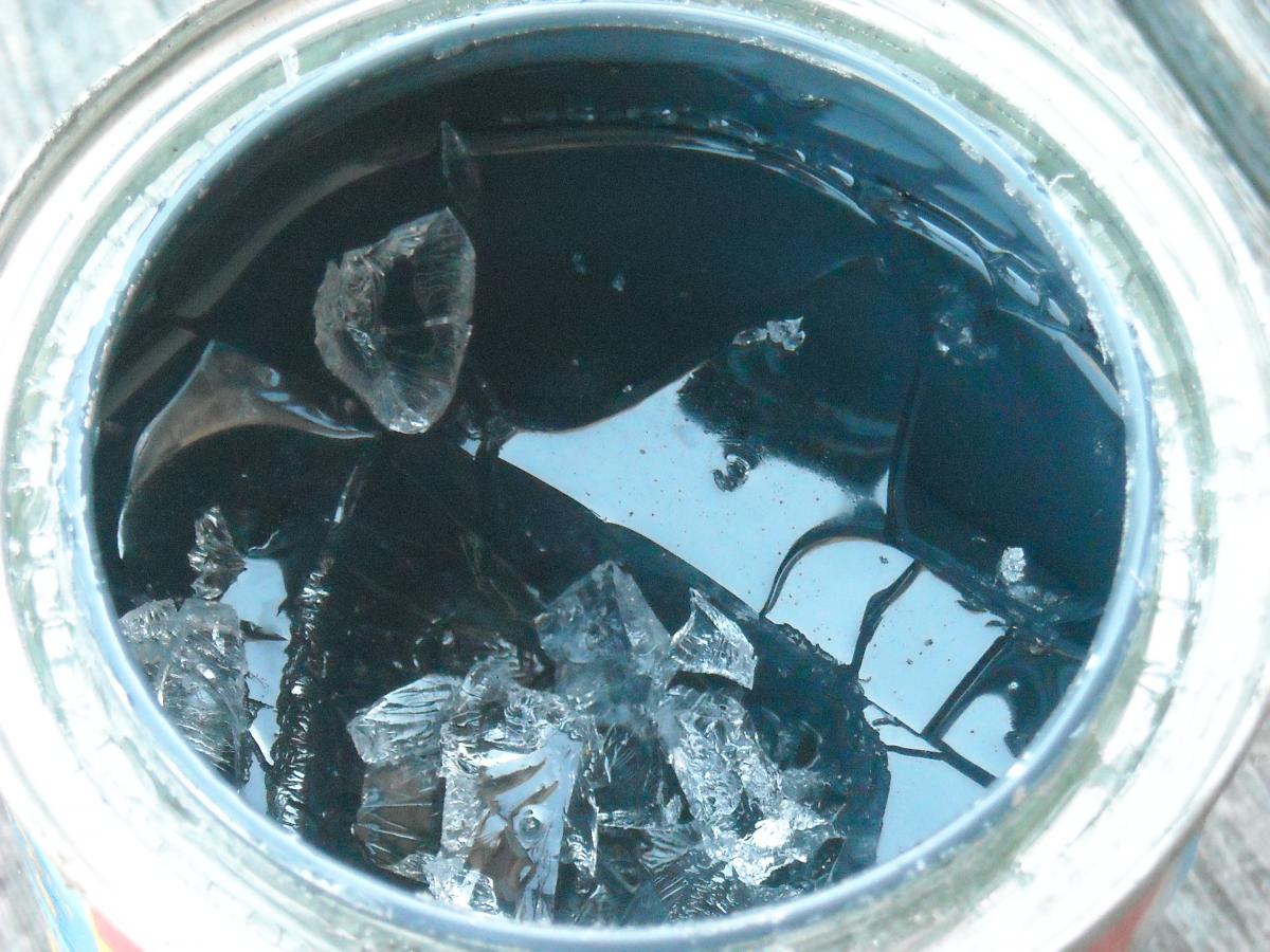

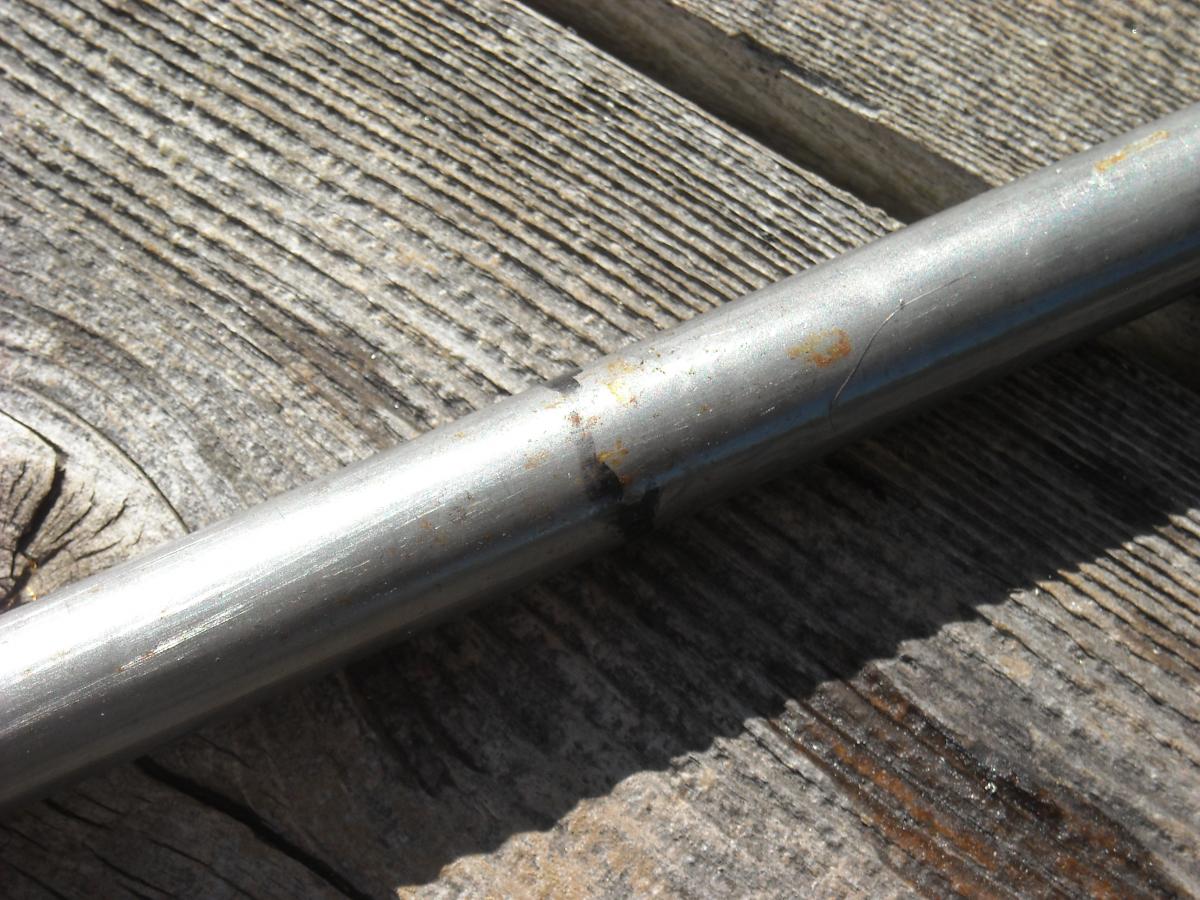

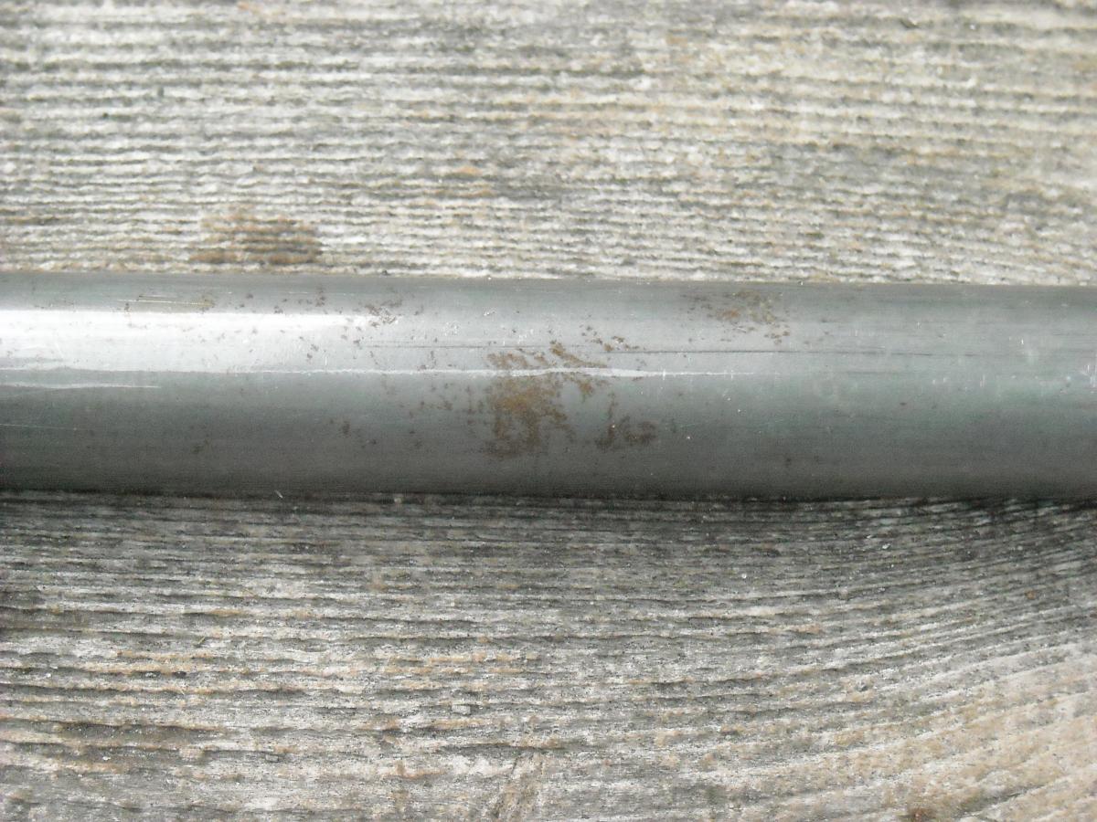

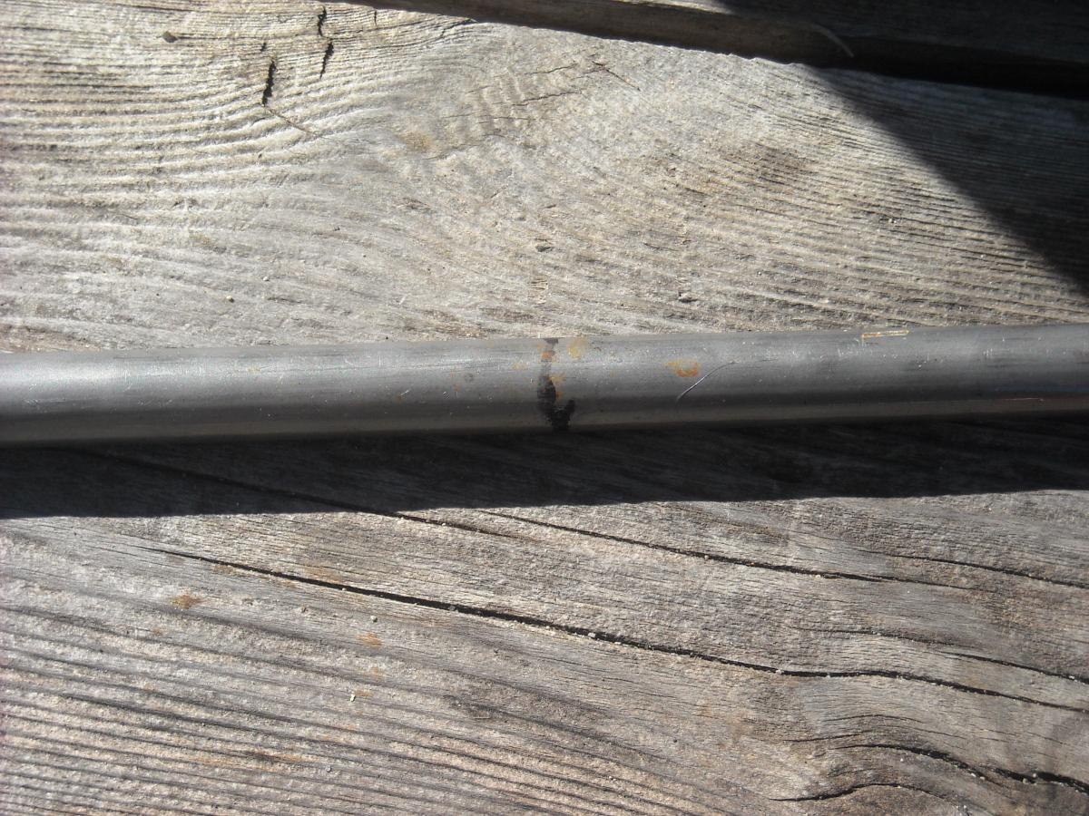

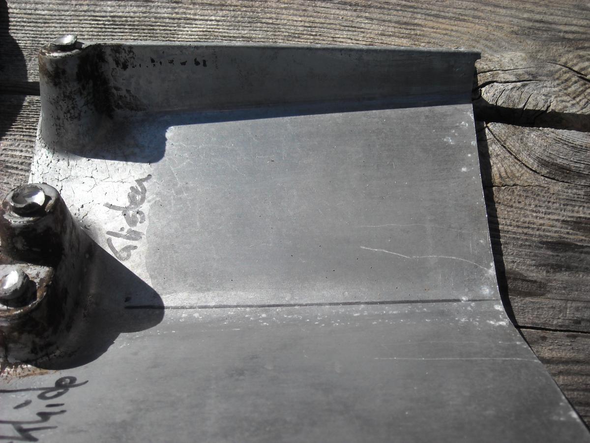

So I have had a couple of the test pieces out on the deck for the past two weeks with lots of dew and rain and some hot sun and one test piece strapped to the rad in my truck, all the aluminum pieces are doing very well, the steel rod not so good.
Maybe I didn't prep the steel well enough but there is the start of rust under both the sharkhide and Glisten coatings, mind you steel is pretty reactive.
I have started a new test piece of polished steel that was degreased, acid etched and cleaned multiple times before coating, I'll report back in a couple weeks.
Also, neither coatings show damage from battery acid and Glisten shows no damage from gasoline, unfortunately Sharkhide completely dissolves if gas is dripped on it.
However, let the gas evaporate, clean the area with soap and water and once dry apply Sharkhide again and it blends in pretty well, not perfect but most people would never notice the repair.
Chris
post-25243-0-79722600-1444592563_thumb.j
post-25243-0-72901200-1444592576_thumb.j
post-25243-0-97004800-1444592597_thumb.j
post-25243-0-40764800-1444592613_thumb.j
post-25243-0-14186000-1444592630_thumb.j
Have you ever tried the Diamond Clear from Eastwood? I'm in the middle of sandblasting parts and love the look of fresh aluminum. I hope I'm not wasting my time. It looks good on my bench but I don't know about real world results with the heat.
It does penetrate fresh aluminum and doesn't lay on top so I'm hoping it won't peel or flake. Turning yellow is my biggest concern.
