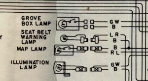

I looked at the wiring diagram for the 74. I do believe you're right that I may have a problem. The dash harness splice that goes off to the parking lights appears to be downstream of the dash lights.
I did notice this one little oddity when I was scanning the wiring diagram:
post-4648-0-23127100-1443455484_thumb.jp
Well, the Janglish is what I noticed today. Another interesting thing is that the lamp in the glove box is powered off the dash light circuit. I discovered that a couple of months back when I put an LED bulb in the glove box lamp socket.
Hahaha!!! Nice Janglish! I'd not noticed that before. Thanks for pointing that out. Reminds me of something I often see at my local Asian supermarket... They sell "Beef For Stir Fly". I've been tempted to bring it to their attention, but don't want to accidently risk an incident.
Yeah, unless that four wire PWM does just tie the two positives together for ease of wiring, grafting that thing into the Z wiring would be a pain. You still need the green/white to go to the parking lights, but want to separate it from just the dimmed lights while leaving the un-dimmed ones alone. Let's hope it's just a tie point for ease of wiring.
