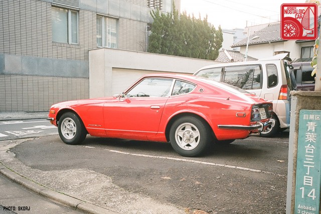

With stock corner valances, 225/50 x16's will catch on the back edge of the Valance when turned. ( Wider tire and wheel than stock ) With most Airdam's they do not because of the re-profiling in that area. .

Stock 1978 280Z. 225/50 x16's will catch back of Valance edge on 16 x 7" rims.
