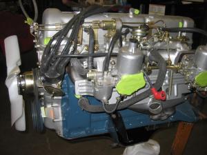

For comparison with your photo, here is a photo of my 73 240Z engine which shows the timing tab and 2 groove pulley. (taken in preparation for ZCON 2015)
post-7354-0-86972000-1444959648_thumb.jp
I think you have the wrong type timing tab for your 73. It is differently shaped from those intended for the earlier cars, and one of the tab mounting bosses in your timing cover appears to have a broken bolt. I am not sure if your pulley is original or not, but it does look somewhat different on the block side of the pulley groove.

Here's a thread from 2009 that gives a little more insight into the placement of the timing indicator plates on the 240Z.
Early cars (70/71/early 72)---right side
Later cars (late 72/73)---left side
http://www.classiczcars.com/topic/30515-timing-indicator-plate-location/
The plate you purchased is for the earlier cars, sourcing a 73 plate is not easy but they are out there.

Huge thx zup for clearing this up for me. Wasn't aware that the 73 model is different!
If I can't find the right indicator tab, I'll just put the engine on tdc using mesuring gauges and putting a new mark on the pulley according to the early tab indicator

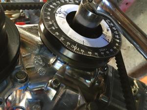

i put an aftermarket single-row pulley on my re-build. it's a smaller diameter than what was replaced, so the tab wound up an inch away and was useless. so i made my own tdc marker with a piece of sst - actually just fabbed from a section of sst hose clamp. you can print a paper degree wheel (tons available online) and tape it to your pulley, use it and a piston stop to set tdc accurately and you're good to go.
unless you're going for "all original" it's more important to simply mark tdc than it is to source the exact tab.
