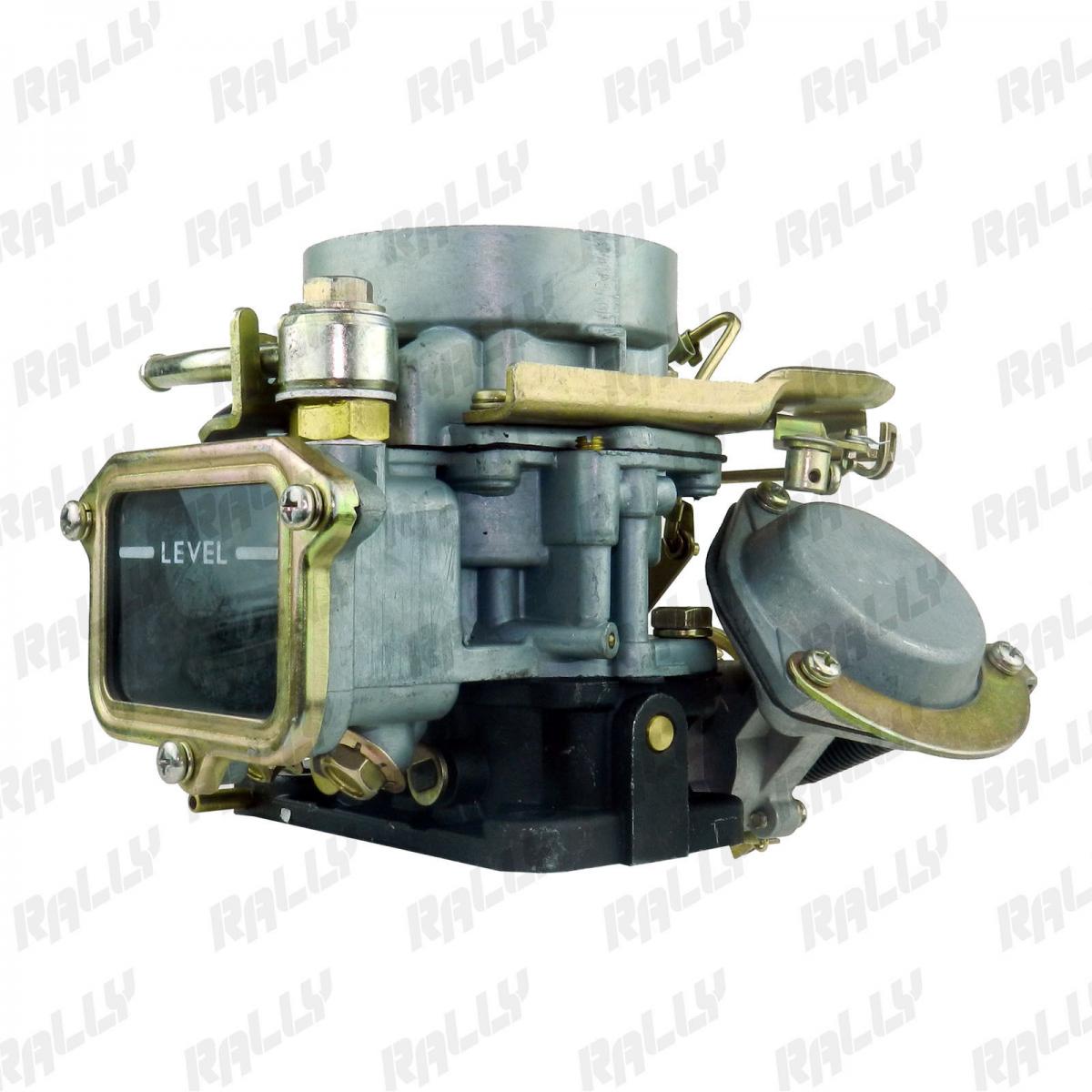

Our Datsun 510 has a glass window on the float bowl. How is the glass filter bowl any more of a hazard than a plastic filter? I would think the glass is thicker and would take a harder strike than a plastic filter. What am I missing?
