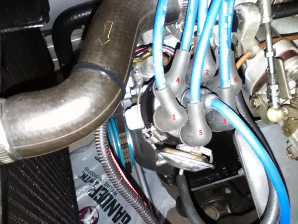

Look at my wire locations and compare to yours. My No. 1 wire is about at 9 o'clock and my No.5 wire is at 6 o'clock.
Yours wires are positioned one spot counter clockwise from mine.
Look at your rotor you have pictured at TDC. Its pointing to your No. 4 plug wire. No.1 should be there.

Yeah, as I said when I posted that pic, that was "before" I adjusted them and moved them all one post clockwise. So now mine look like yours. For some reason, they ran fine that way on the old engine.
