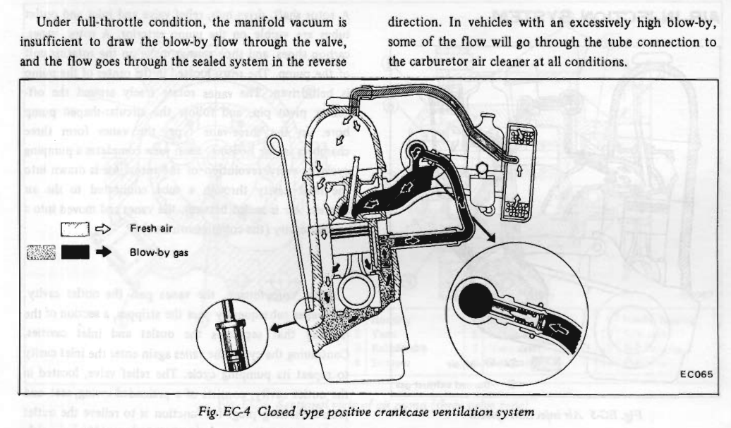

But, in all honesty, if I could easily get the old breather tube off of the L24 and get that plug out of the L28, I'd do it. I'm just don't want to screw something up.
Another question regarding this is do I remove the vac line that used to go to the crank breather and cap it off?
There's a good diagram of air/vapor flow in the Emissions chapter of the FSM's.  Might give some ideas.  Without the lower passageway you basically just end up a with a stagnant zone in the crankcase so the blowby byproducts will condense out into the oil.
But the large diameter crankcase tube connects to a fairly small PCV valve so you're not losing as much flow volume as you might think.
I respect Braap's knowledge, but in my research the delete of the pcv might have negative effects on engine operation while leaving it in has no effect on power . It's an effective emission device that could possibly prevent crankcase pressures from causing problems.
