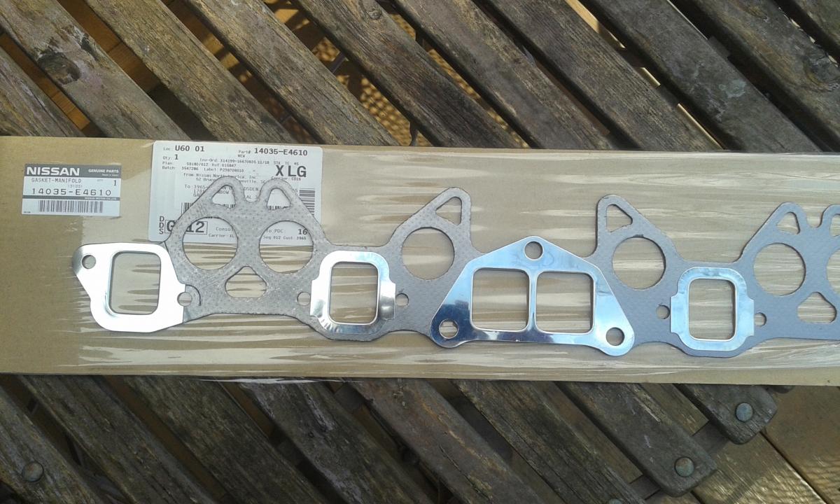

So, I was researching the header install. I have the MSA 6-1 header and got their "performance" header gasket. Its sounds like a lot of people have had problems with the MSA gasket leaking in the past? Or is that an older design? What have you guys had luck with?
