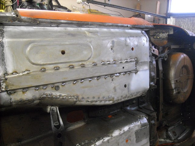

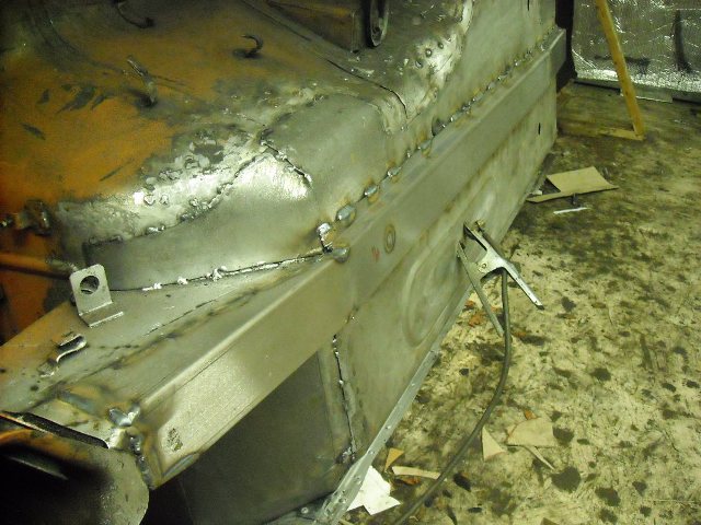

No reason that I can see, in fact I'm pretty sure I did just that then welded Baddog rails over top of the stock and then added BD's extensions so those rails tie into the rear subframe, STIFF.
first pic is Charlie's stock pans and rails, second pic is BD's over top.

Thanks for the pics. I like the looks of those BD rails as a cap.
 I'm going to extend the rail back. I may add a brace between the rear seats mounts and anchor the end of the rail there.
The sloped front section is in good shape but I'm going to reinforce it anyway. "WHILE I'M IN THERE"
