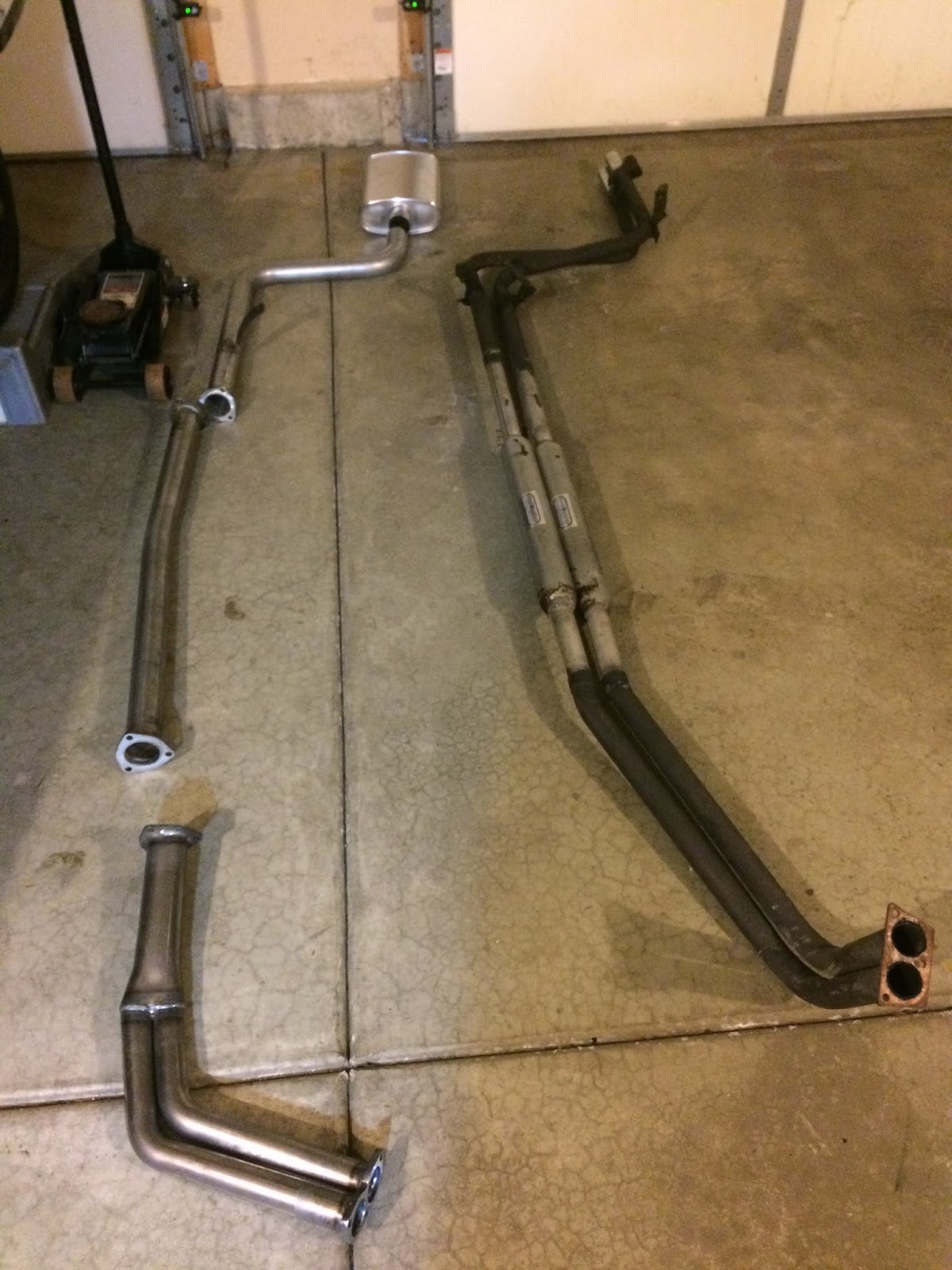

Replacing Exhaust system on my 1972 240z

I bought the complete Z store premium exhaust and their header, I'm not very happy with it.  First it didn't fit, I would say this thing was 3 inches too long to fit under the car so it sure wasn't "bolt on".  After trimming and fighting with it I got the pipes close enough to mostly fit under the car but its still not quite right.  The engine drone is horrendous and im young enough to still really like some loud exhaust.  On the high end the pipes sound great but I plan on driving this car.  In the end ill end up taking it to an exhaust shop anyway to get rid of the droning sound and fix the fitment
Do you have an audio of this? i wouldnt like to spend US$300 in something that first of all does not fit nice under the car and second is so loud i wont be able to listen to the radio. I use to have the twice pipe exhaust and it was quite annoying!
I really like my MSA system, 6 into 1 header then 2.5.  I enjoyed the loudness for a year or so but then I started driving it to work and having to leave out early in the mornings I was a little embarrassed.  I had a muffler shop put a resonator in and am happy as ever with the sound.  Cost $45. :)
How was the fit for your guys?  No joke my system was so long the muffler wouldnt clear the rear body of the car until i trimmed a few inches off the pipe and re-flared the muffler slip on area.  Even now its probably an inch or two too long but i convinced it to go in.  I also have the MSA header so the extra length might be in that, but the complete kit didn't work for me.
