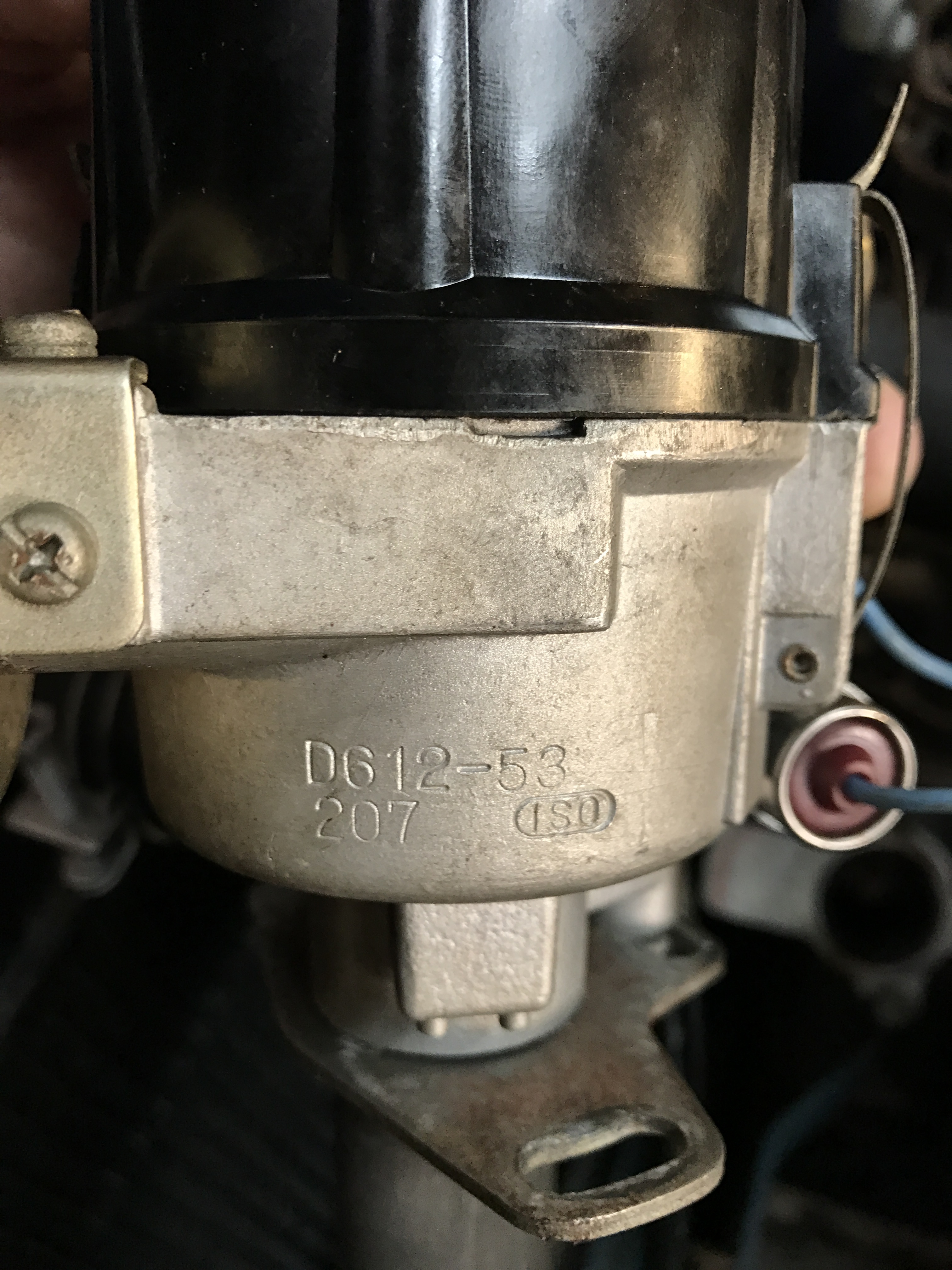

Thank you DJ,
I have never considered the distributor being different. It does have points as those are new and I adjusted the gap per the FSM. I will remove the distributor and check the number on it to confirm if it's original. Also I wish the lock plate was upside down, it isn't as the marks on the plate and the marks on the distributor match.

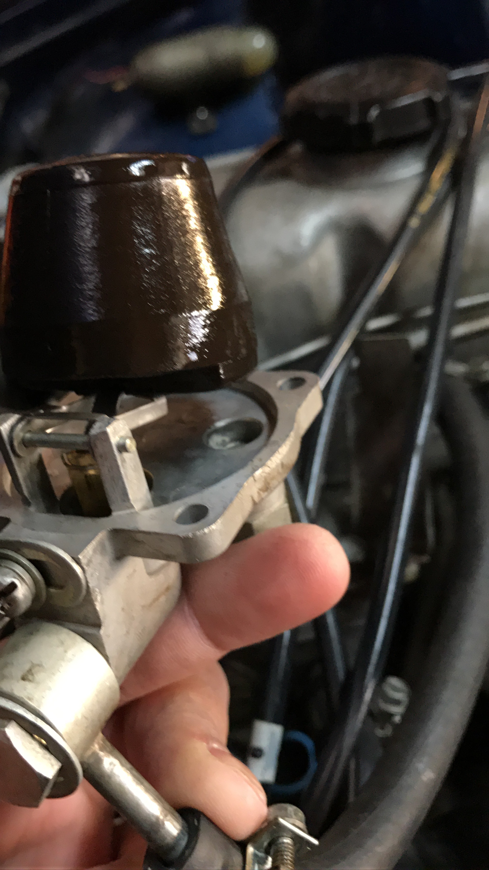

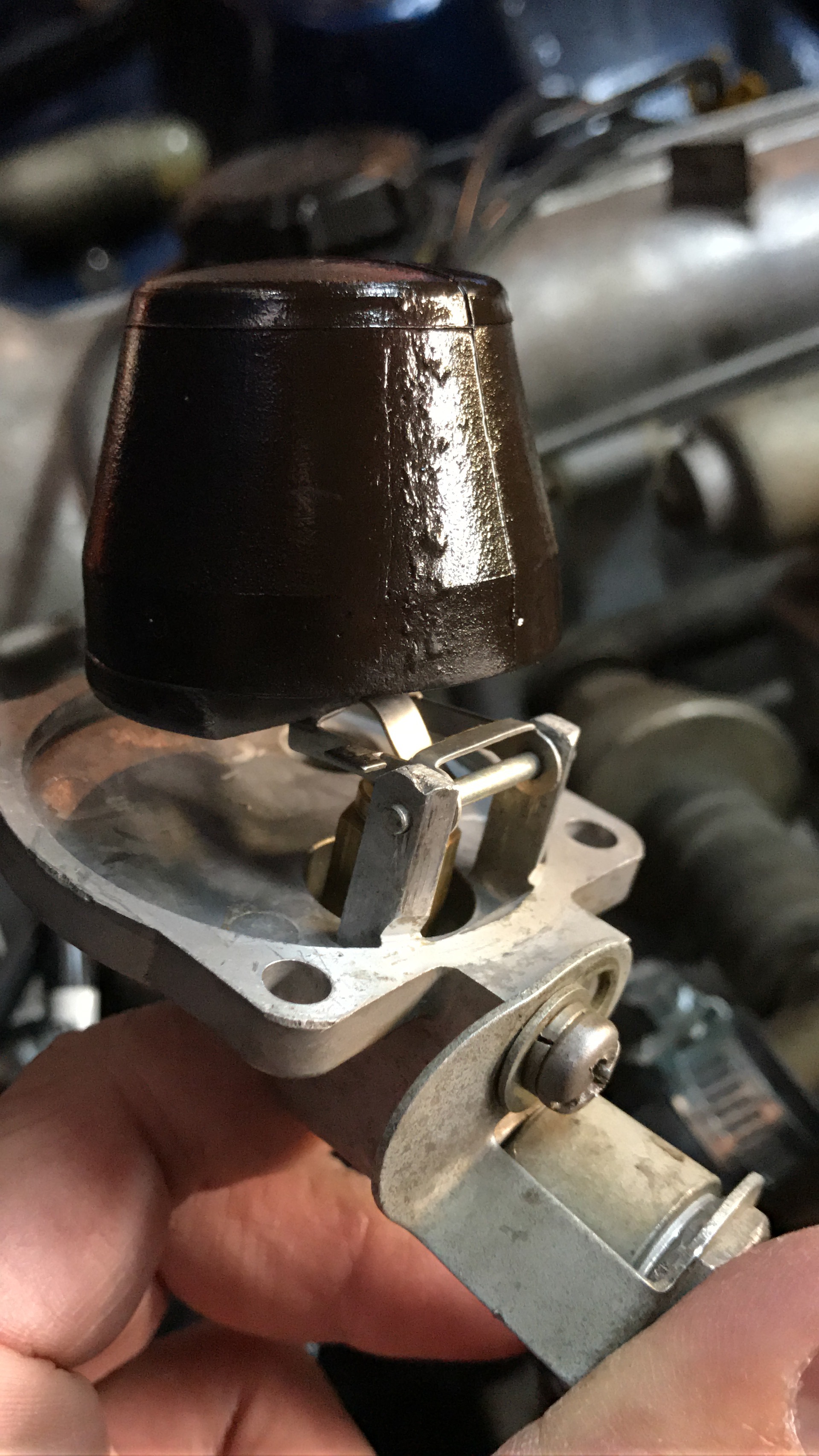

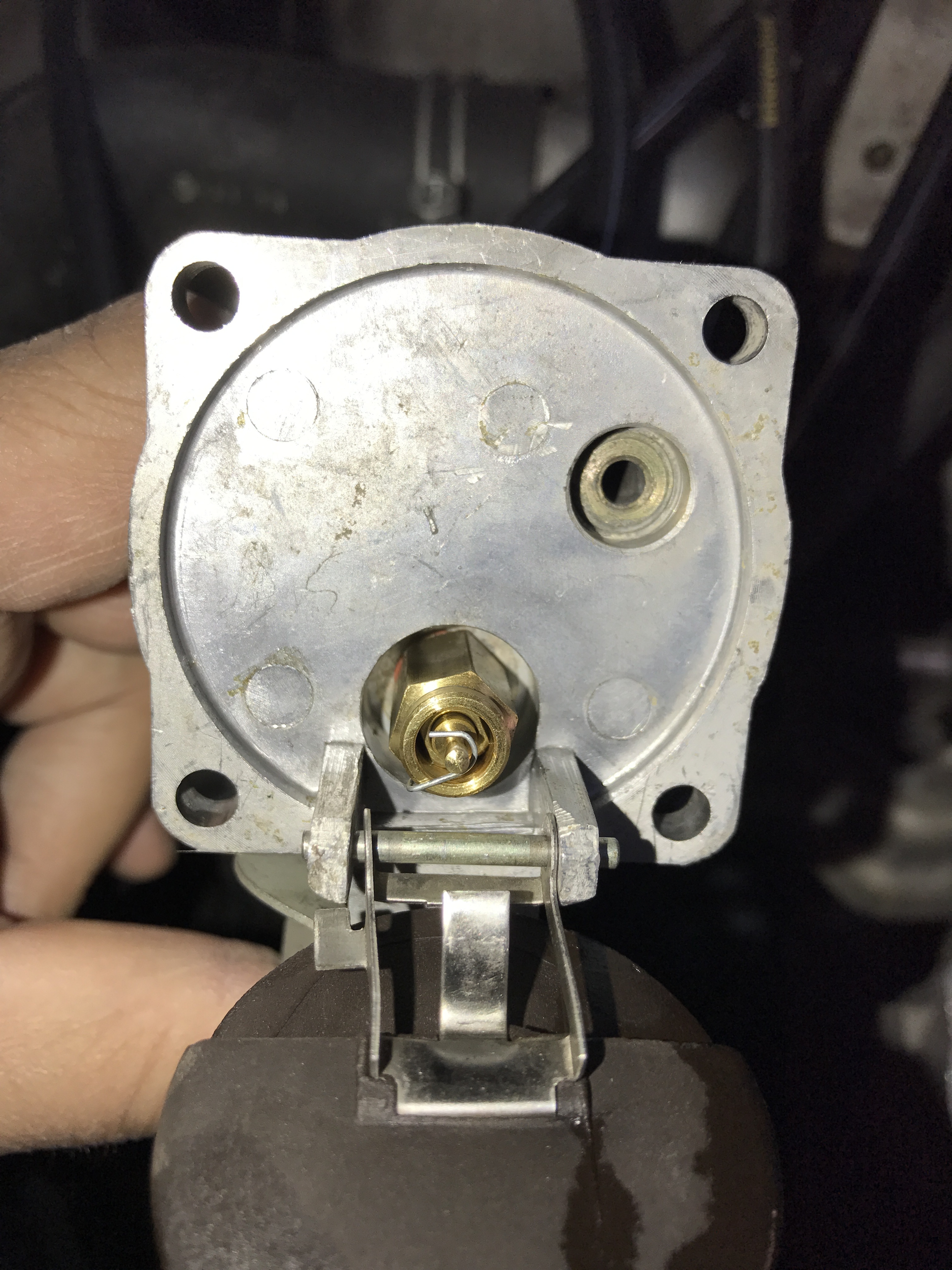

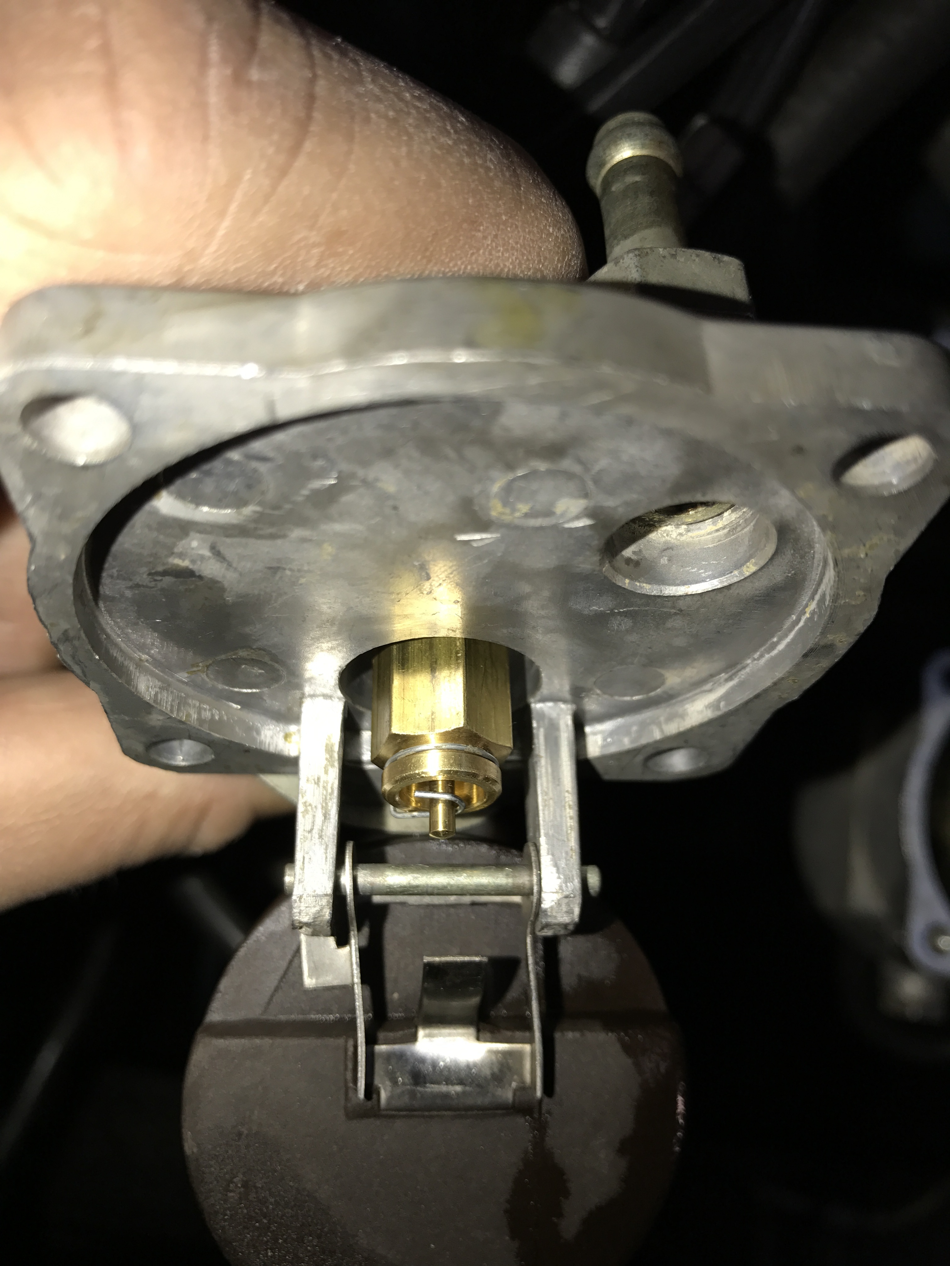

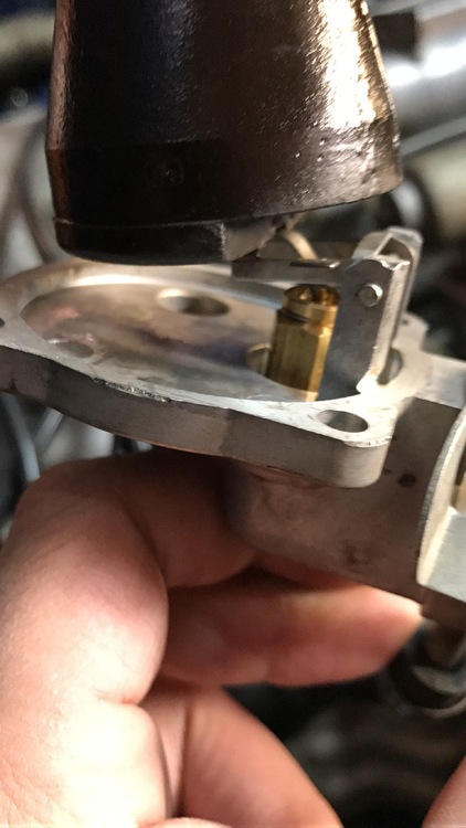

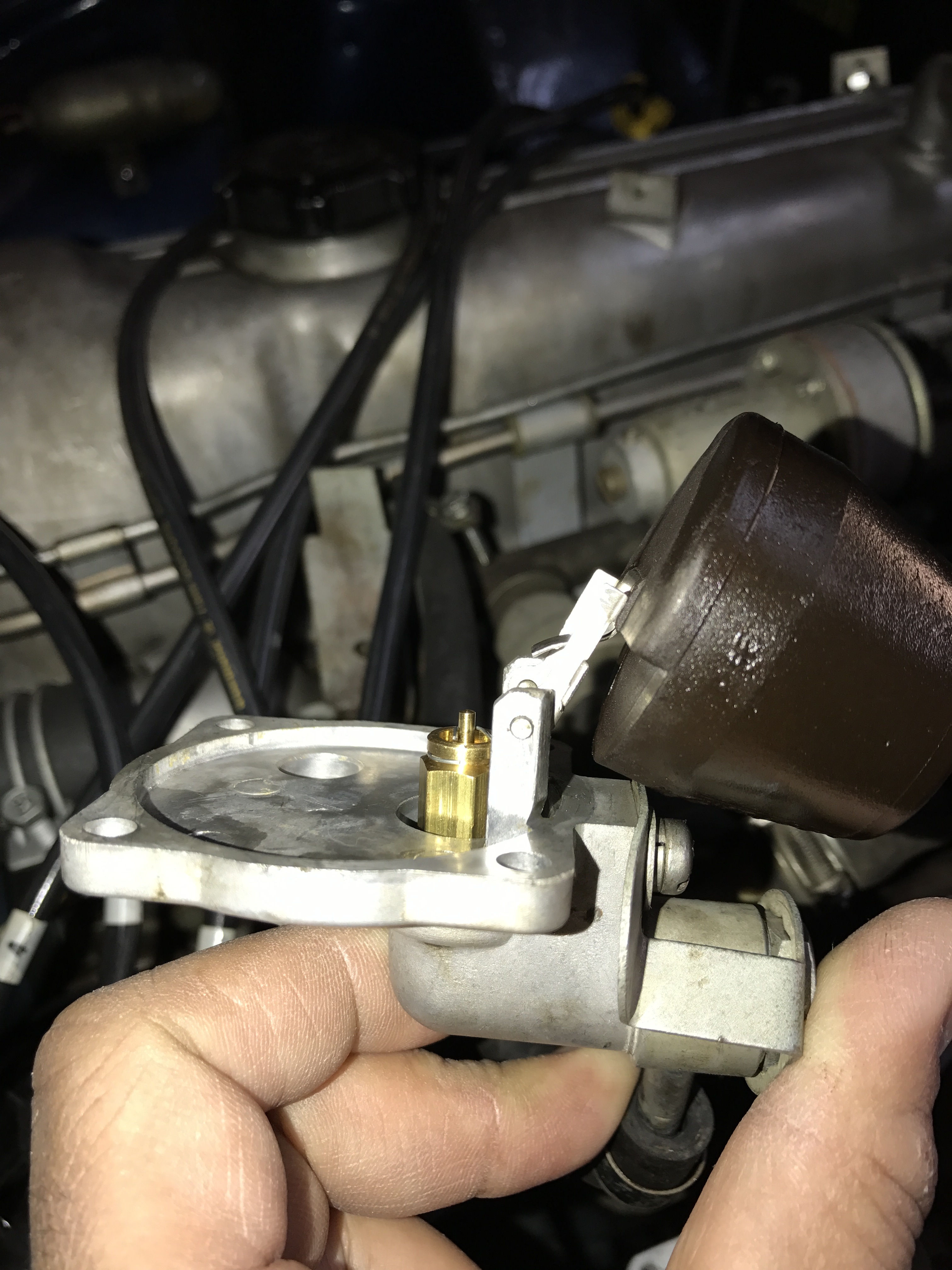

The front bowl has driven me crazy. The crazy is part that the rear carb is fine, something happens when the float is put back into the bow. Either the float gets stuck or the pin comes out on one side. ughhh so frustrating.
I don't know if this will be helpful to you in any way but it's a simple trick to test the float "floatability".  On the lid there is a vent/overflow hose connector.  You can use those little red straws that come with aerosol cans like WD-40 to stick down that connector and then it rest on the float's roof.  With that you can see if the float is moving freely.  I actually left one in and watched it raise and lower ever so slightly while I revved the motor.
There should be a small tang coming off the floats hinge that keeps the float from dropping beyond the wall of the float chamber.  It hits the mounting "legs" where the pin goes in.  If it's bent wrong it'll make getting the float back in the chamber a little tough.  You can sort of eyeball the tang the pin rides on in this picture.  Before I learned the "Just SUs DVD" had some old instructions that are no good with the valves they now sell my tangs were ramped up almost to the top of the pin holes.  They should be way down like the picture.

The WD-40 is a good idea, I can see the float when I remove the vent but wasn't sure if it was moving. I wish I had a tiny camera to put in that hole to see what's going on.
I believe my front float/ plate doesn't have the tongs to stop the float from going all the way back. When I remove the float/plate the float just swings all the way back and then get's stuck, I have to then push it forward. I don't think this is an issue inside the bowl because the float will never swing that far back. Another thing that might be an issue is the pin holding the float, it is very loose. Is it possible that this pin can move back and fourth causing one end of the float to come down?

If the float pin holes are that wallard out I would buy new floats or bigger pins.  Seems like you might could squeeze the hinge together or apart to tighten them up?  If it's the OE distributor this post about worn springs inside make a lot of sense to me.

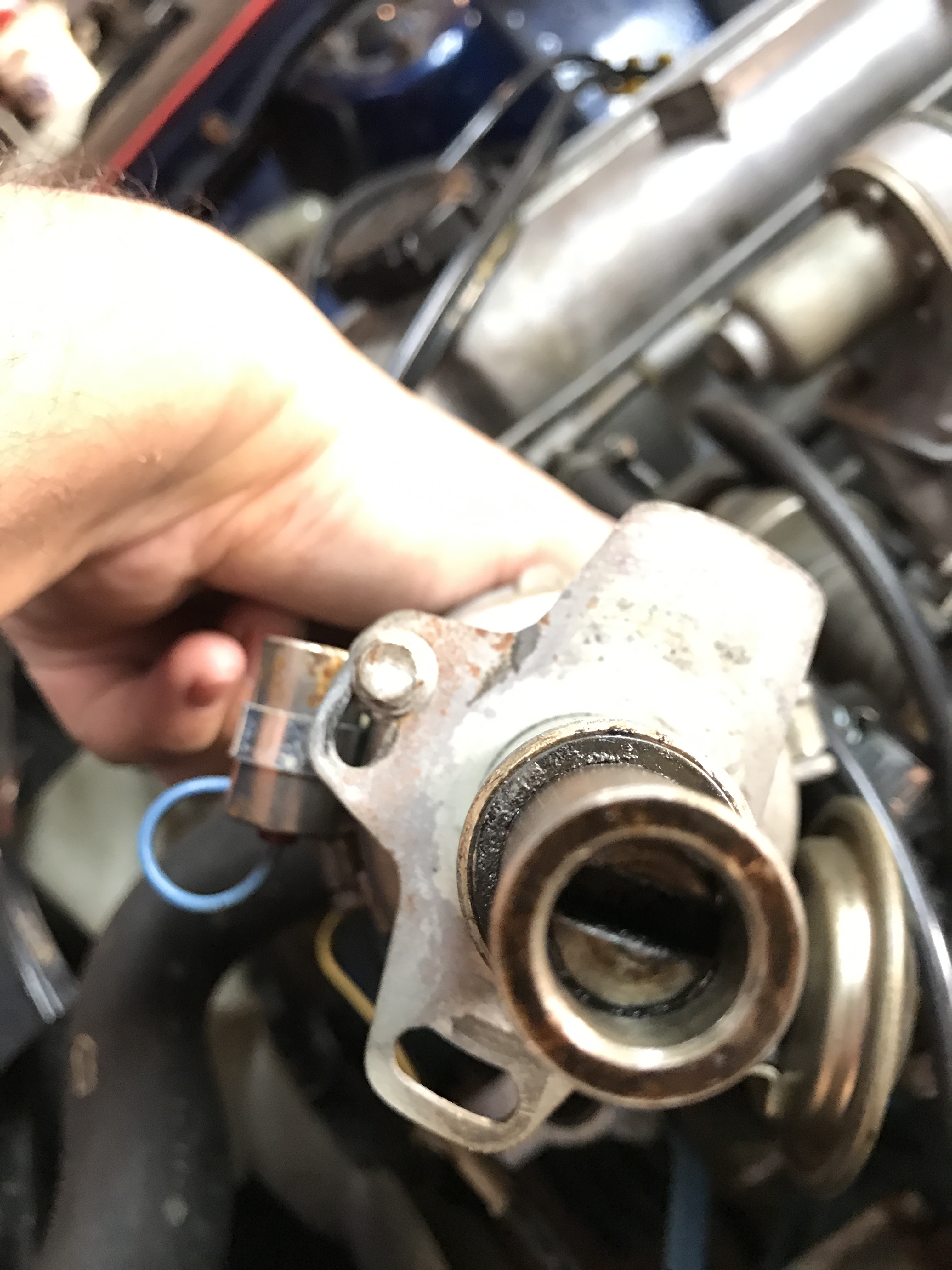

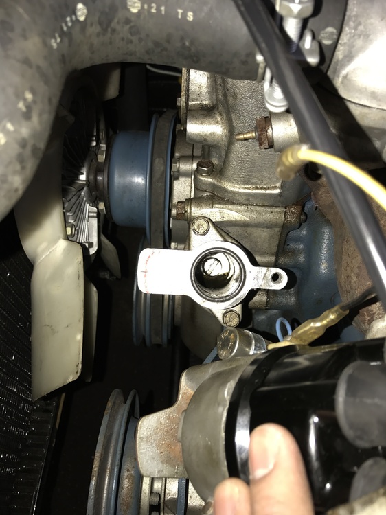

Ok here's some photos. The car is running on its own without any throttle help but the same situation with the distributor. I did notice the small adjustment was fully to one side, so I put that back in the middle. I tried the timing light when it was running and I couldn't get it to 10 degrees but more like 16. This is the only time it would flash, it wouldn't flash at 10 degrees

The distributor is a D612-53 didn't see this in the 72 FSM. My build date is 6/72.
