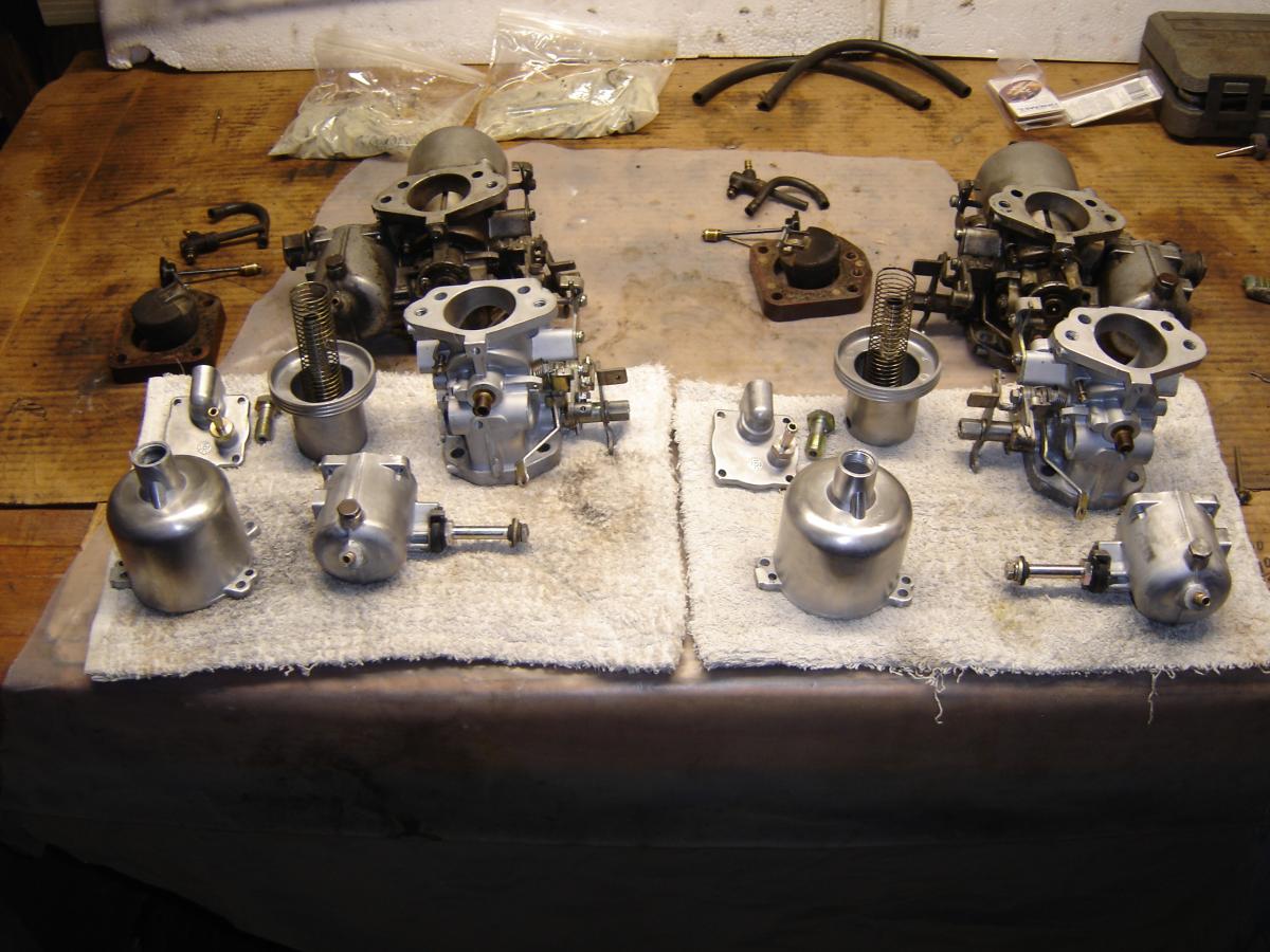

I have my carbs and intake screwed to the wall above my work bench.  I am going to set the levels the best I can before putting them on the car.  I need all the information I can get.  :D
Thanks everyone for the advice. I ordered a japanese kit from zcardepot. I should have ordered the dvd from Ztherapy but was in a rush.
I do have a few questions. What is the procedure to temove each carb from the thottle, how do I separate the float bowl from the main carb body and how do I adjust the linkages?
Thanks!
There's tons of stuff on youtube.com about SUs.  They really are simple.
Take the 8 nuts off the intake studs, 4 per carb, and the whole assembly will slide right off.  The only connections are the fuel lines and the vacuum advance tube on the front carb.
Take a bunch of pictures as you disassemble them.  Two separate piles, they are the same but opposite like looking in a mirror.  :)
