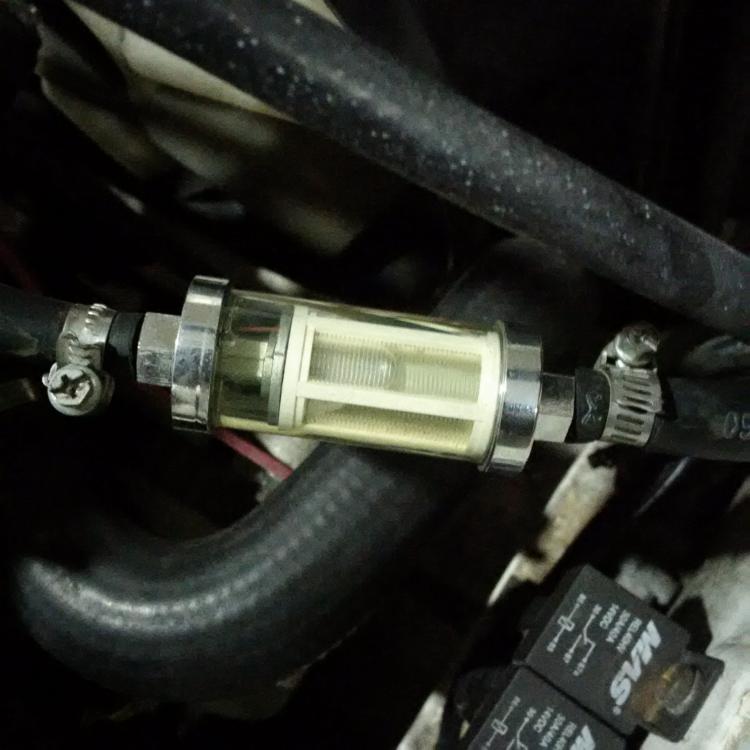

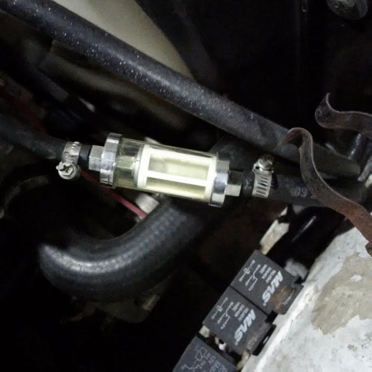

George : Get rid of that glass inline fuel filter ( Mr Gasket? ) They are terribly restrictive. There is a thread on these horrible things elsewhere.
They cause a big pressure drop and that can actually cause Vapor lock in hot weather. They act like an AC orifice valve.
Go back to the stock Nissan filter or put in a REAL high performance fuel filter. I've used a Fram HPG-1 on many race and street cars: You can run some Neoprene fuel lines from the HPG-1 and get rid of the steel tubing. That is one of the solutions covered. Or you could even put in proper AN style braided hose. That would be my choice. Summit ot Jeg's would be my vendor of choice for AN fittings. .

Thanks for all the wonderfull pieces of advice. My car was running nice the other day but i had to leave it at the shop for master cylinder and brake booster swap. Anyway, i just picked it up and driving it home the car he car had lost power and was backfiring at the intake. Mechanic said he did not touch the fuel mixture in any of the carbs as it had nothing to do with the brake system. I guess he could have left the airtex 8012s electric pump running at accesory. Even though the fuel filter is full as shown could the electric pump have damaged?
http://www.summitracing.com/int/parts/atx-e8012s/overview/
Are these pumps so frágile that if you leave them on for more than 30 seconds without turning the engine on they could damage immediately?? this will be the third pump i buy. This one lasted 6 months.
Do you recommend buying the same pump again and additional plastic fuel filter ro place besides the pump near the gas tank?
