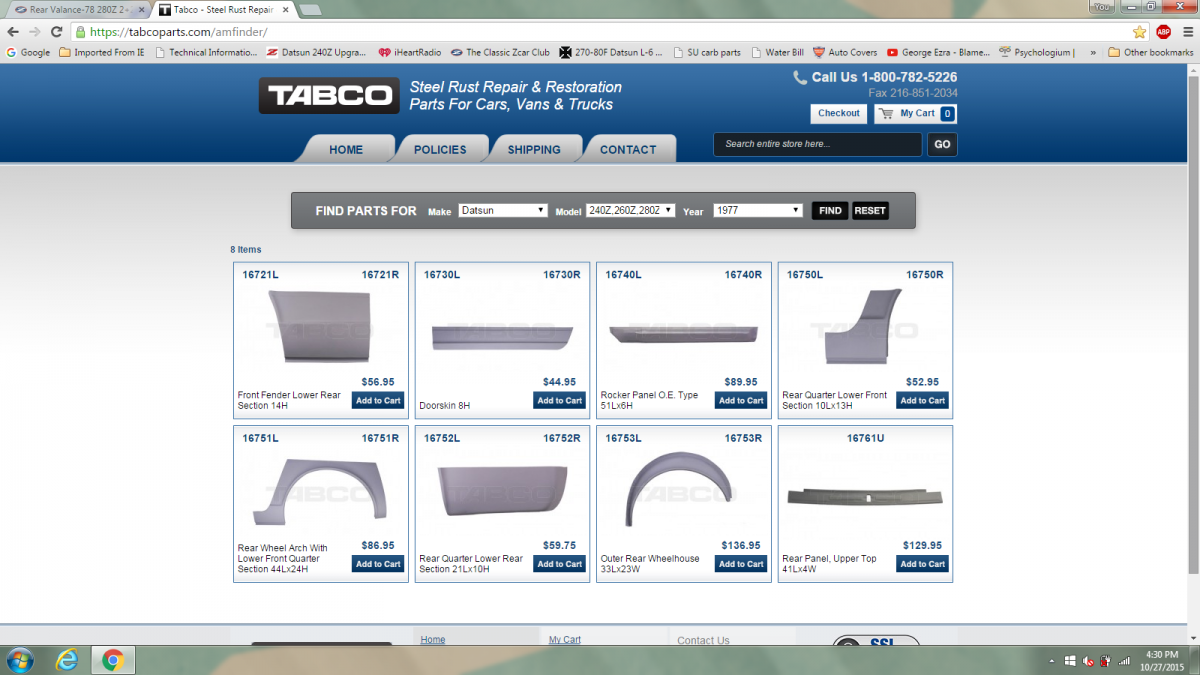

I just replaced my rear valence from here, http://www.datsunzparts.com/products.html.  Good product and a great guy to deal with.
Thanks for the info. The more I take apart on this project the more rust I am finding. Zedd looks like a great source for some of the stuff I will be needing. I would rather replace the needed panels myself and know they are new and done and rustproofed rather than buying a "RUST FREE" used Z. Reading and studying on these great cars, I do not believe a "RUST FREE" Z has ever been produced. Looking forward to the resurrection project. I will definitely need to brush up on my welding skills. Thanks again, John-Lugoff, SC
