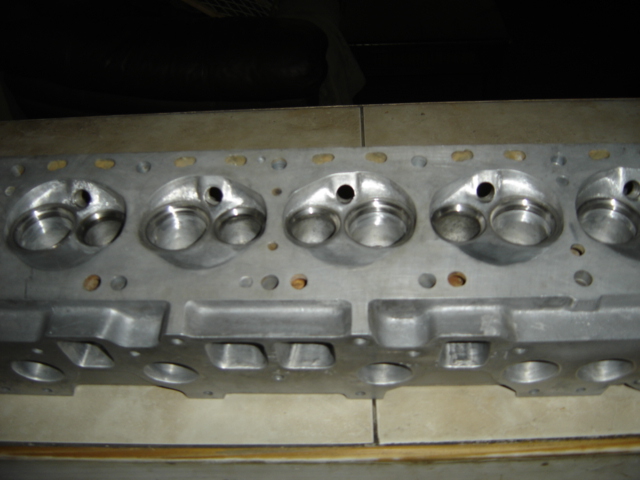

Does anyone else think that those hone cuts look awfully big? I think if it were me, I'd have another machine shop do another hone cut.....wouldn't cost much....good insurance. BTW, I think you can still get Nissan 73 Pistons at your local dealer. The flat top without reliefs are NLA........and I also believe if I remember correctly, ITM pistons come fly cut for the L24 motors. SB.....can you look and see if the Pistons that came out are ITM or Nissan? And Siteunseen....can you take a pic of the chambers in that E88? Just curious. Love your dog....looks as crazy as my pooch;)

Guy I'll get those photos ASAP.

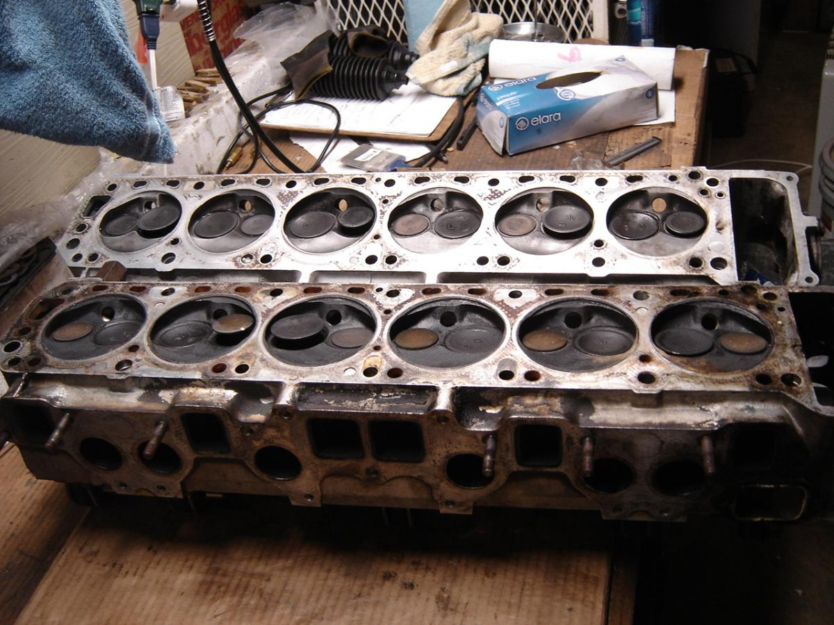

Here's those pics.  I hope they make sense @Diseazd @madkaw
The later E88 has a straighter edge on the plug mound towards the intake valve, the best I can tell, it's the top one in this photo and has been shaved .040" by a machine shop, the dirty one is untouched early E88 with a bigger plug mound reducing the overall volume of the combustion chamber.
Here are the stamps.  Later version has the sloppy looking E88, it's the cleaner one on top.  Notice how close the "NISSAN JAPAN" is after being cut by the machine shop compared to the lower dirty one.
My E31.  Notice there is no overhanging material above the plug mounds like the E88 have.  I didn't grind that off, I think that is why the E31 has a higher CR than the E88s.

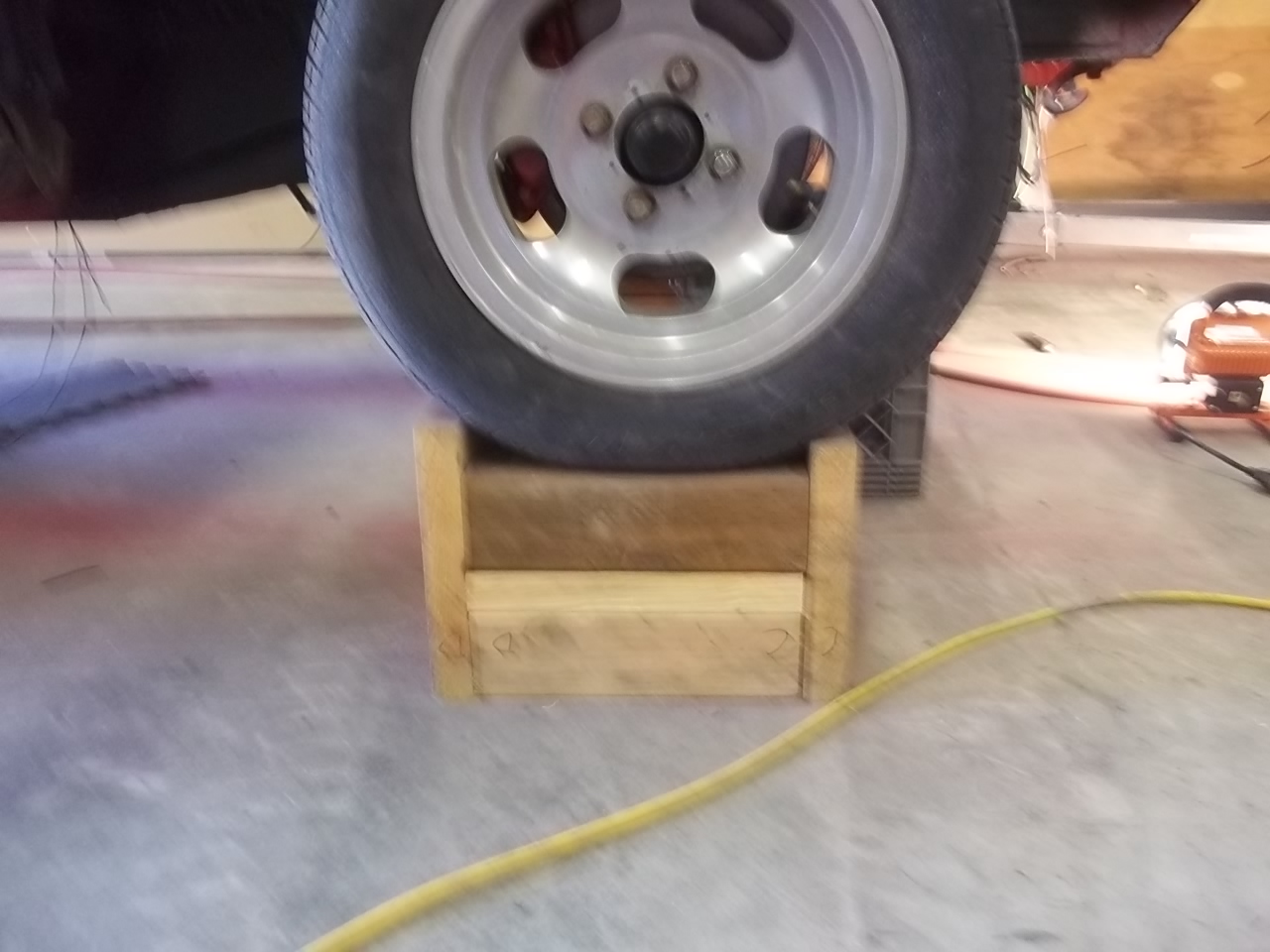

Please tell me there is a least jack stands on the front of your car and the parking brake is on, I can't even look at the pic without cringing. Sorry, it's none of my business.
