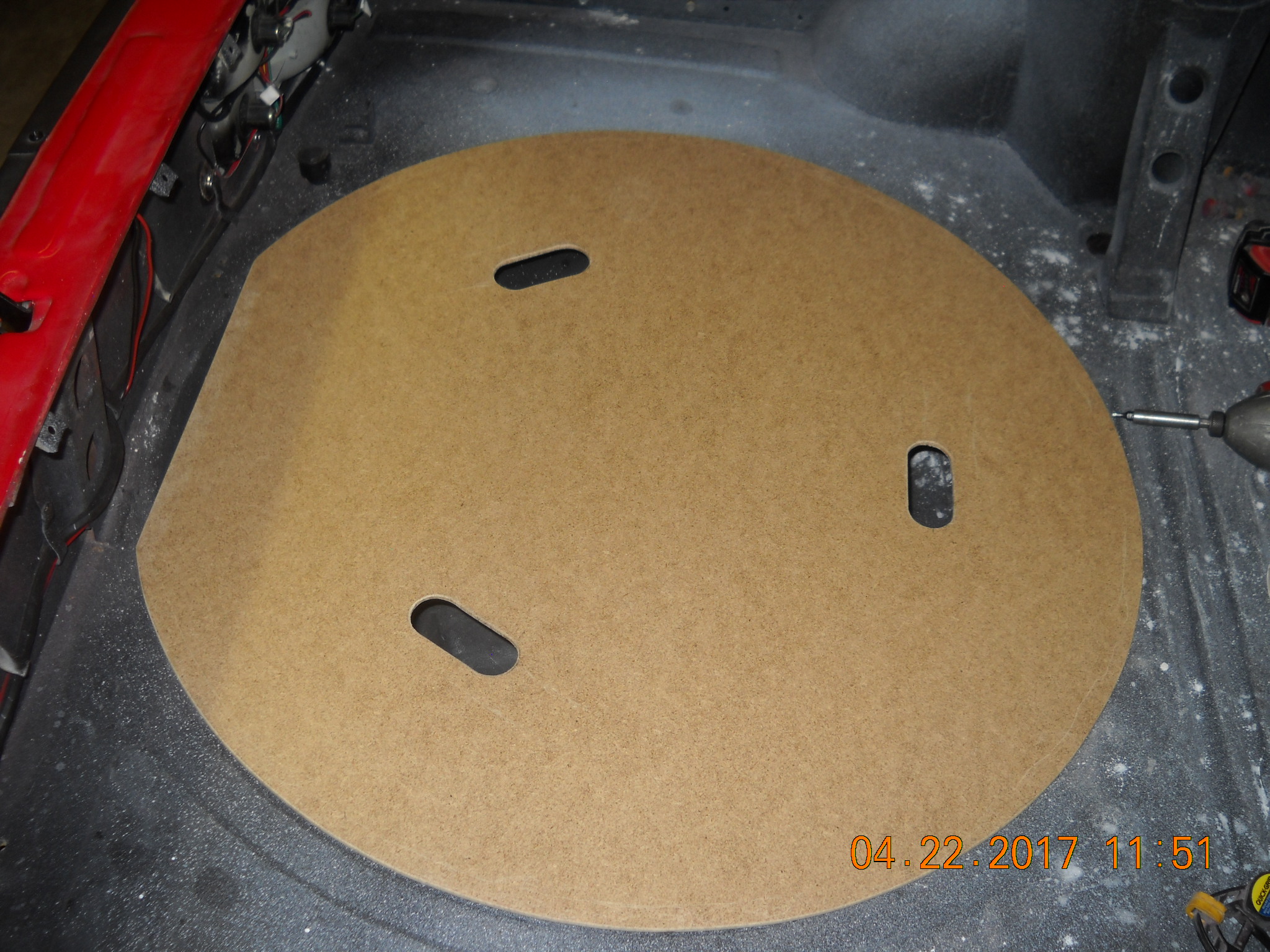

23 hours ago, sweatybetty said:
new cover for the spare tire. 1/4" masonite (tempered hardboard) from slum-depot. about $13 for a 4x8' sheet.
