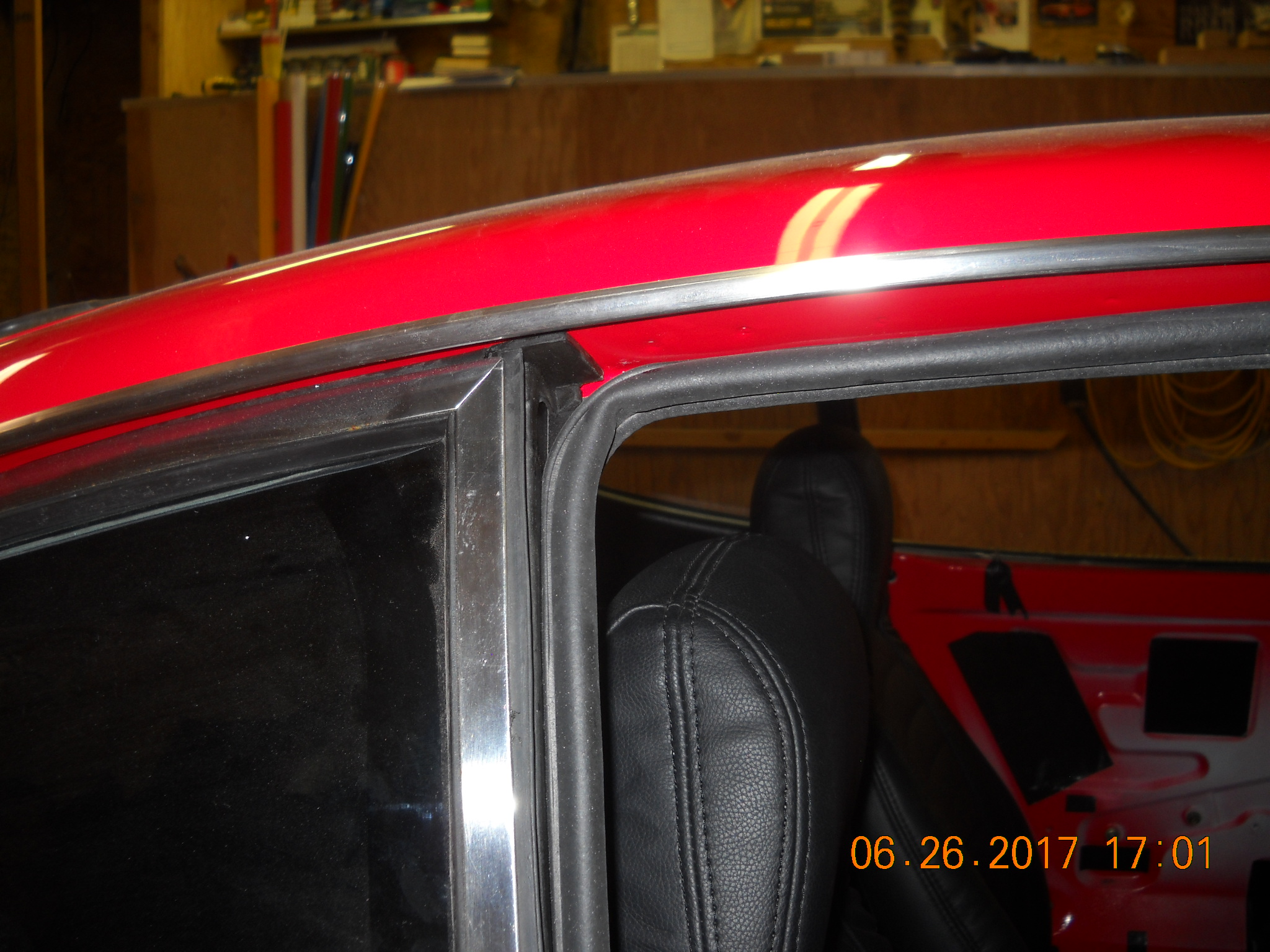

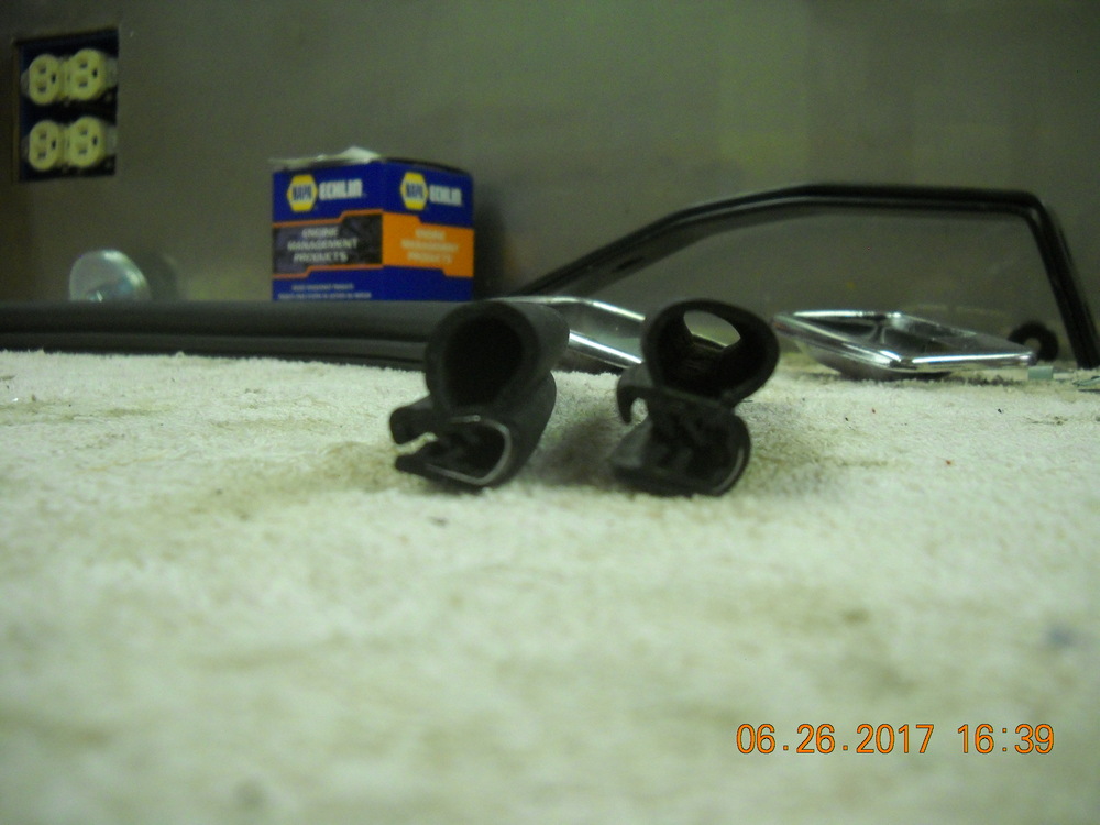

new door seals that i bought from ? installed the drivers door seal and the door WOULD NOT CLOSE :angry::angry:  so, went to the local wrecking yard and found a kia sportage, bought the seals for $30, and they fit well, but not as nice as i want. so, i found these on ebay  http://www.ebay.com/itm/15Ft-Car-Door-Trunk-Rubber-Seal-Edge-Strip-Trim-Soundproof-Moulding-All-Weather-/132232103180?hash=item1ec9a5c50c:g:T6YAAOSwFJBZSNtz&vxp=mtr#shpCntId
ordered 2 -15 foot kits, and they arrived today. they fit well, but the only complaint is they have a strange odor that seems to be fading away. door closes nicely with a bit of force which i think should improve over time
new seal on the left, kia on the right
upper corner

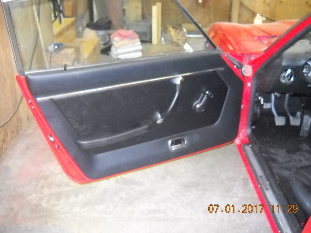

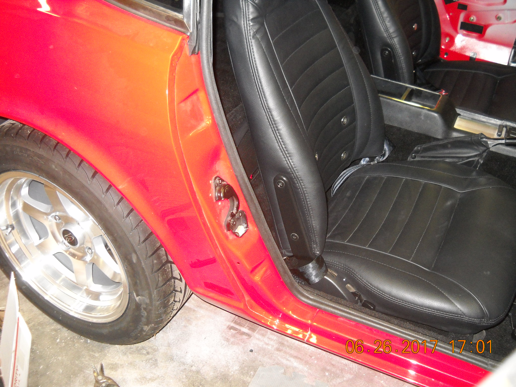

2 hours ago, sweatybetty said:
anyone know ho to get the chrome trim to snap in place on the door pulls?
You have to back off the mounting screws to that perfect torque that keeps the screws from vibrating loose but slack enough to allow room for the plastic cap to sink into the door panel enough to snap over the clip. At least if the screw does back out it will be captive within the cap until you start over, I have tried just a little smear of sealant on the threads in the past.
