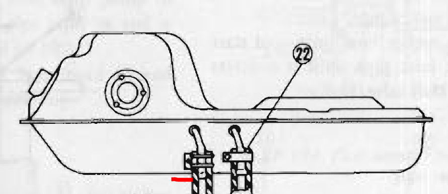

Adding a picture to think about.  If the outlet port tube is tweaked upward, or the car is tilted, the siphon problem, and just keeping the inside hole covered, gets worse.  These cars are known to suck the line dry on left hand turns when the tank gets down around 1/4.

Reading the OP Signature line it looks like he has a 1978 280Z. OP: Is that correct?
1977 and 1978 280Z's have a fuel tank that is different than the earlier style that ZedHead shows in post #8. From the parts manual, it looks like the fuel line connections are on top of the tank. OP: Can you confirm this?
With fuel lines on top of tank, fuel has to be drawn out by vacuum from the fuel pump. 5 gallons in the tank may not be enough to have fuel flow " up and out " by tilting the tank or even pressurizing it. You would need a very large volume of air to maintain flow, and all vent lines and fuel filler tube would have to be closed off.
Picture of 77 - 78 Fuel Tank. Note that the fuel lines appear to come out of top of tank:
