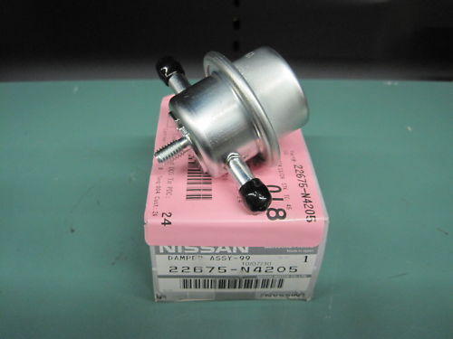

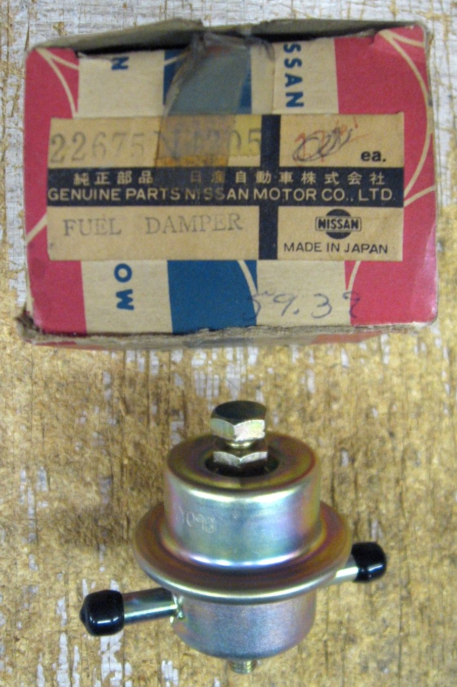

Posted November 26, 20159 yr comment_481695 The FUEL DAMPER on my 1978 280Z is leaking and dripping gasoline. Aside from the obvious safety issues, it creates a pressure loss in the fuel system. The FUEL DAMPER sits directly above the fuel pump. Its purpose is to provide a smooth flow of fuel to the engine, so it is unwise to bypass it. This is Nissan part 22675-N4205 which is NLA and very hard to find. It was used in the 280Z, 280ZX, 810 & 200SX. The early unit has the adjusting bolt while the later unit does not. But both have the same part numbers and function the same. See the pictures. I have called all the usual vendors and have had no luck in finding one. Motorsport says they can’t even get it out of Japan anymore. The day may come when you may need one of these. If anyone has used a new aftermarket part with success please let us know what it is with the part number. And if you have a NOS one for sale, please let me know. Thank you. Link to comment https://www.classiczcars.com/forums/topic/52880-official-280z-fuel-damper-thread/ Share on other sites More sharing options...
