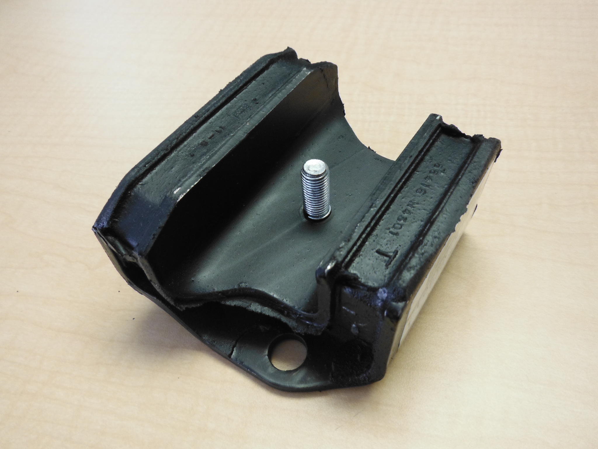

Here are some pix that I've accumulated from this site and others (apologies to the owners -- I didn't record names with photos).

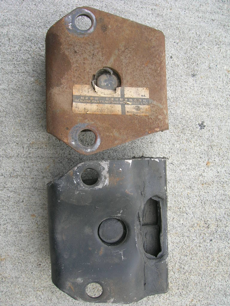

Picture #1 shows the top surfaces (front of car points right)... 240Z early type (55415-E4100/4101/4102) on the top, 240Z later type (55415 E8300, introduced in 7106 for the MY1972 240Z) on the bottom...
xS30 Differential - Front Mount Insulators - OE - 240Z early vs late - top.jpg
Picture #2 (below) shows the bottom surfaces (front of car points up)... early type (55415-E4102) on the left, later type (55413 E8301) on the right...
S30 Differential - Front Mount Insulators - OE - 240Z early vs late - bottom.jpgx

Going back to Picture #1 and #2, it looks to be like the 'early' and 'later' 240Z designs, there doesn't appear to be anything different about the hole spacings/positions for the two mount bolts.  The location and size of the threaded centre stud looks the same, too.  The upper/outer plates have different shapes, but I don't see anything that would prevent re-shaping the contour of the later style plate if that's needed to make it fit into a Series 1.

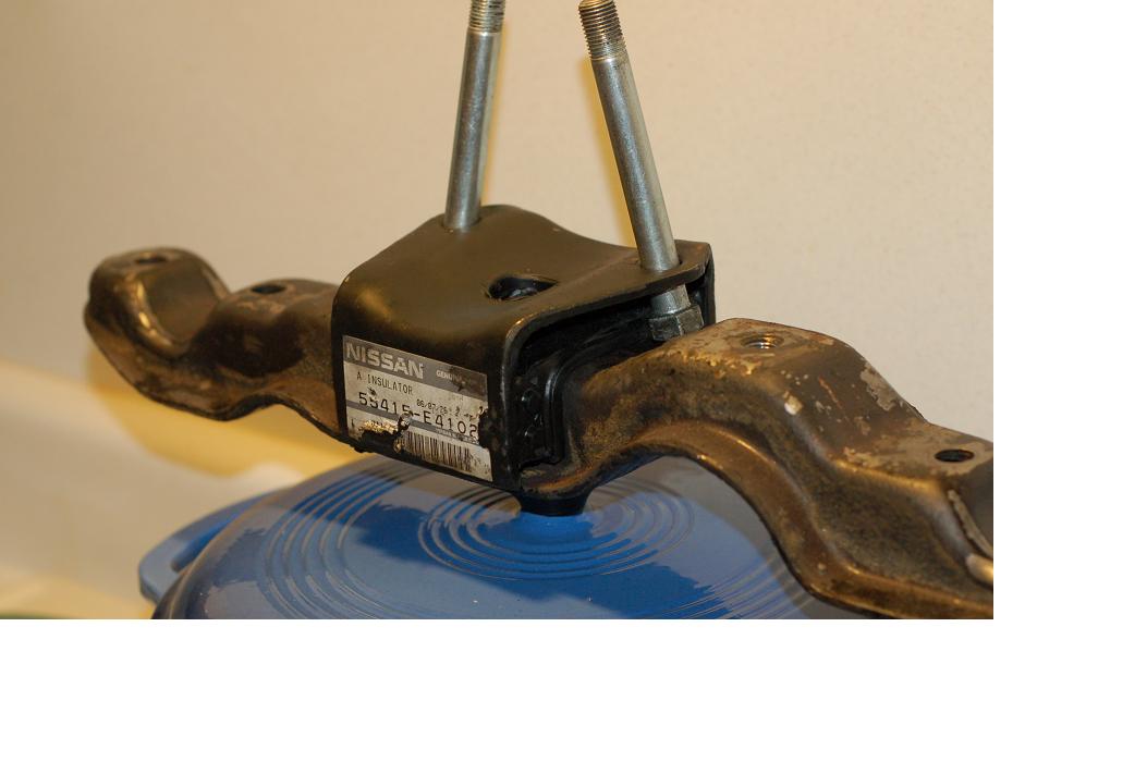

Also, the width of the inner plate's 'jaws' looks similar, early vs late, so it appears that the later style mount would fit down over the early style crossmember.  I emphasize the word, 'appears', because I've never read anywhere that this can actually be done.  Perhaps someone else has tried this and can comment.  For possible reference, Picture #5 (below) shows the early-style insulator sitting in position on top of the matching front crossmember.
BTW, I don't think there would be any need to turn the later style insulator back-to-front to make it work in Series 1 application.  Again, others who've actually tried this may have a different opinion.
In case you're curious, the threaded holes in the crossmember on either side of the insulator are provided to take a bolt that retains an exhaust system hanger piece.
Also, good info on the stock exhaust hangar location.  That would be the threaded hole just to the right of the
insulator in your picture, above.  Not sure what the threaded hole just to the left of the insulator, as pictured,
is for, unless there was a dual exhaust setup for other S30 iterations.

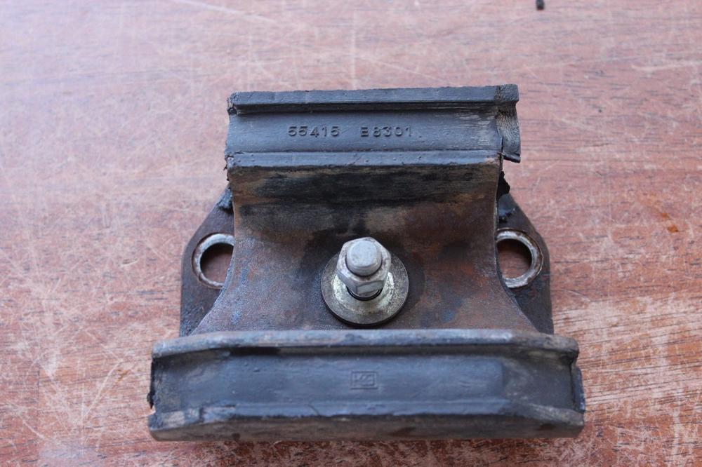

My blue 240Z (03/70) ,it has E8300 or 8301 insulator!!
 I did not know that until I saw it last year, probably Tetsu (restorer ) could not get E4101/4102 when the car was in a restoration in 1999. Now I have NOS E4102 , the label which is on it says 06/06/16 . This would mean 2006 / June / 16th.
I have forgotten that I need to do it but now I want to replace 8300/8301 to 4102 soon,
I am very curious how did Tetsu fit a 8300/8301 on a 1970 240Z. Looks like it is turned 180 degrees , maybe we do not need to modify anything?
Kats

Kats, it's good to hear from you.  Interesting that Tetsu was able to fit an E8300/8301 insulator on your car.
I would be interested to know which front diff crossmember he used with it, and if he did turn it 180 degrees
to line up the mounting holes.  Was he able to fit the early composite exhaust hangar?  Good find with the
NOS E4102.  That insulator in NOS condition can no long be found on this side of the pond.
