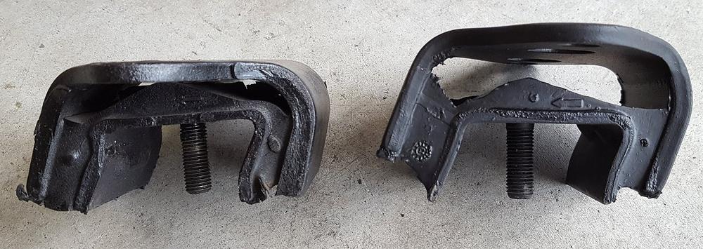

Here's another photo that I forgot to post yesterday that illustrates in pretty dramatic fashion how this insulator can collapse with age.  Not surprising, given that the cross-section of the rubber core necks down to what looks like only 1/8" in width...
(As before, my apologies for not being able to credit the owner of this photo.)
If you go back and look at Photos #1 and #2 of my earlier post, you can see how the later-style insulator's design changed so as to significantly increase the width-wise dimension of the rubber block at the front.  Perhaps this was an effort to reduce the insulator's vertical compliance.
The crest built into the top of the rubber block indicates that insulator was obviously designed to bottom out.  Still, it doesn't look like you'll be doing this insulator any favours, long term, if you use the diff casing as your rear jacking point.
@HardwayOn a related point, Hardway's recent post in which he stuffed coolant hose into the insulator opening to (successfully) cure a diff 'clunk' issue suggests that his front insulator is now operating in a permanently bottomed-out condition.  Waiting to hear whether he reports any significant increase in gear noise coming into the cabin as a result.  If he doesn't, then that 'stuffing' fix may make replacement of a collapsed front insulator a non-issue.

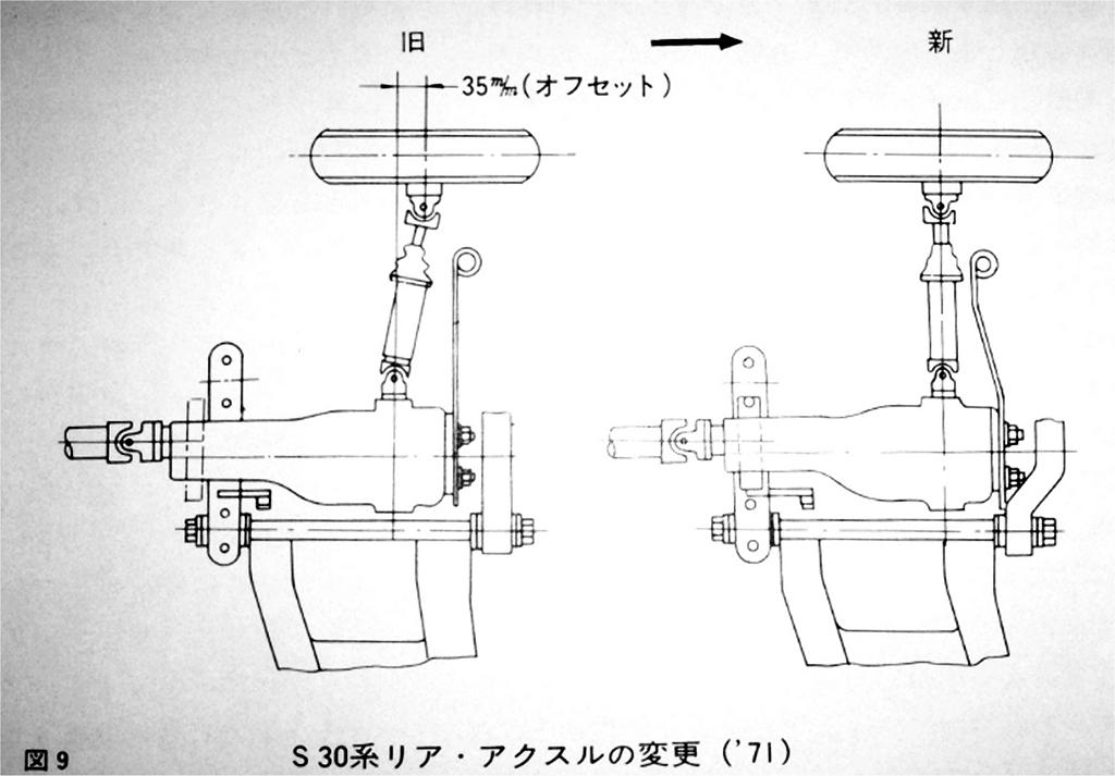

Pictures from the service manual,
Second picture, you can see the new muffler hanger , new curved rear cross member, and the mounting insulator 55415-E8300.
Kats

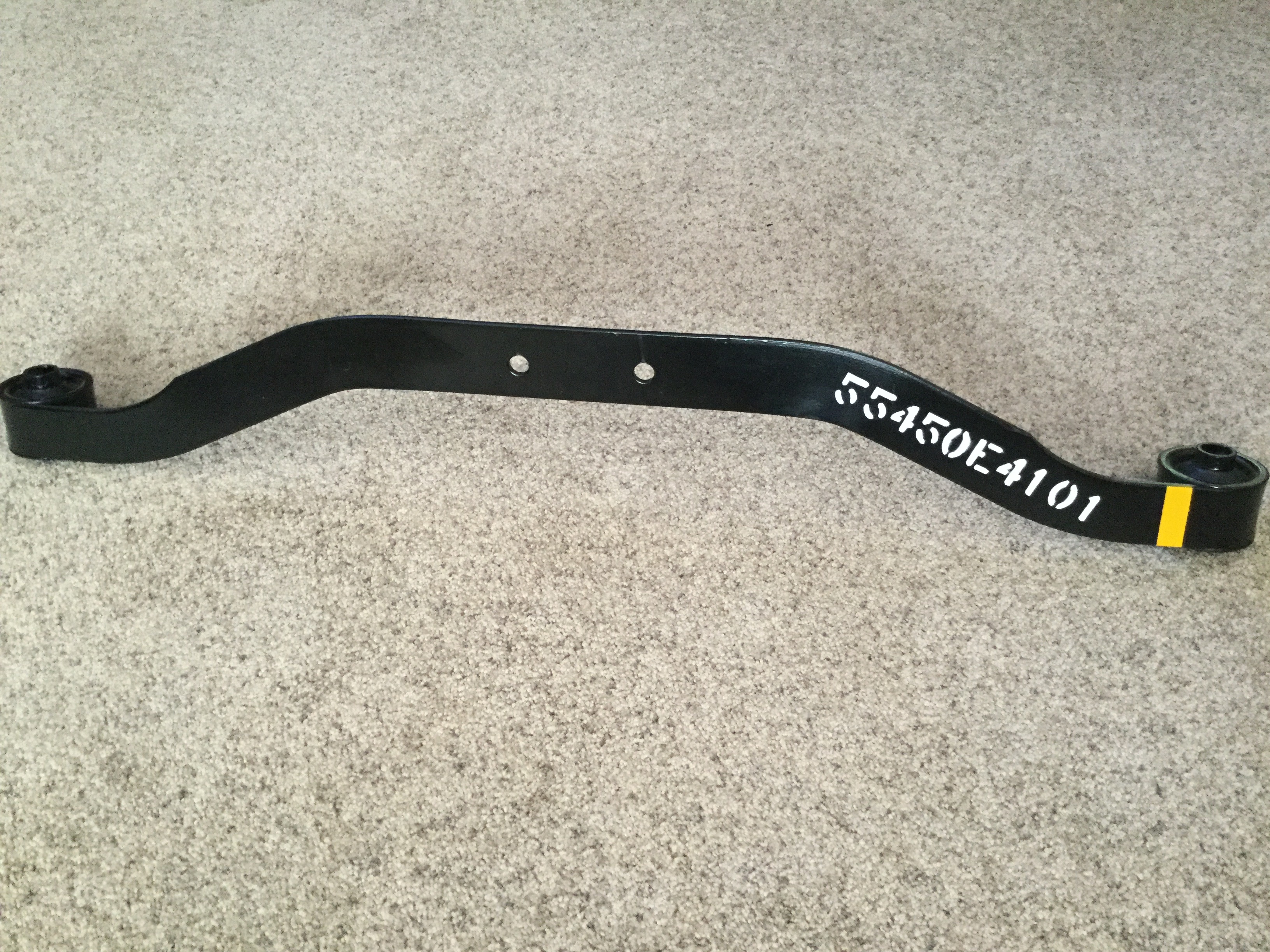

Kats, I have finally found all of the necessary parts for my differential relocation, and wanted to again
thank you for helping me find a NOS diff. insulator.
below, I wanted to include a picture of my restored mustache bar as I have, again, taken a lesson
from you on how this should be done.
Thanks again, Kats.
