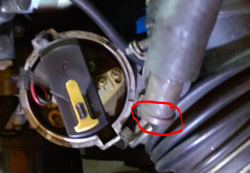

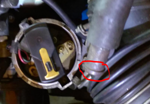

I noticed this in your other picture but assumed that it had to be a closed elbow.  But in the attached snip it looks like an open T.  It would be a big vacuum leak.  The crankcase, valve cover, and intake manifold are all connected.

Yes, closed elbow, not a tee.  FYI, the tach flutters when attempting to start, so I assume it is connected.  Will run the bible troubleshoot test again and report results.  Last night, all were either continuity or battery voltage, as indicated in the test.
