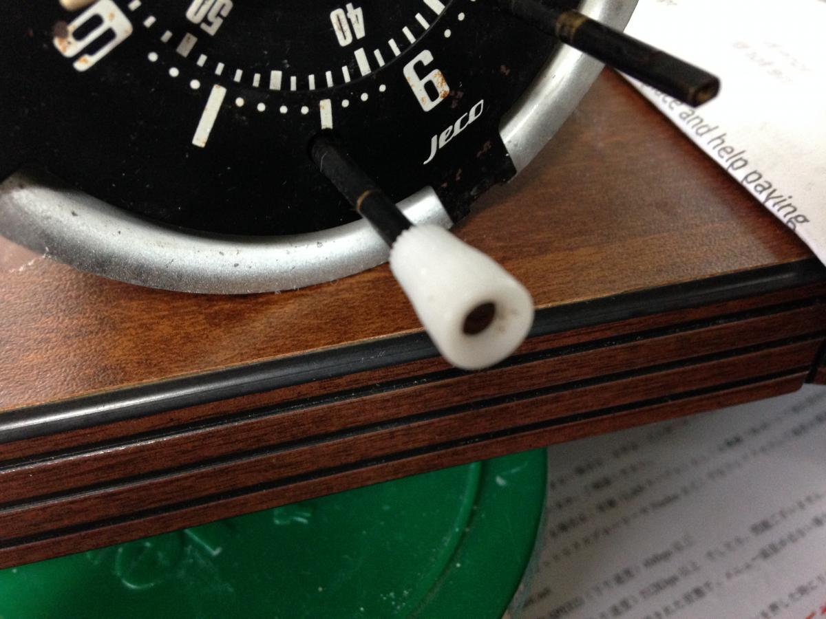

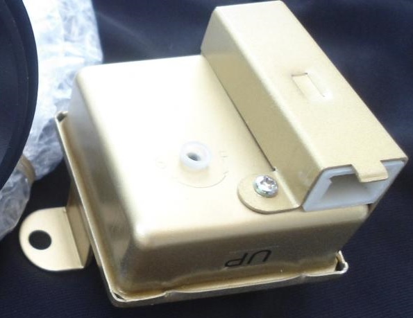

Starting out simple with one of these boxes. Then a radio faceplate. I'm starting to think a silicone mold for the faceplate would be easier.

I did a knob with silicone mold and it turned out great.
