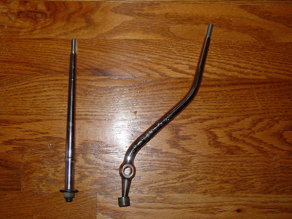

post-23426-0-73345800-1451154289_thumb.j
shift level on the right is one that I cut, bent and rechromed to the correct shape for type B transmission.
This is for a 70 or 71 car, which now clears the center console using type B transmission.

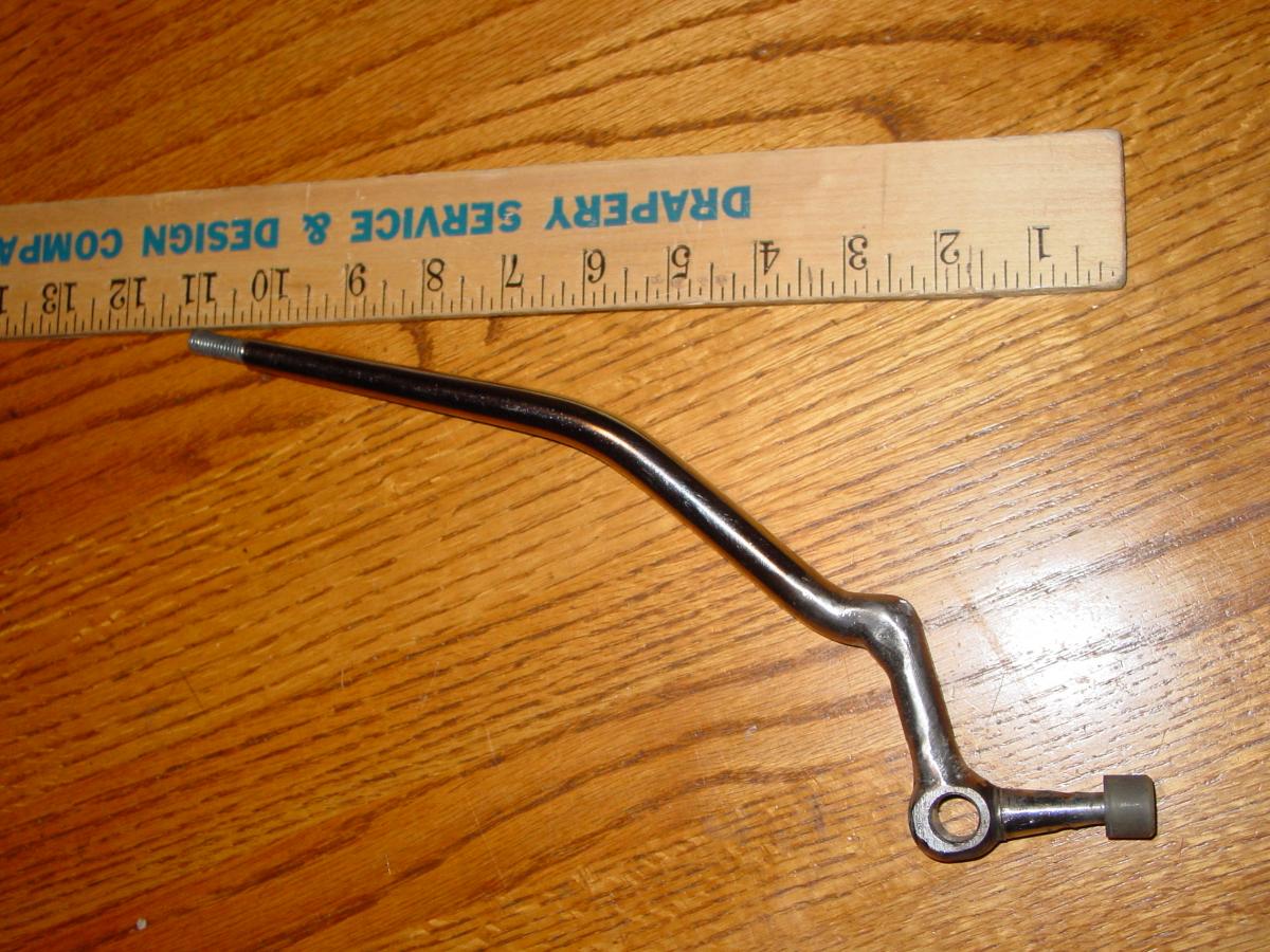

post-23426-0-53698900-1451154326_thumb.j
steve

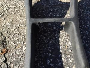

When I converted my '71 to a five speed transmission, I experienced the same interference with the console. However, I didn't need to trim too much to avoid shift lever contact - not nearly as much as in the pictur e in the previous post. With the shifter boot installed, the cut out is not noticeable.

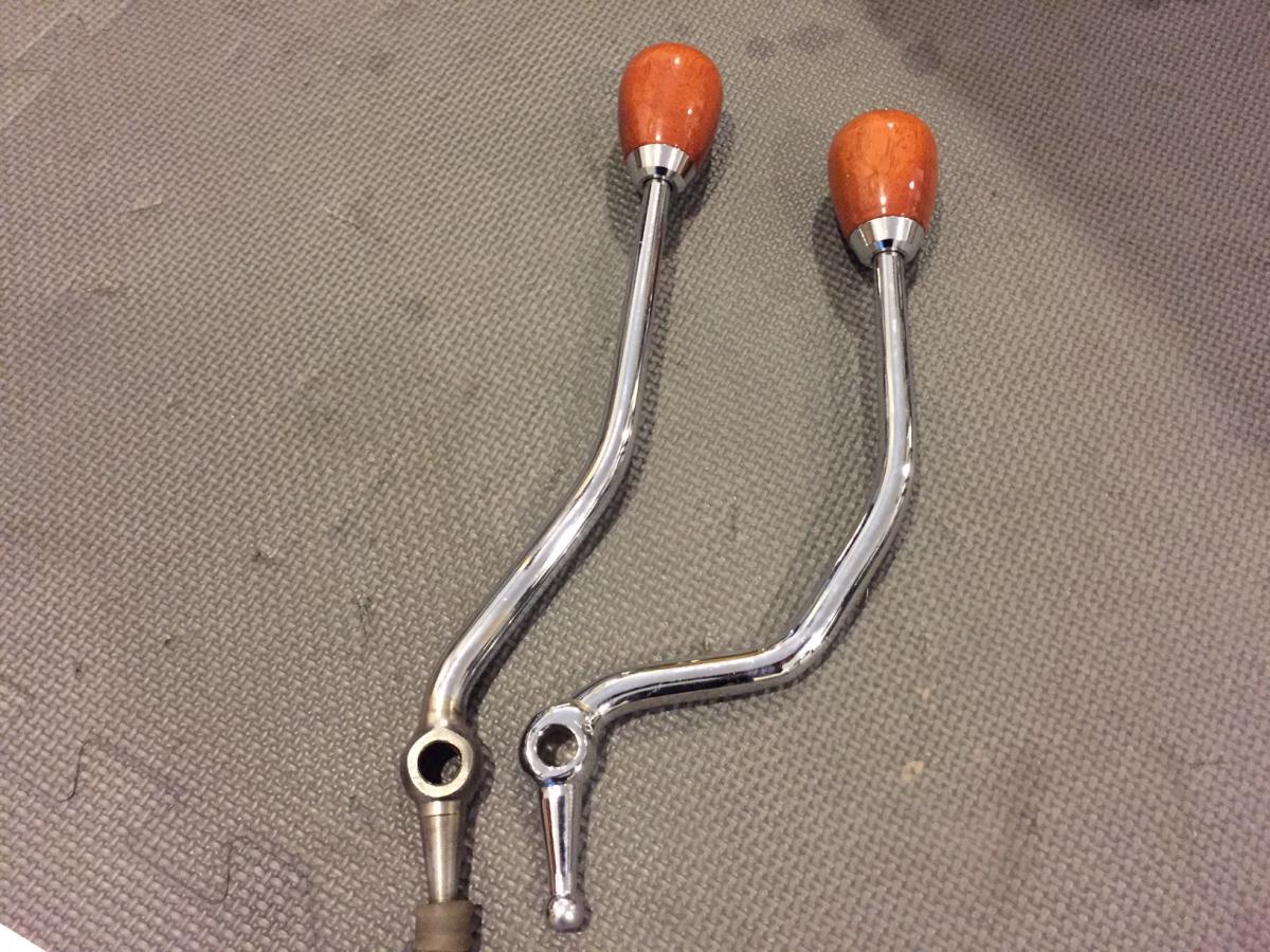

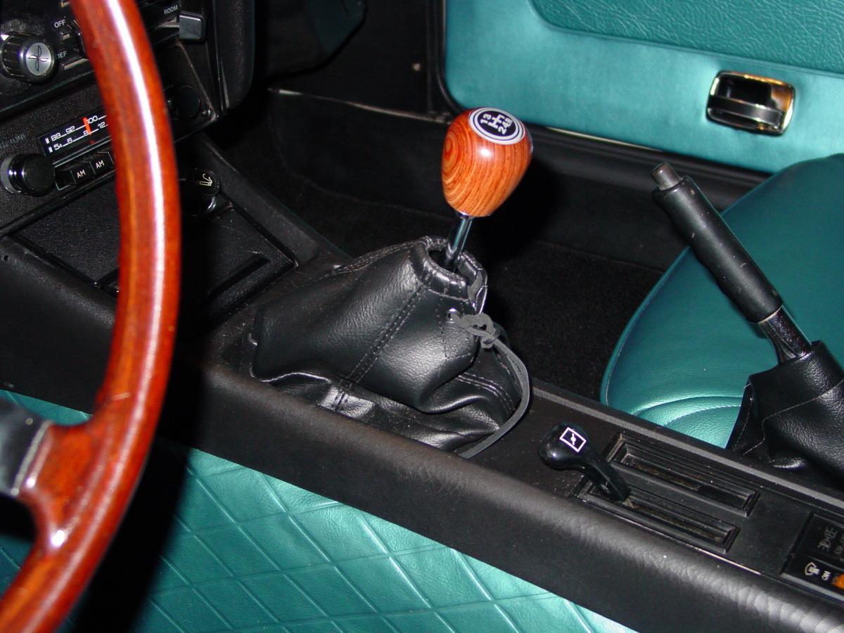

Below in the first picture is a Type A shifter, next to a standard Type B shifter.  The second picture is a Type B shifter that I had modified by my body & paint guy and the third picture shows the modified shifter in the car after I installed it.
The modified shifter worked great -very smooth!
