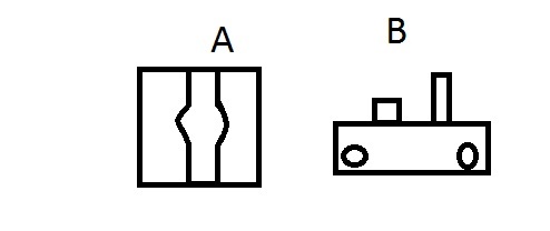

You know how the jack has the slot on the lifting plate?  It has not only a slot, but a round hole as if a large pin is supposed to fit in there. Picture A)  I haven't looked, but is there supposed to be some kind of a bulge in the pinch welded area where the jack point is?  It would be useful for safety, as as bulge would help keep the jack from slipping sideways while lifting.
BTW-    Is the floor  at the same level as the outer part of the rocker?  I think I might get a newer scissor jack, but not all are the same design as the Zed jack:  one side is higher than the other. (Picture b
I think that the round area is there so that the rivet (?, bolt?), that holds the top piece to the rest of the jack, can be inserted and attached.
I think you are right.  the head rotates on that point and  I think there is a rivet there.  Most other scissor jacks I've seen have a non-rotating head, which is welded on, so the rivet is unnecessary on those jacks.  So you can turn the head and use your Zed jack on more than just the lift points under the rockers.
