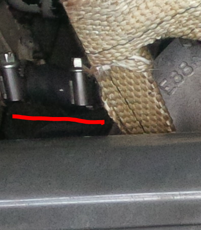

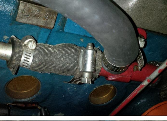

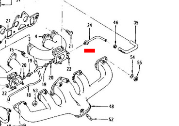

A few more pictures showing how the carb heating just might, maybe, who knows, be part of the problem.  Even if it's not though, it's so easy to eliminate it as a potential cause.  Eliminate the simple stuff and you're left with a better focus.
No thermostat in the carb heating line, coupled with attachment to a high velocity return to the water pump inlet, pulling water through the manifolds, could lead to excess heat at the carbs.  As noted in the FSM, "deterioration" can occur with too much heating.
