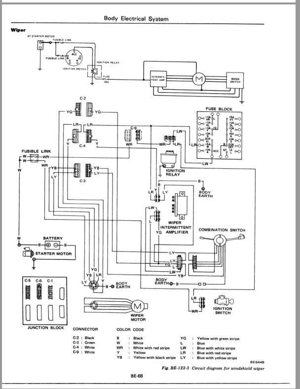

    looked at the fsm what is strange though is the fact that the blower motor and wiper motor stopped at the same time. Didnt think they were on the same circuit. I removed the wiper motor and it is fine. tested it with a power probe and runs fine when i apply power to it. When ni tested the harness connecter for the wiper it popped the circuit breaker on two of the contacts which makes me think it might be a short somewhere. I am by no means an electrical expert so i am learning as i go.
    Edited by Kamaka z
    I have narrowed it down a bit. I have power at all 4 fusible links. I have power at the plug that is on the inside passenger side wheel well. somewhere between this plug and the fuse block i am losing power. only four of the circuits in the fuse block have power the rest are dead. Could it be a relay or does the harness go to the fusebox first? ive studied the wiring diagrams but dont see a place where the power could be stopped?
