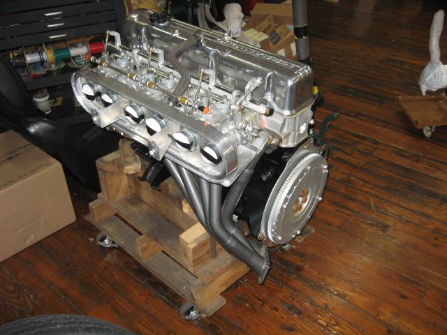

Picture of header (seems to be too small)

Picture of header (seems to be too small)  Dimensions are as noted.  See attached photo.

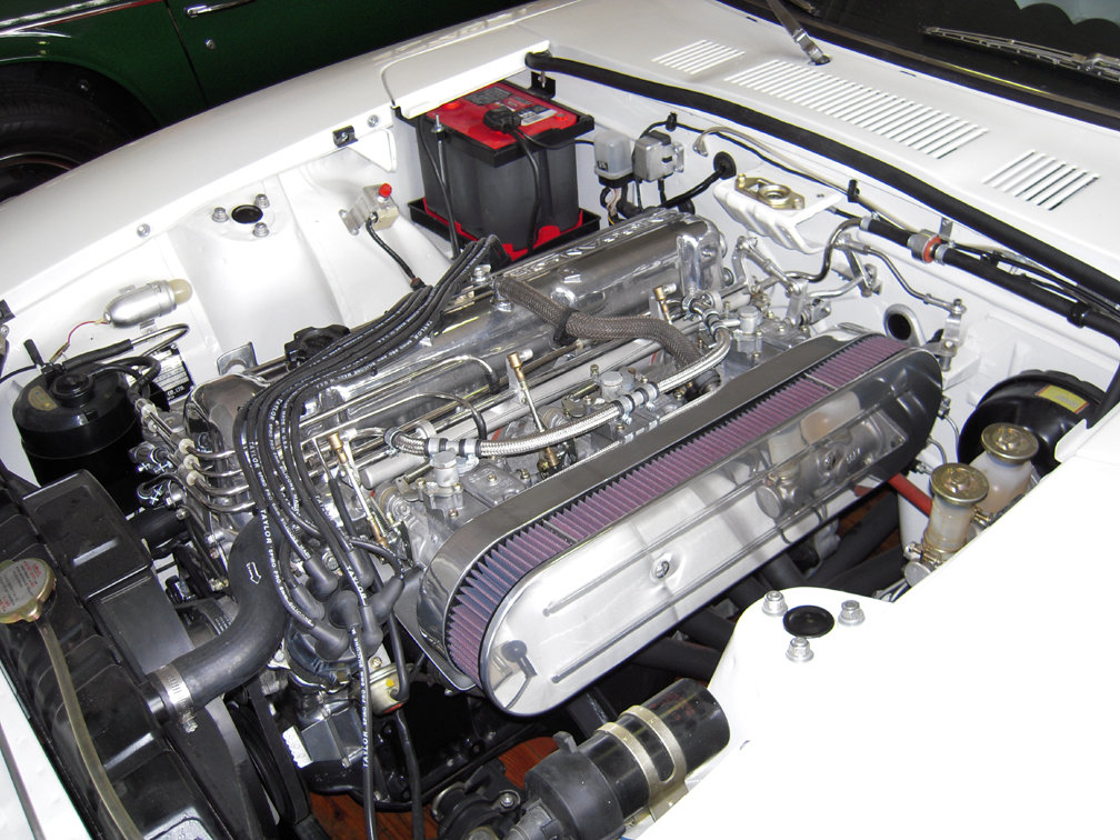

I like the air cleaner and the fuel lines look good. You have quite a few lines running around the front of the valve cover. what are they? Sorry for thread jack...

I would think that with some carb tuning, advancing the timing, and a better dizzy you should see another 10-20 hp. I base that on our L24 street/track engine with triple 44mm and a similar build as yours. We got 210@crank running 110 octane at 34 degrees advance with a CR of 12:1. The L28 and 3.2L engines in full race mode make 294 and 345@crank respectively. Those run between 13.1 to 13.7:1 CRs. We use a 75 dizzy (vintage rules), an MSD box, 8.5 Magnacor wires and NGK non-Iridium plugs (race fine wire instead).
