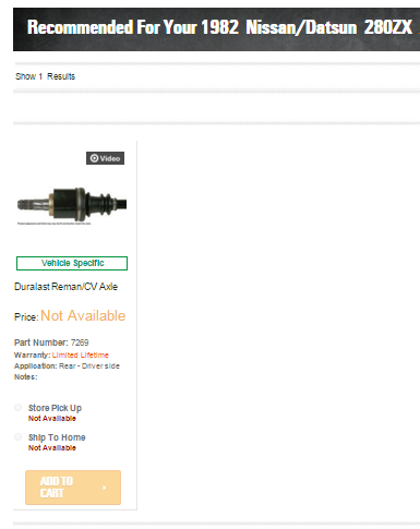

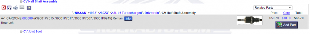

Reman CV's aren't known for their quality.  There may also be new aftermarket CV's that would work although the aftermarket apparently gets their lengths confused. People have received 300ZX axles instead of 280ZX.
