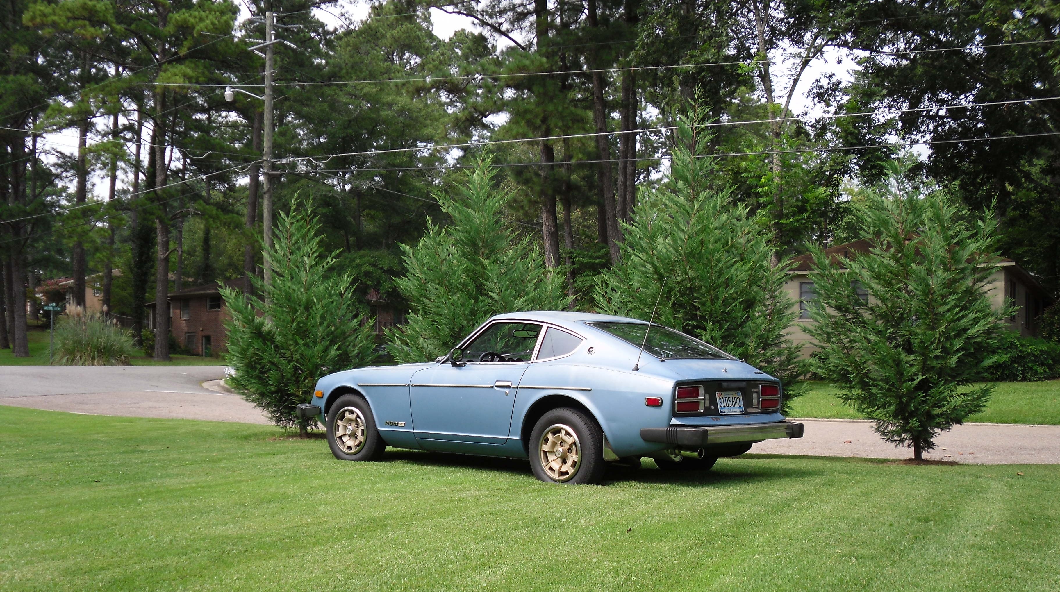

Good deal!  That's why I was suggesting other ways.  Now you can get a car cover.  Don't give up on the '77, I love mine and I think, from reading on here for five years, there's more information on a '77 than any other 280.  Just a coincidence I suppose.
Here's mine without the Rewinds.  Just like high school. :)
SDC10695.thumb.JPG.aac49436861862753cab8
