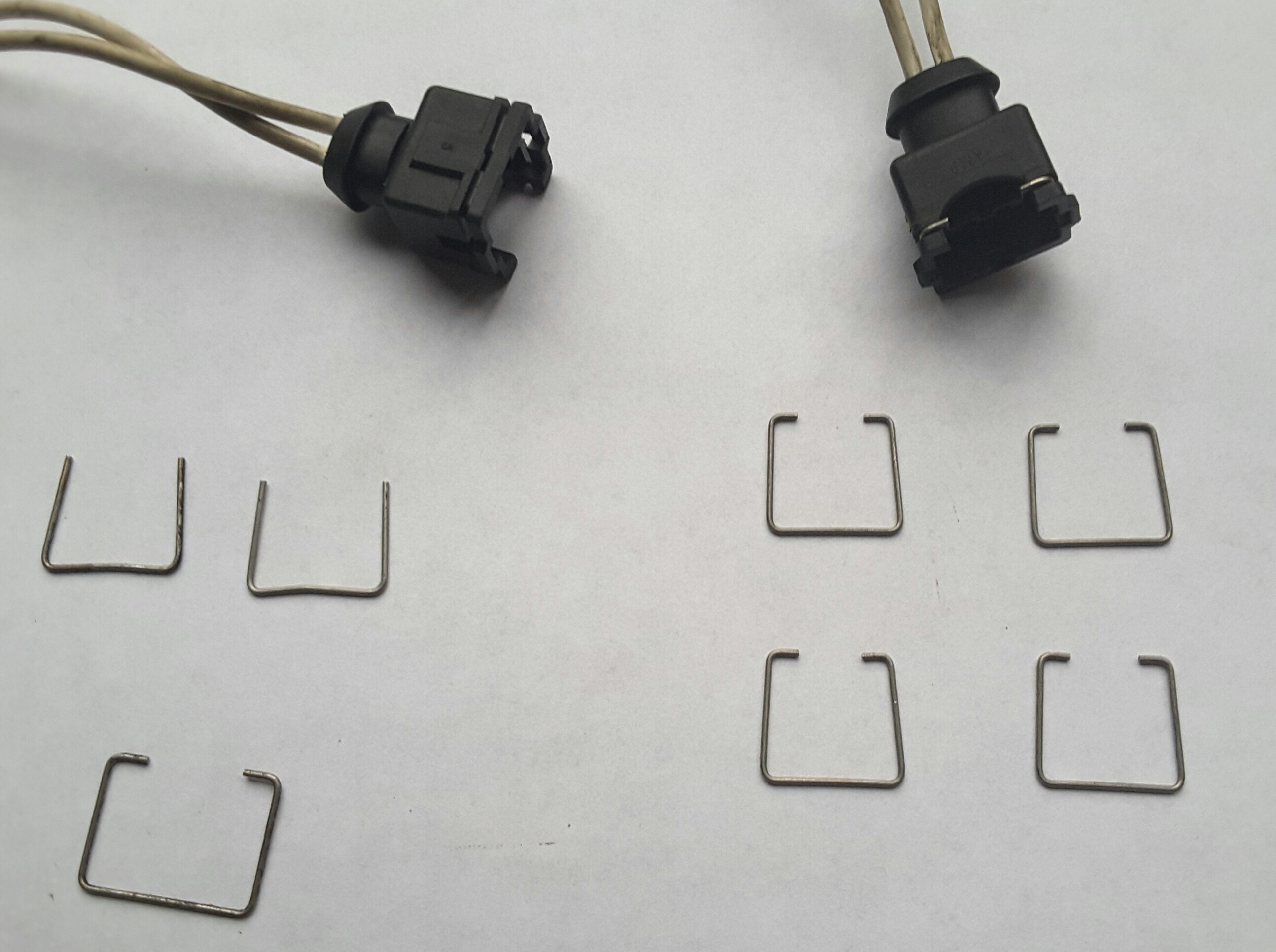

21 hours ago, Zed Head said:
Here's a link to what the injector clips look like.  You can see it in your picture.  They used a different style for some reason, even more difficult to remove, in the hardest spot to get to.  Your right angle pick will work, or a small screwdriver.  Pry the tip out, lift one side to keep it there, then pry the other side out and remove the connector.  Or you can pry it out then stick a striaght pick underneath to hold it.  Or get mad and just tear it off, the old plastic will shatter like glass.  Replace with GM, Audi, BMW or Volvo spring-clip EV1 connectors.  Mid-90's era cars used them, some still do.
http://www.thezstore.com/page/TZS/PROD/11-3410
Here's a bulky style.  The GM and BMW models are very streamlined.
http://www.thezstore.com/page/TZS/PROD/11-3059
There are two style clips for the connectors. The old style (I think pre Aug-77) is a C form and the later style is an U like on the MSA website. All my original connectors had the C style. See photo for the two.
If you havd the C style. It won't come off without prying the leg out from behind the conector.
All the new stuff seems to be the later U style, but since you have an early 77 you may still have the C style.
Yeah. Upon closer inspection, I have the early style on most of mine.  The CTS and CSV have newer ones.  I think they were replaced by the PO.  I've bought a kit to replace all of the connectors with new ones.  I need to replace the one on the AFM, because it's broken.  But unless I find a problem with other ones on the car, I don't plan to do them until sometime down the road.  I may just make a new harness someday.
