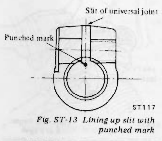

About that punched mark, the FSM says to line it up with slits in the U joint, but I don't see anything that looks like that on the column.  They aren't referring to the steering coupler U joint in the engine bay, are they?  Or just leave it at 12:00?

The U-joint coupling has a punch mark too, but I'm definitely talking about the end up by the steering wheel. They say "punch mark on the top of the upper column shaft":

Maybe yours is rusty and you just can't see the mark? Maybe they didn't put them on all the cars? Too late today, but I should be able to get you a pic tomorrow.

I know you said you didn't need it. but here's a pic anyway. This is the punch mark at the steering wheel end of the steering shaft. Mark is at about 12:00. Now I don't know if all the years and all the columns had the mark, but every one I've been into had that punch:
