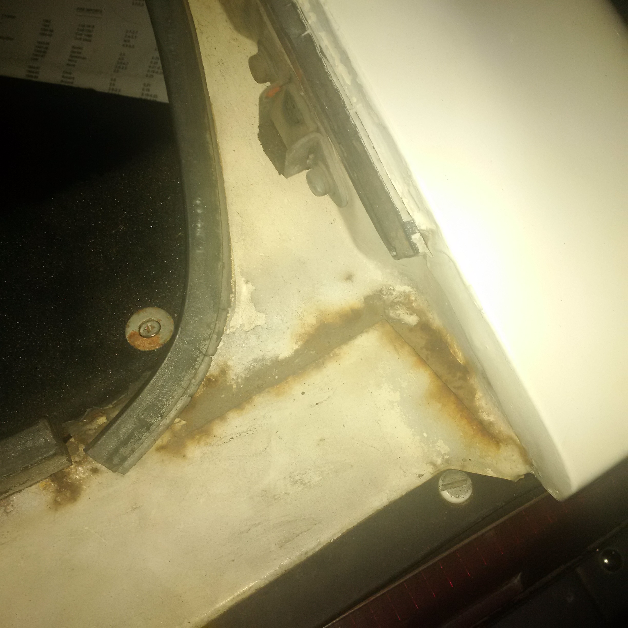

Okay! Just purchased all the materials and will be receiving a POR-15  floor pan and kit tomorrow as i got a contact who got it for me overseas:
http://www.por15.com/FLOOR-PAN-TRUNK-KIT_p_61.html

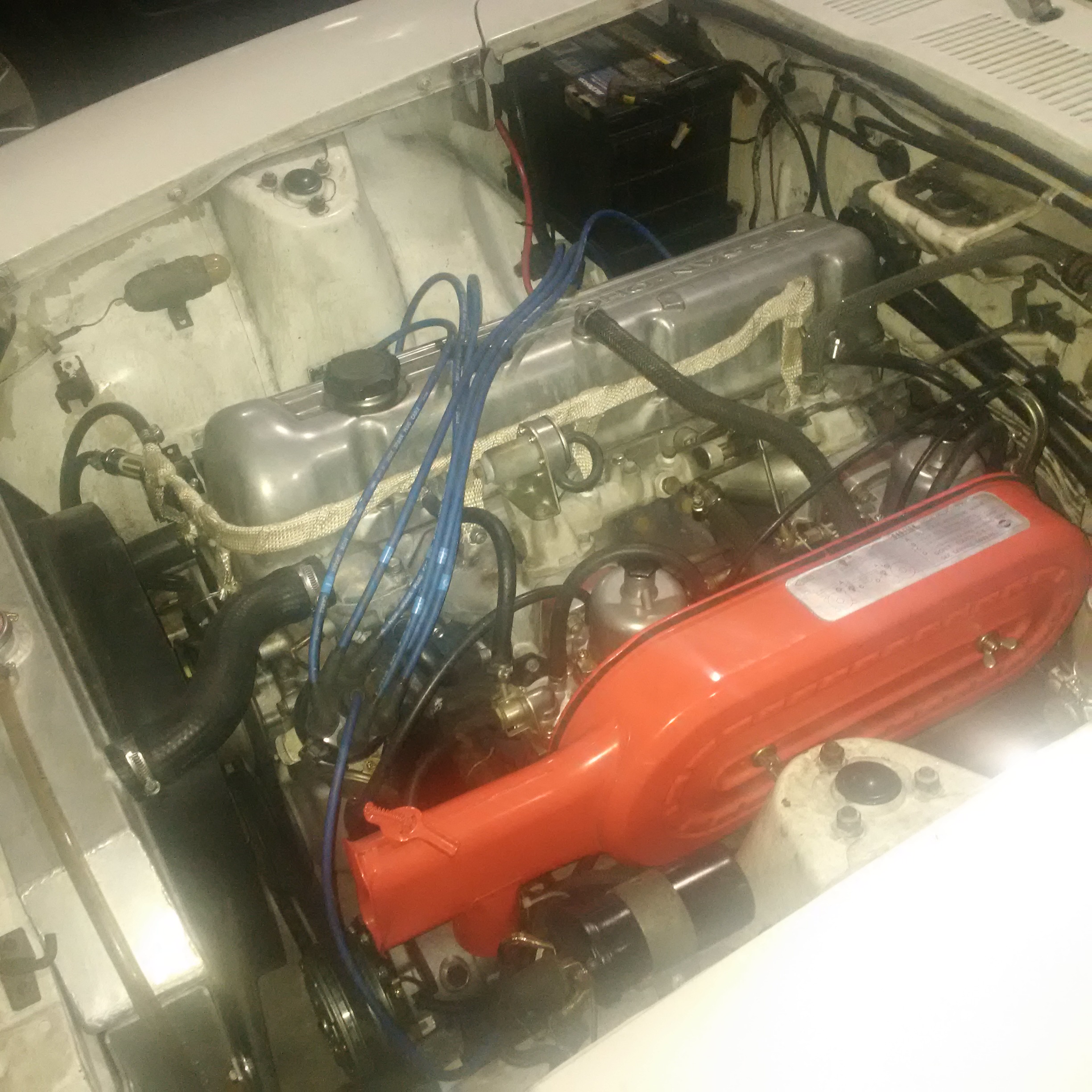

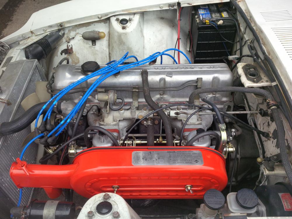

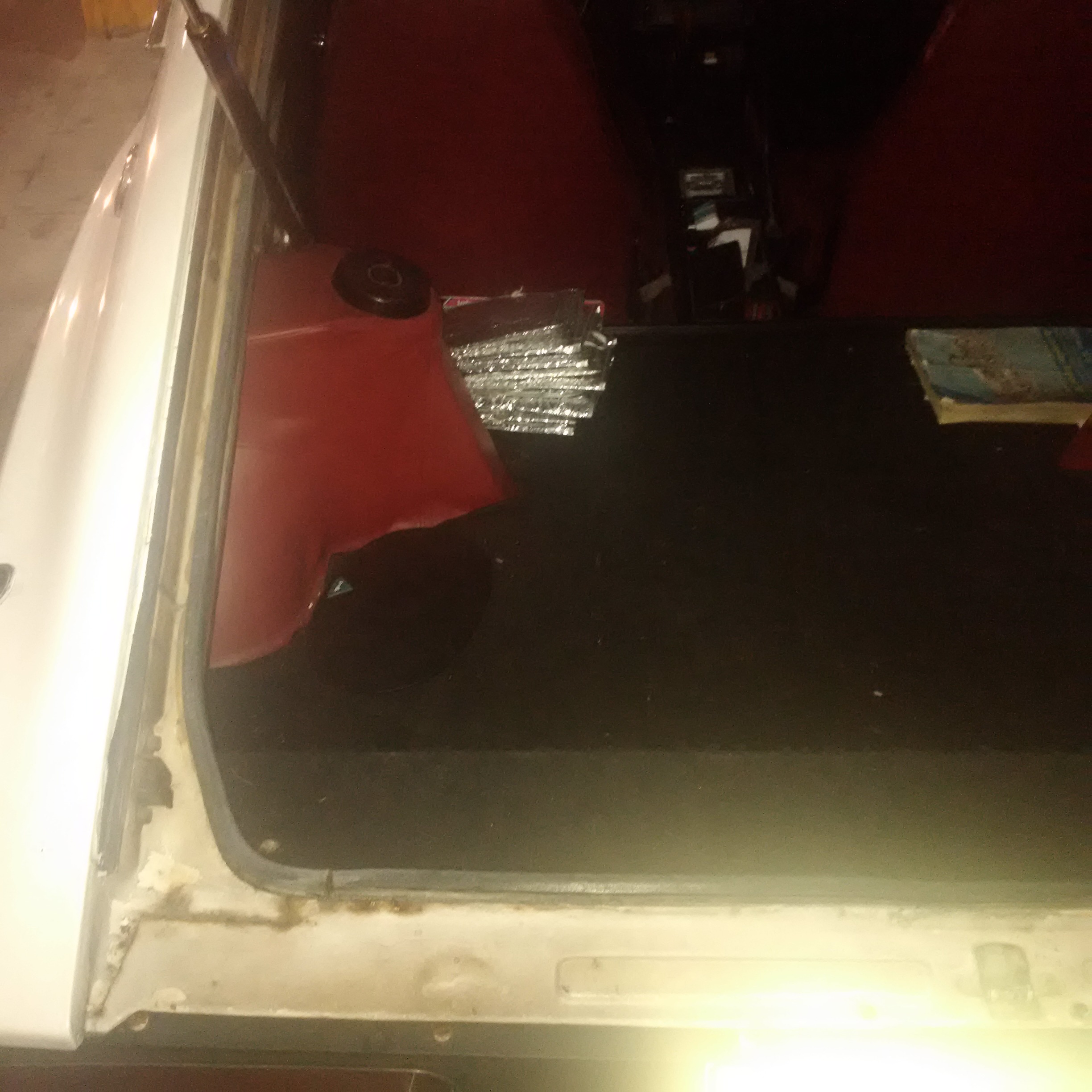

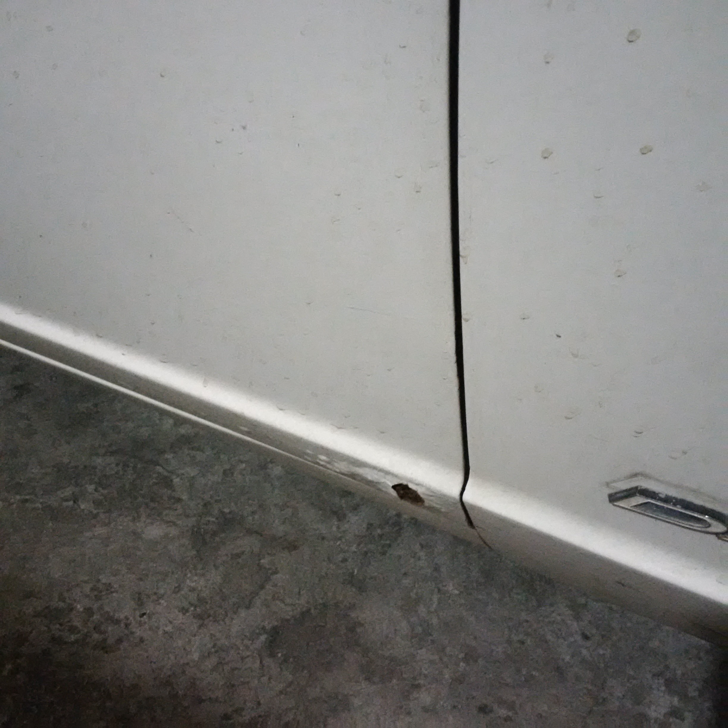

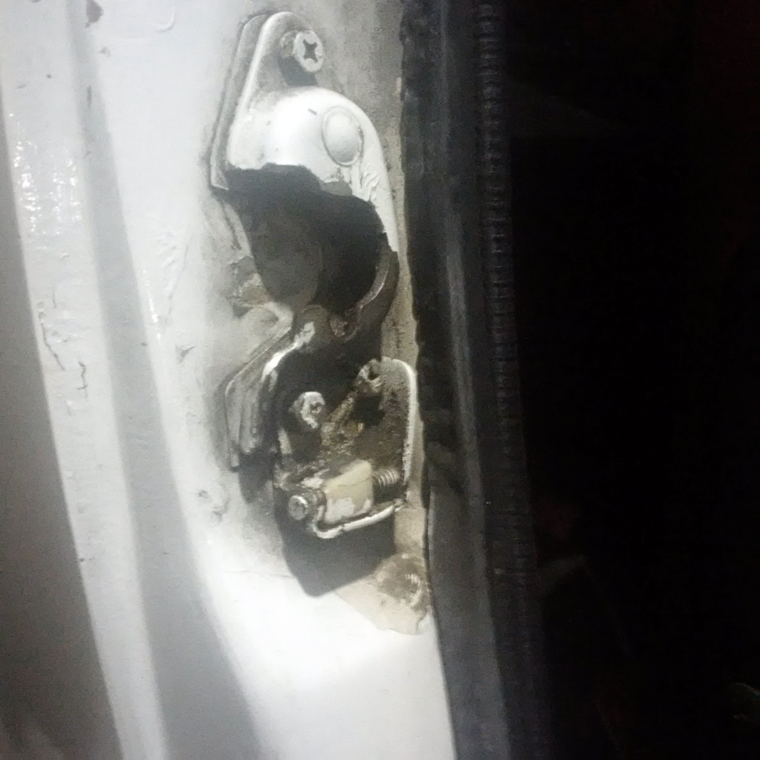

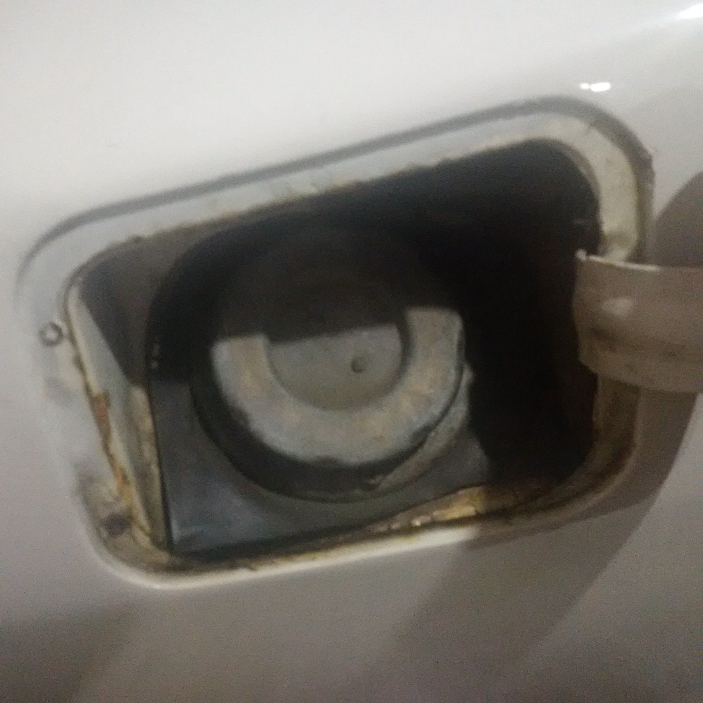

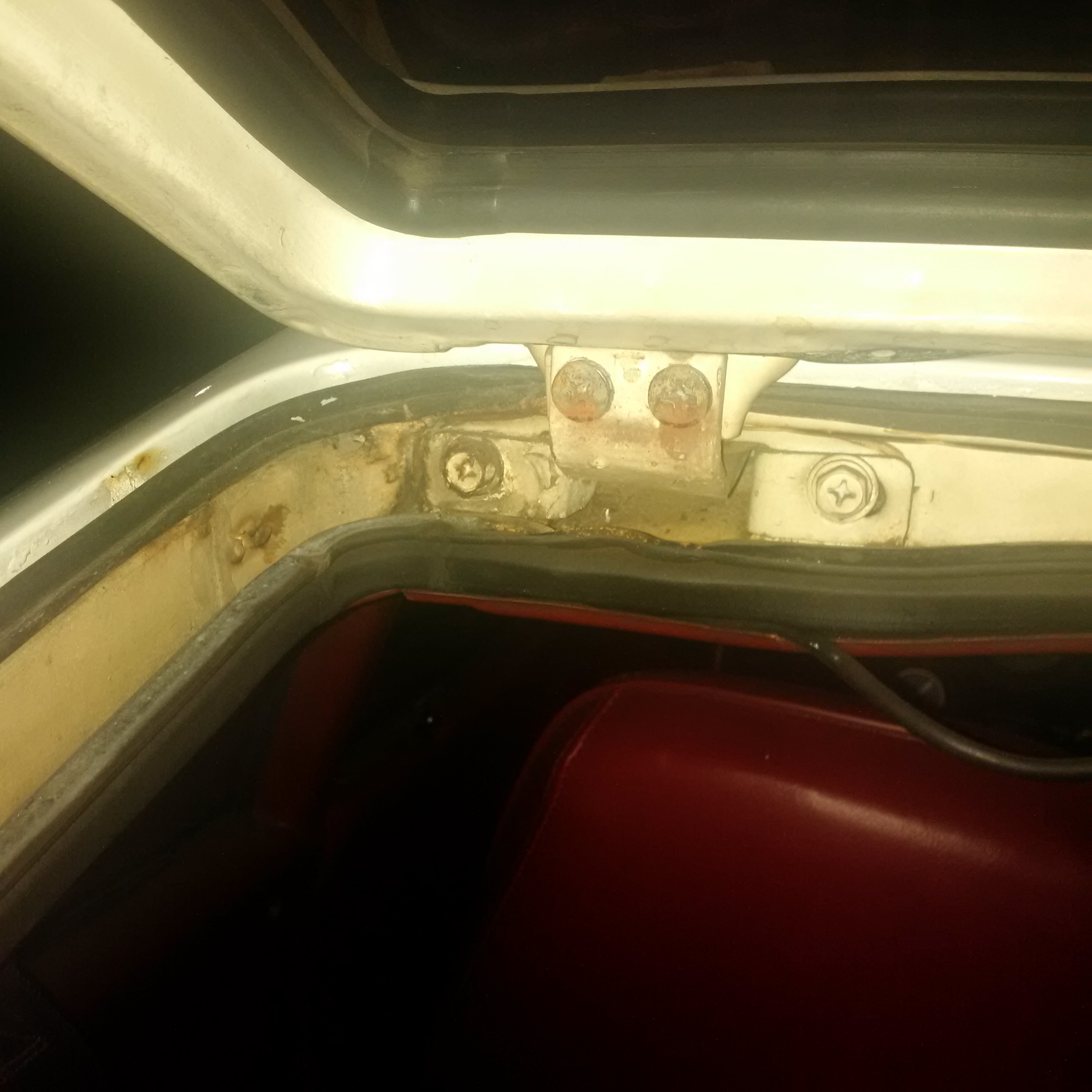

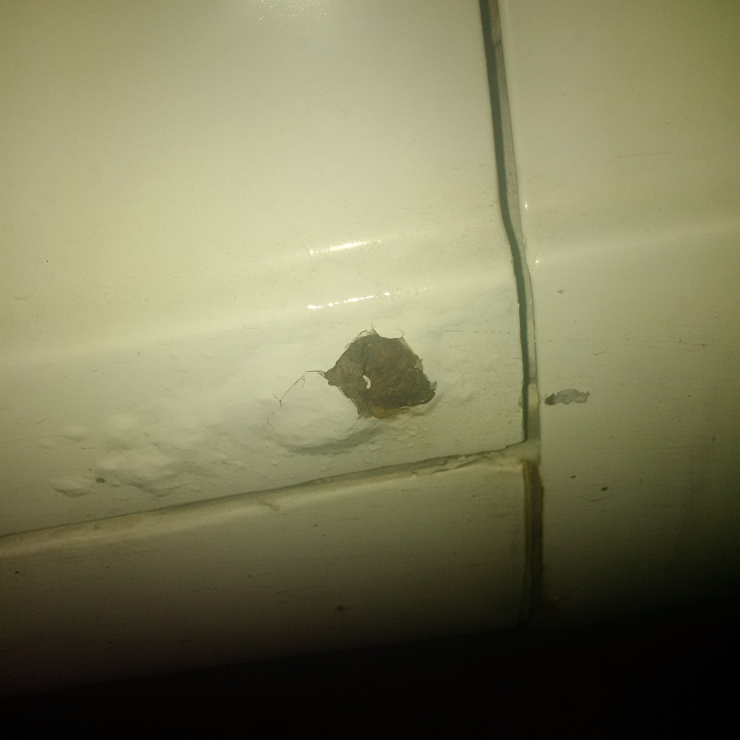

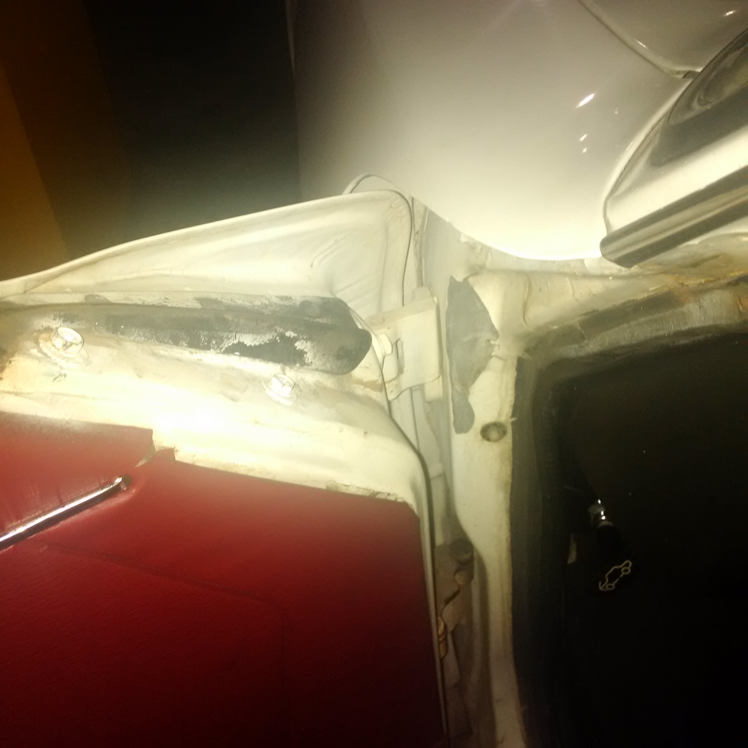

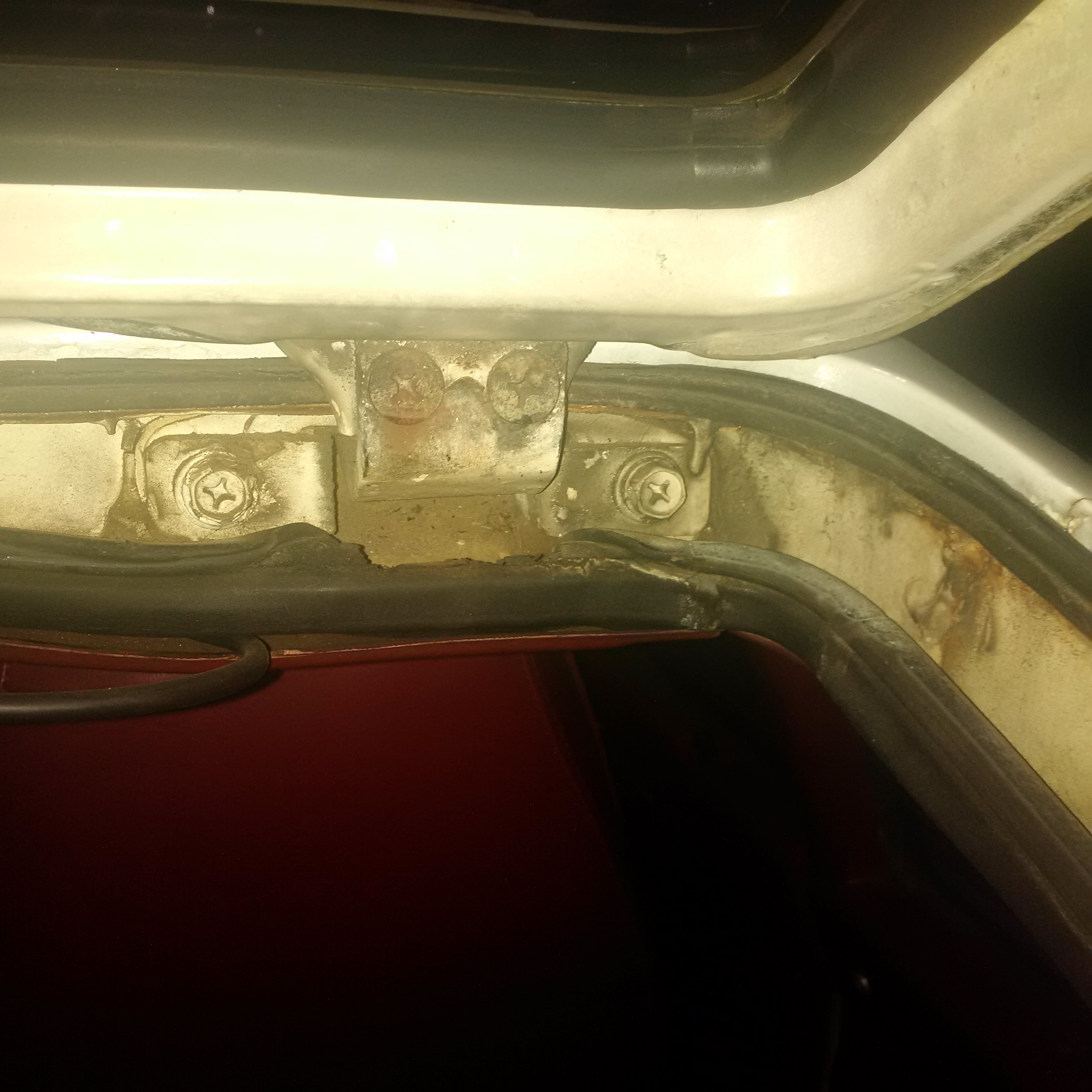

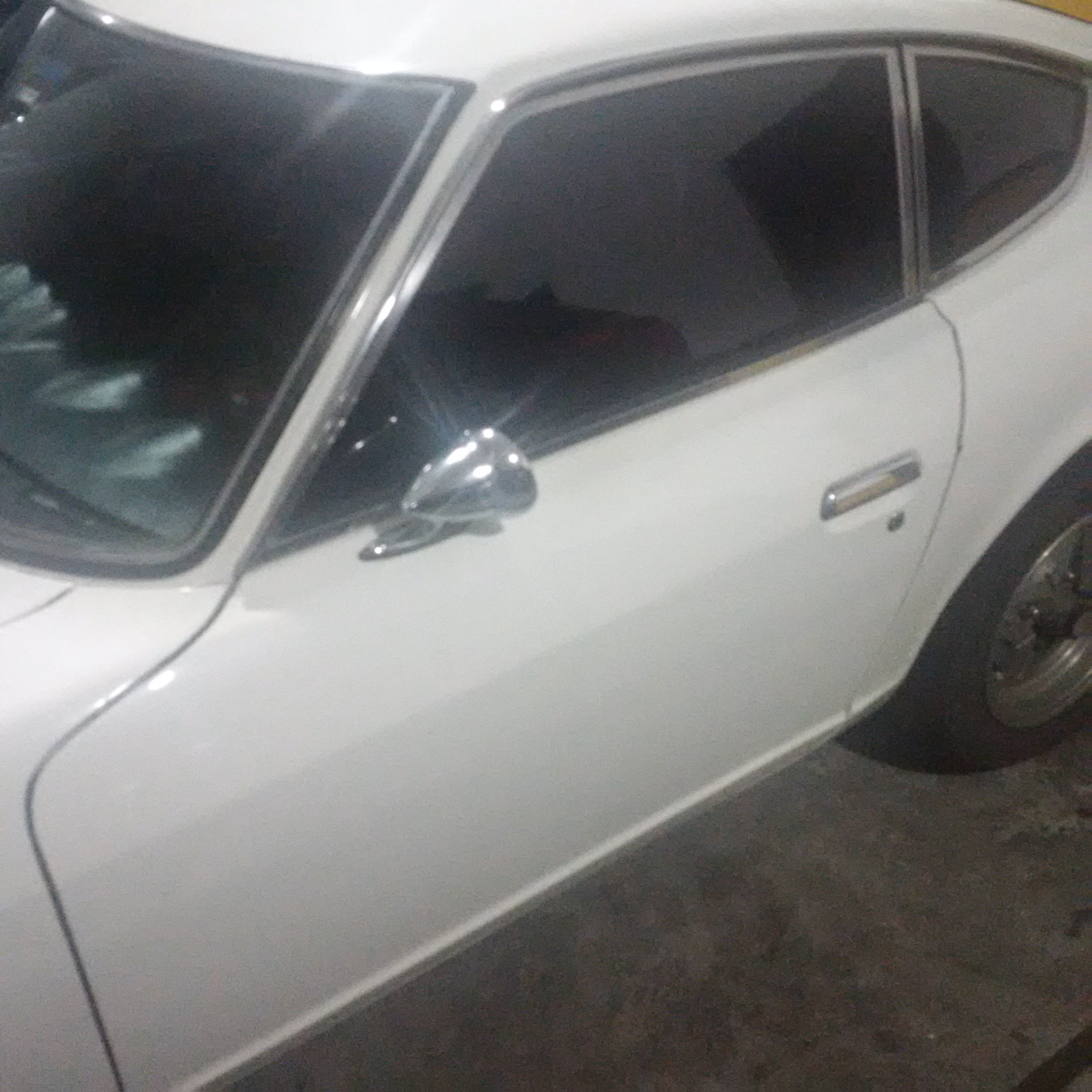

The car will be painted with PPG 904 Grand Prix White paint as it was originally done in January 1972. I have posted the following pics of the car in order to get some opinions on how should the paint job be carried out. Will the car need to be sanded fully down to bare metal with sand paper, paint remover and brush? When, where and how is the POR-15 applied?
Furthermore, do you think it is necessary to also purchase some new door striker plates and bolts, rear hatch door stoppers, driver and passenger door latch alignment dovetails?  Anyway of painting the engine bay without putting the engine down?
