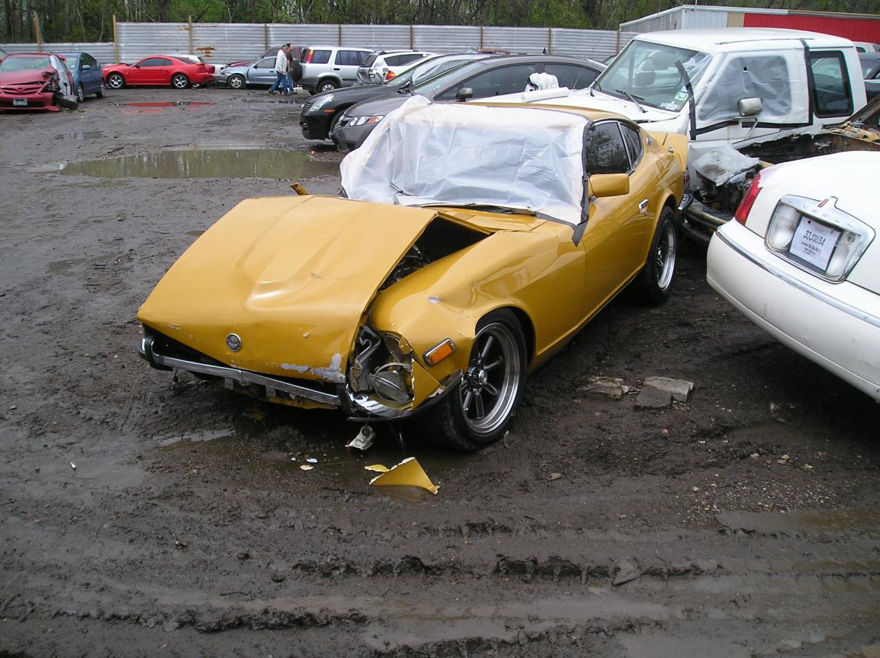

Just went back into my photo archives and found this radio i had.  It's an 1081A with the green light that came out of this early car #721 that was totalled a few years ago.
However, I cannot verify that the radio was added later as I don't know the history of this car.
Perhaps other people know the history and can verify if it was original to the car.

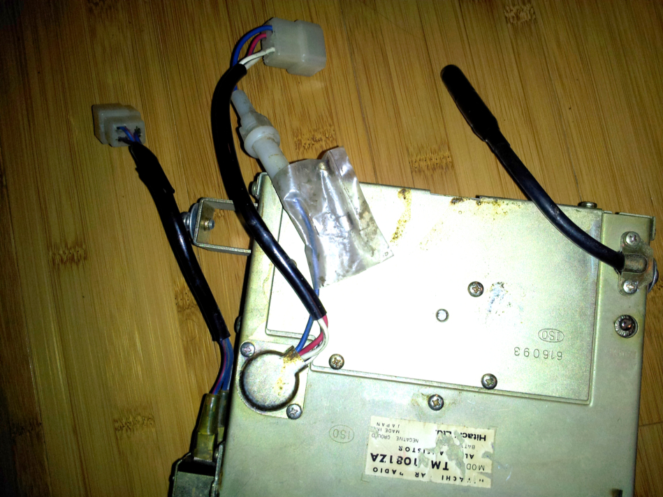

My question for Greg or anyone else here, is where can you get the RF Chokes from? Does anyone have a suitable supply? I'm referring to the little coil thing that sits next to the glass fuse in the plastic fuse holder and the spring with it ideally.
Pictured below (with a spring, any idea where to find the spring also?)..
Good news is I found the fuse holder here for purchase.
https://www.240zrubberparts.com/apps/webstore/products/show/7920455
I have the reproduction stickers thanks to Greg earlier in this thread.
I think this is the right OEM power and speaker loom connector here.
http://www.vintageconnections.com/Products/Detail/66
I also have reproduction faceplates and knobs..thankfully.
So to finish my radio's restoration off I just need to find:
1. The spring that goes inside the fuse holder.
2. RF Choke itself (coil thing pictured above) - That suppresses unwanted noise.
3. A suitable operating globe (green / ignition switch light) - not the operating light LED itself (on front panel). I shamefully dropped the globe by accident and it shattered so need to source a replacement, even an LED with Green condom over it would be suitable. Just need to know the size or what others have used?
Any suggestions on where to get these 3 items would be very much appreciated..

Hi Gav---
Very nice work restoring your radio!
I think you need a ba7s bulb---
Here's a link to the bulb and dimensional drawings so that you can confirm fitment clearances.
https://www.superbrightleds.com/moreinfo/miniature-and-subminiature-bulbs/ba7s-led-bulb-1-led-ba7s-retrofit-car/10/76/?gclid=CjwKCAjwnIr1BRAWEiwA6GpwNY4zgUw__K-ofFFCw1QEY9q7xIUt6ILpyRrSvUIGgdD1BgXCZCfctRoCyFkQAvD_BwE
3 hours ago, Gav240z said:
Any ideas on the RF choke and spring?
Best bet is to reach out to fellow hoarders for replacements.
There are more than a few here who have gutted the original radio internals and have just recycled the case and faceplate, using Retro-sound, or equal, modern solid state components for their myriad features (Bluetooth, etc.)
These wouldn't need the rf choke and probably have their own integral fusing. Someone surely has kept these original bits and might pass them on to you for your restoration.
Put out a plea in the "Wanted" classifieds-----
@zKars or @jfa.series1  might have spares--unfortunately I do not. I will ask around and see if any turn up from my contacts.
