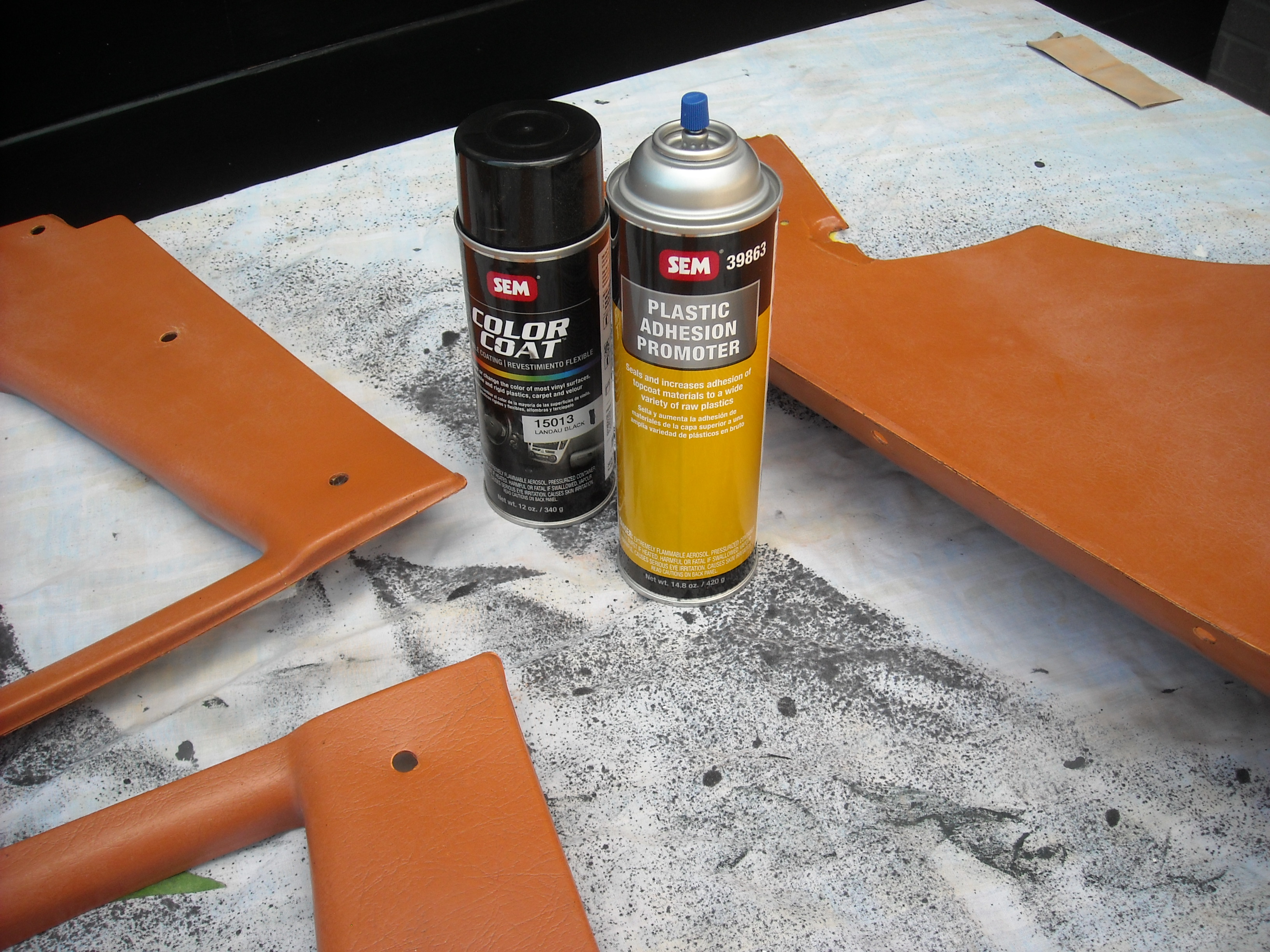

gundee Posted April 13, 2016 Share #39 Posted April 13, 2016 45 minutes ago, cbuczesk said: Some of my red interior panels had faded nearly to white. I took all of them out including the door panels, cleaned them very well, wiped them down with lacquer thinner and then applied SEM red vinyl dye. That was several years ago and it still looks great today. You can repair your cracked panels and dye them with SEM white or get some good used panels in any color including black and dye them white. I have a white rear side panel that after closer inspection I discovered was originally black. SEM products work very well! Yes, I have used the SEM Napa red on my red interior vinyl. It looks to be a perfect match. Good stuff. Link to comment https://www.classiczcars.com/topic/53345-options-to-restore-plastic-panels/?page=4#findComment-492560 Share on other sites More sharing options...

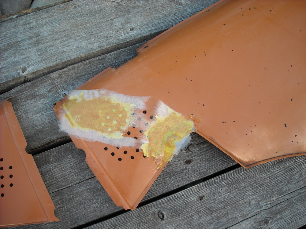

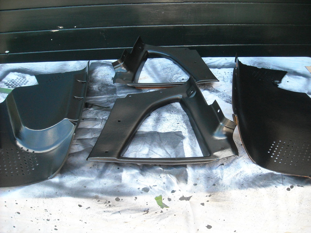

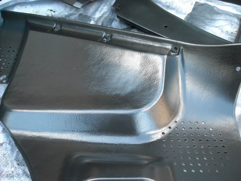

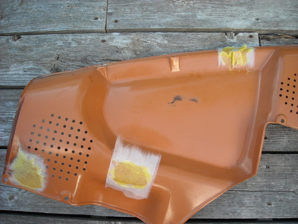

grannyknot Posted August 30, 2016 Share #41 Posted August 30, 2016 I used the ABS glue trick to repair my plastic panels before the colour change with SEM. After the ABS glue had hardened I applied two coats of adhesion promoter and four of colour. 2 Link to comment https://www.classiczcars.com/topic/53345-options-to-restore-plastic-panels/?page=4#findComment-502176 Share on other sites More sharing options...
Namerow Posted August 31, 2016 Share #42 Posted August 31, 2016 I took my Z's hard plastic panels from black to butterscotch using a vinyl 'die' produced by a Toronto-based supplier called Parasol. They custom-matched the colour based on a sample from the seat covers that I bought from Banzai Motorsports. Very happy with the results in terms of application, coverage, colour match and final appearance. Cost was about $130 Cdn for a quart. Applied with an HVLP gun. I used the same product on the soft vinyl trim, too. More difficult to get uniform coverage than for the hard plastic pieces (maybe because of 30+ years of over-zealous Armor-All applications on soft vinyl by PO's in an effort to keep them 'soft'). Still, I'm pretty happy with the results. Bottom line is that you can re-colour a Z's interior panels successfully using SEM or other similar products if you read and follow the directions. Only exceptions are the seats, where I wouldn't be confident about either coverage or longevity. The vinyl die mftrs might choose to differ, though. There are companies that seem to be making a make a good business out of re-colouring boat interiors (including seats) using the same stuff. Link to comment https://www.classiczcars.com/topic/53345-options-to-restore-plastic-panels/?page=4#findComment-502188 Share on other sites More sharing options...
