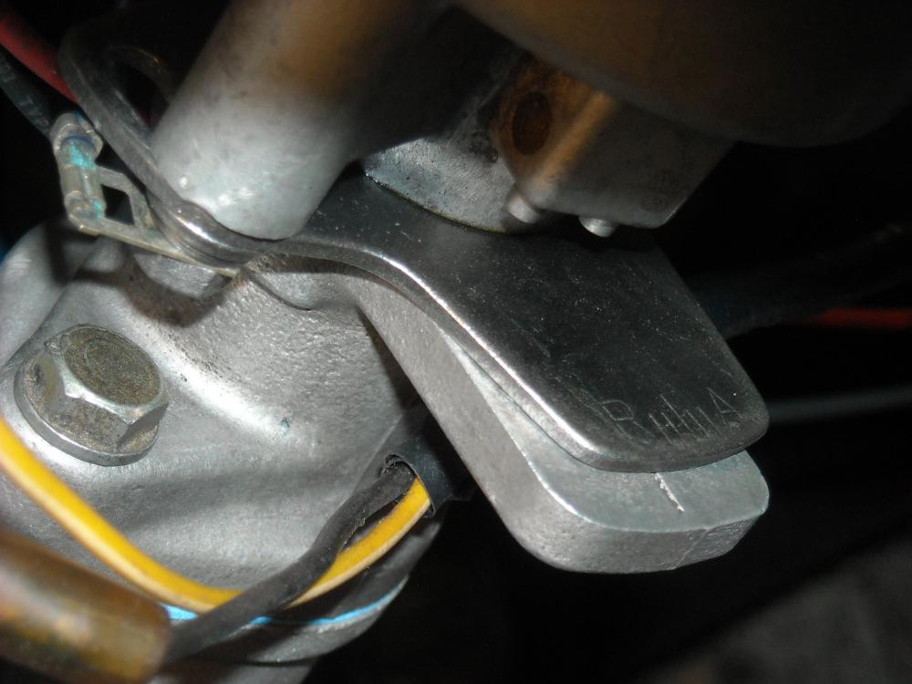

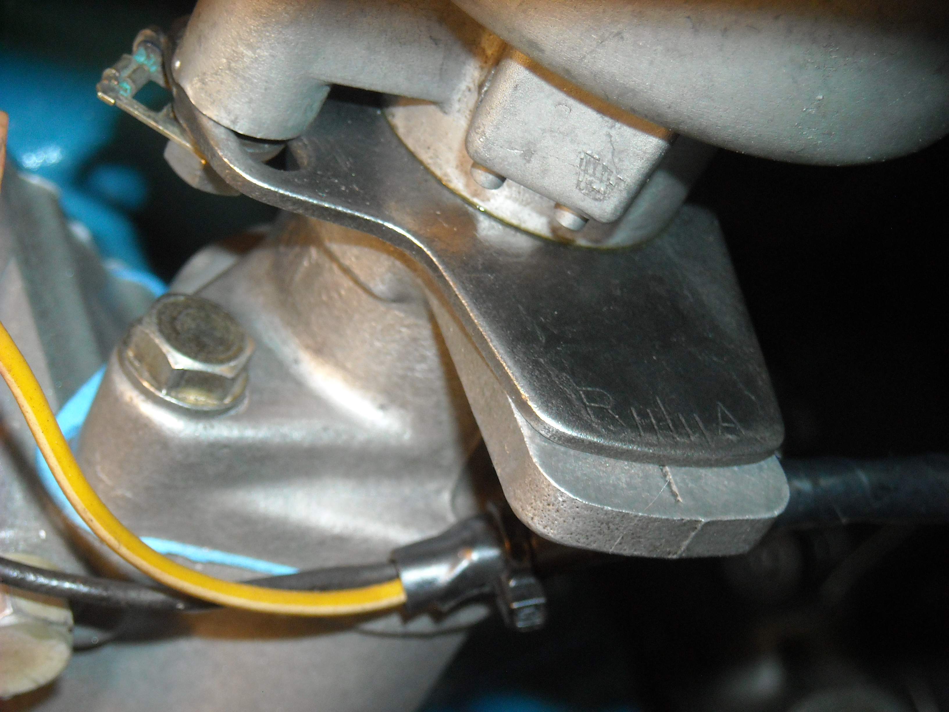

But, the distributor is turned counter clockwise as far as possible in both the R/A adjustment and the underneath adjustment in order to get that 10* at the damper.

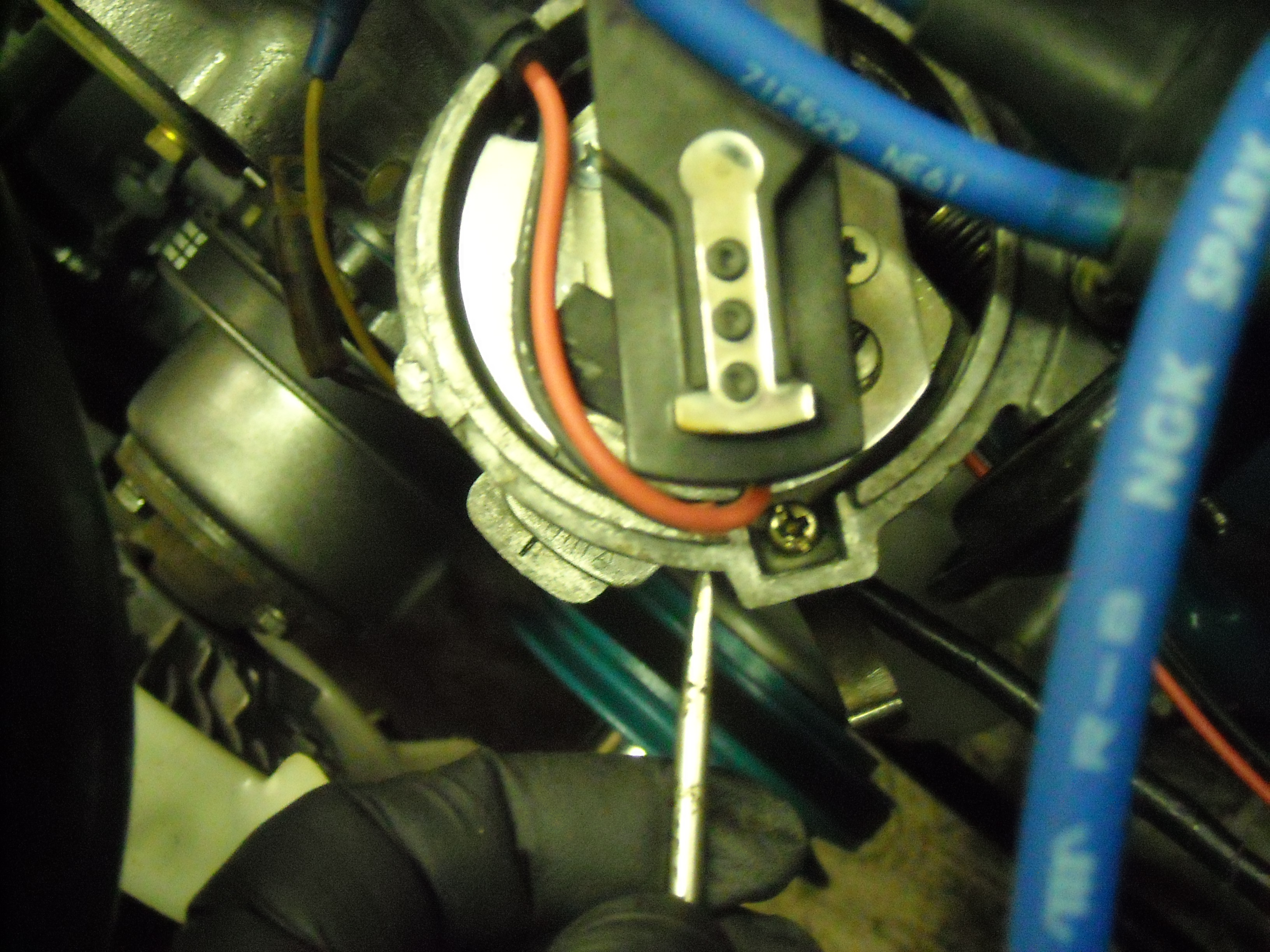

Here the small screw driver I am holding is pointing exactly where the #1 sparkplug contact is on the cap at TDC,
DSCN1283.thumb.JPG.710e54559c3fe8727109d

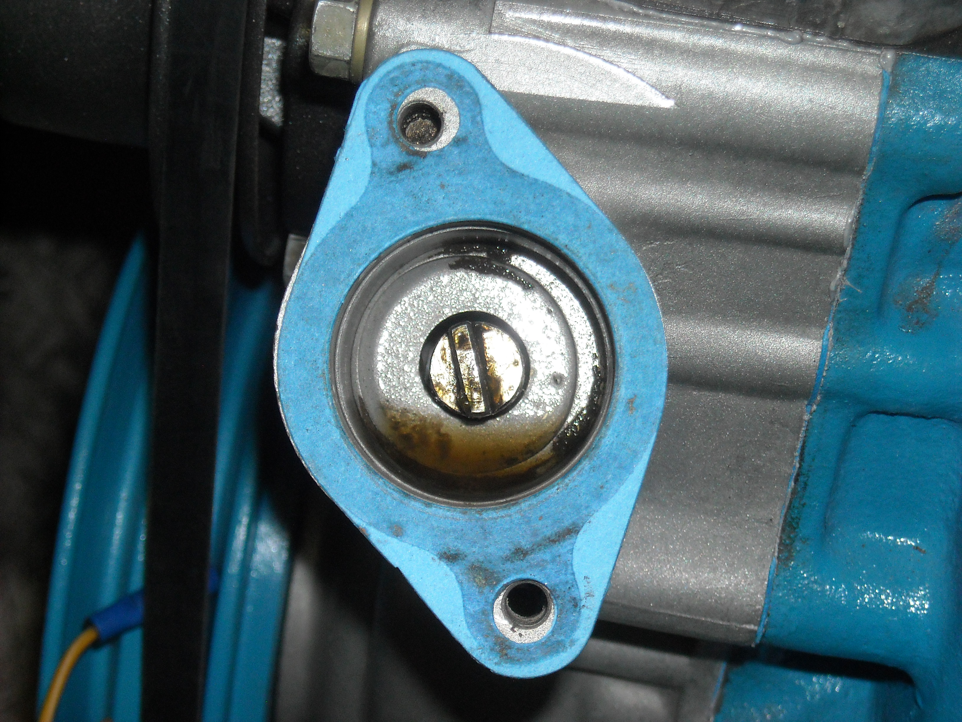

and this is with the distributor removed still at TDC,
DSCN1284.thumb.JPG.14bbb65fa05aad1552589
Even though the oil pump/distributor shaft position looks right I think I should lower it and and turn it one tooth?

Your distributor drive alignment looks to be off by about 5% or so, IMHO. That would explain the timing marks being off. Maybe Zed or someone can verify this. Im no expert but I think I'm right.

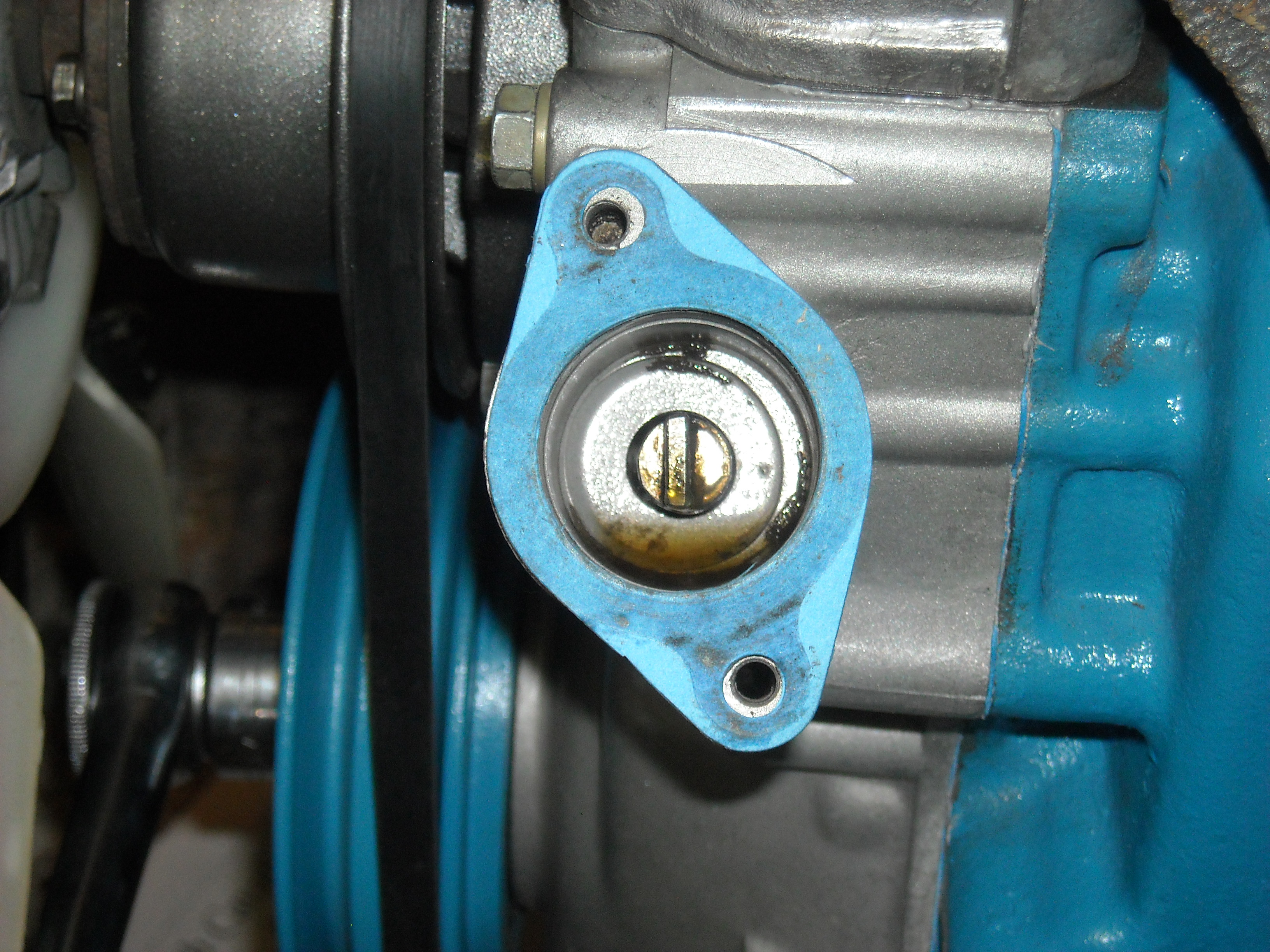

So, I dropped the oil pump and re-clocked the shaft one tooth over to this,DSCN1290.thumb.JPG.9ec68c879fd382c7eb266
which resulted in the R/A and the underneath adjustment in the dead centre of their movement and still 10* timing.DSCN1291.thumb.JPG.618c88b70db14dc78173a

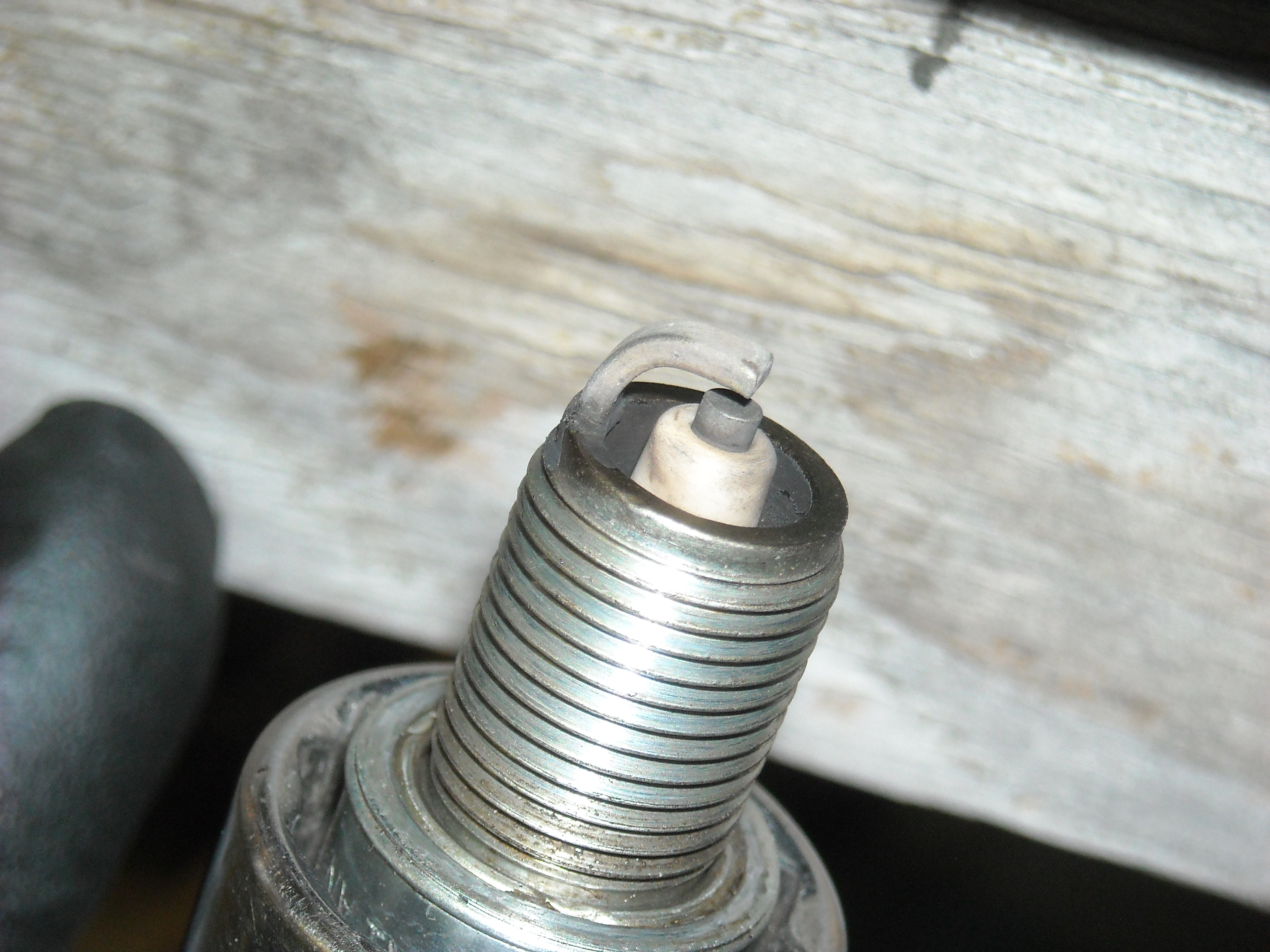

After 30 min. idling at about 800 rpm while I played with the distributor and carb balance the #1 sparkplug looks like this,DSCN1287.thumb.JPG.974feb39f14b0f81be478
