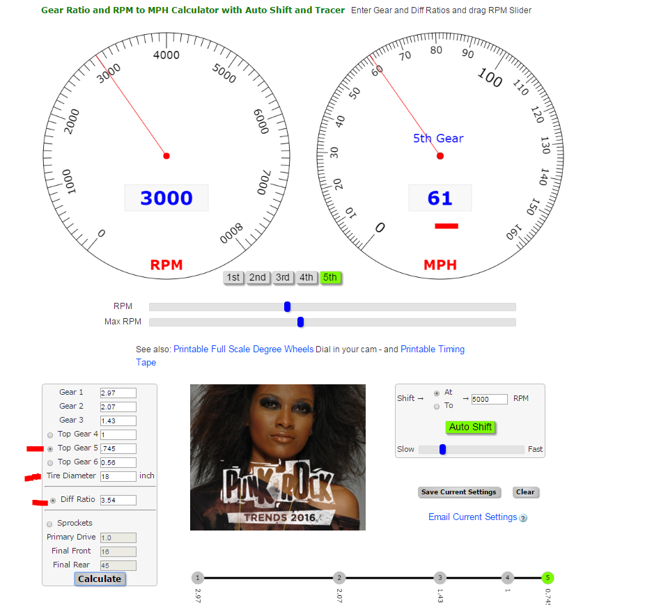

On 2/27/2016 at 0:14 PM, Zed Head said:
I have the 1980 5 speed, with 3.9.  And my 5th is .773, not .745, like 1983.  My car cruises easily at 60 mph for distance.  25.3 inch tires though.  The 1983 .745 5th with a 3.54 seems like it would be best  for highway cruising.  When I had the 3.54 diff, 1st gear felt sluggish, so I went to the 3.9.  Basically, the stock 1980 280ZX setup, except for a slightly larger tire.  At 60 my car should be at 2400 RPM.
That's a nice calculator. Thanks for sharing.
With the same tranny, 23 inch tires and a 4:38 diff at 3000 rpm I'm at 61 mph in 5th gear. Not something I would ever do in the race car. While my street size with the same 1980 tranny, a 3:90 diff and 23-inch tires at 3000 I'm doing 68.

With mine, I am running a 4:11 diff ratio with the 78 - 5 speed. I am using 205/60-15 to give me the oem tire diameter.
While it is fun around town, on the highway in 5th it just feels like it wants another gear shift.
With my set up I may look for a 3.70 diff.

FWIW I run 4.11 and with my 5 speed and 23.9" tires I turn about 3700rpm @ 70mph.  Makes for loud highway cruising, but I still get around 25mpg so out isn't so bad.  These engines seem pretty content to sit around 3500rpm all day long.

I have the 280Z 5 speed with the 3.90 diff in one of my Z's.  It works really good.  The overall gear ratio in 5th is 3.369 which is basically the same as a stock 4 speed 240Z. (tire diameter not in the calculation, just the tranny and diff gear ratios).  The 3.70 will give you 3.20 overall in 5th.
If you want to keep the 4.11, I recommend switching to the 280ZX 5 speed, which has the higher 5th gear.  The overall gear ratio in 5th with the 4.11 is 3.061.  This is what I have in my other Z with a 4.11 diff ( turns 3300 rpm at 70 mph).  (NOTE: I normally run a 4.44 lsd diff, but it is out for repairs.)
