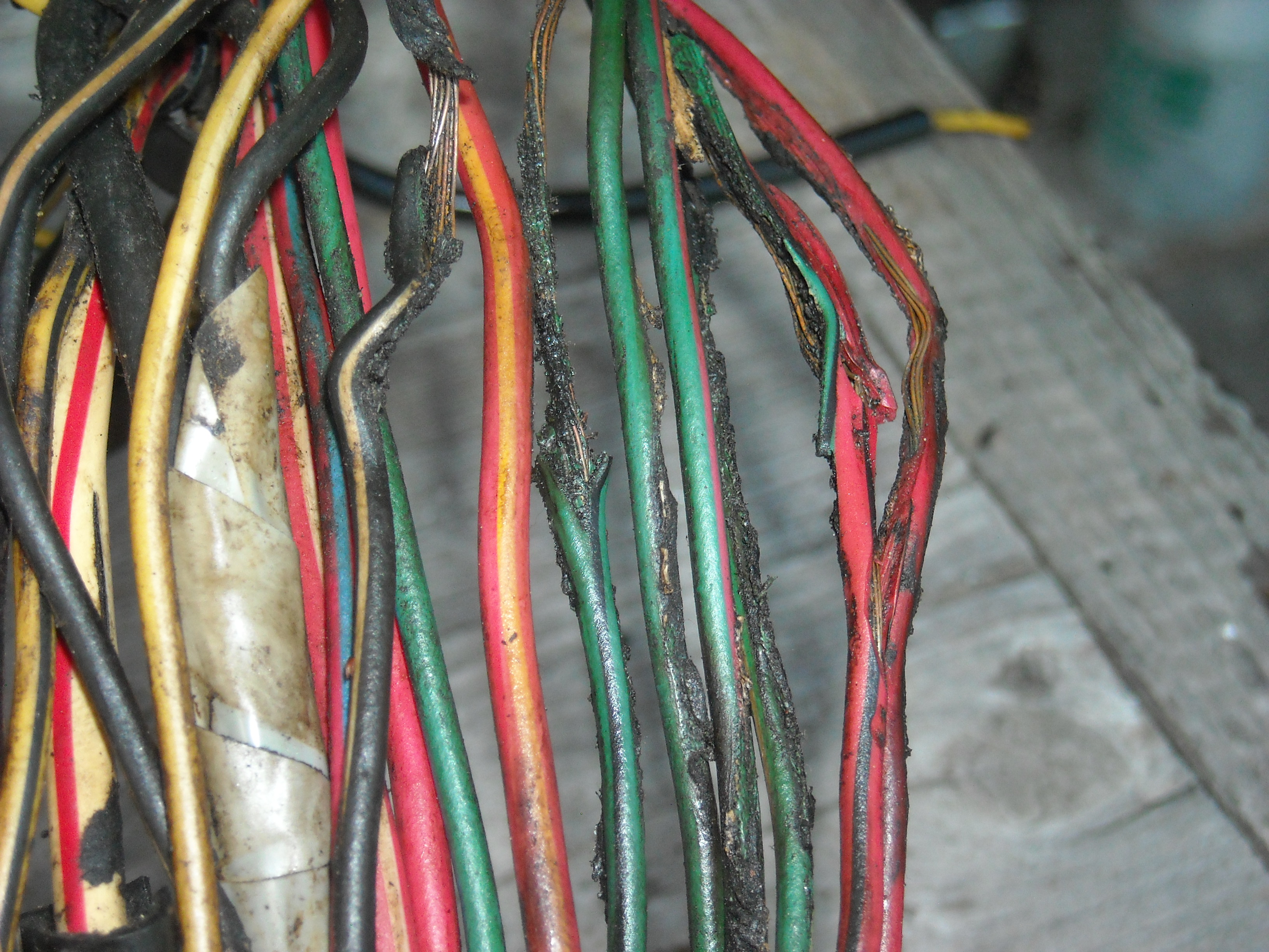

I took apart the B lug harness and found that the white/red stripe wire had a bad solder repair that looked like it was in the factory wrapping. I cut it and resoldered a better connection. Unfortunately I have an open still. The plain white wire that goes to the starter fusable link is also open. Where do both the white and striped wire go inside the dash? I assume they connect somewhere to provide alternator power to the battery.

I think that there's a fusible link on the charge wire.  It may have blown when the smoking started and saved you from more damage.
Seems like you have something wired wrong and you should probably figure it out before replacing the link, if you can find it.  It should be exposed, not buried in harness wrap, so that it can be replaced.
I'd start from scratch and examine all of your wiring.

Do you think that the soldered wire was factory?
Edited by SurferD
I don't think that factory used soldering to splice or tap wires.  They used crimped connectors.

Maybe some pics would help?
I believe that sometimes people think the crimp is non-stock and try to fix it with solder.  Or just don't like crimps and solder as an improvement.  Who knows.  I remember finding my first crimped connection in my 280Z harness and wondering what the heck it was doing there.  Before I knew a little more.  It just seemed so exposed.

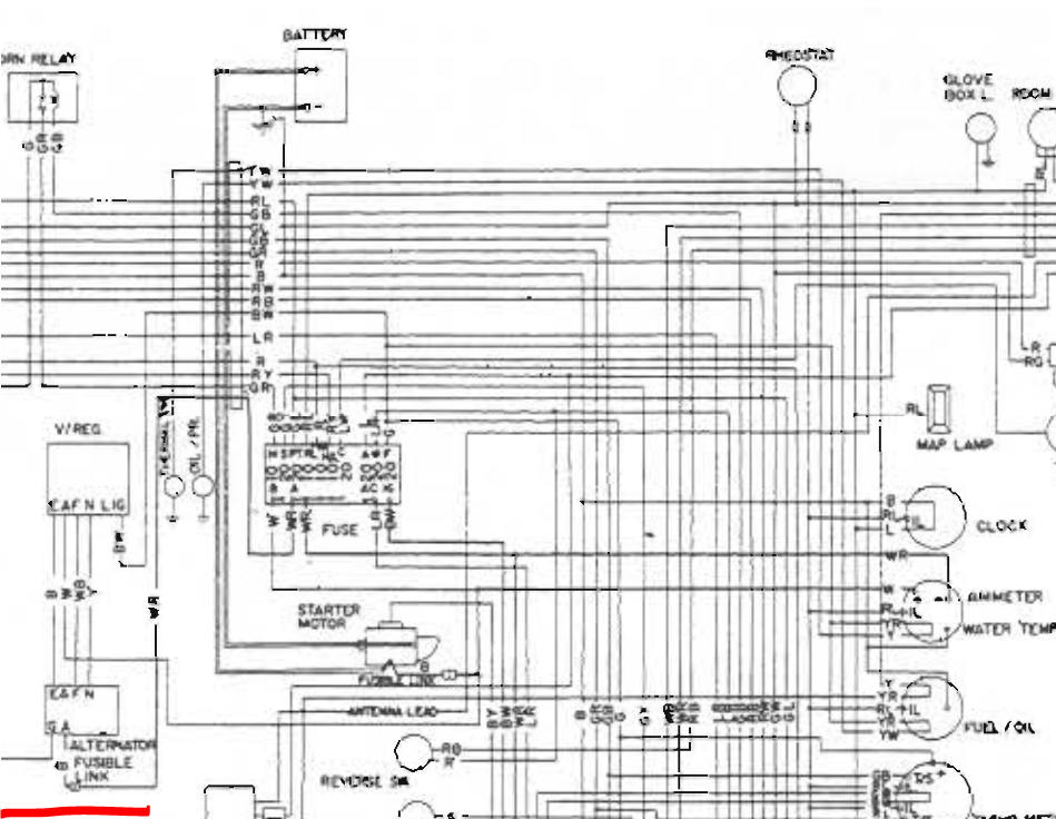

The wiring diagram from the 1970 Owners Manual shows an "alternator fusible link".  I would find that, it looks like it's down by the alternator.  If it's "fused" or "defused" though you'll still need to find the short.  It's probably on the alternator side, it would blow from battery voltage.  Leading to the possibility that your new/old internally regulated alternator is shorted inside.  OR you chose the wrong post on the alternator.  Makes sure that the post you connected to has a B stamped in to the housing, AND check its continuity to the case and ground.  The B post should be open circuit, non-continuity, to the alternator case.  Maybe you just got a bad alternator and the fusible link did its job.
Edited by Zed Head
Forgot the picture
