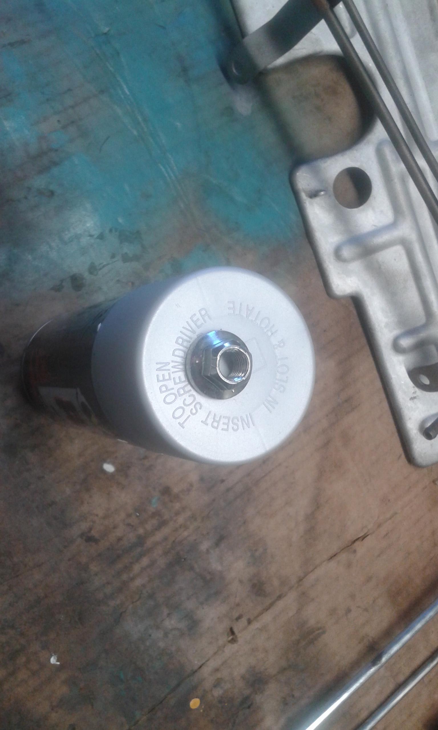

I've heard conical nuts before but jet nut is new to me. All my exhaust manifold nuts are that way. I bought them from Nissan too. If you could have seen what I took off you would believe me when I say they were original to that car. The bushings crumbled in my hands
