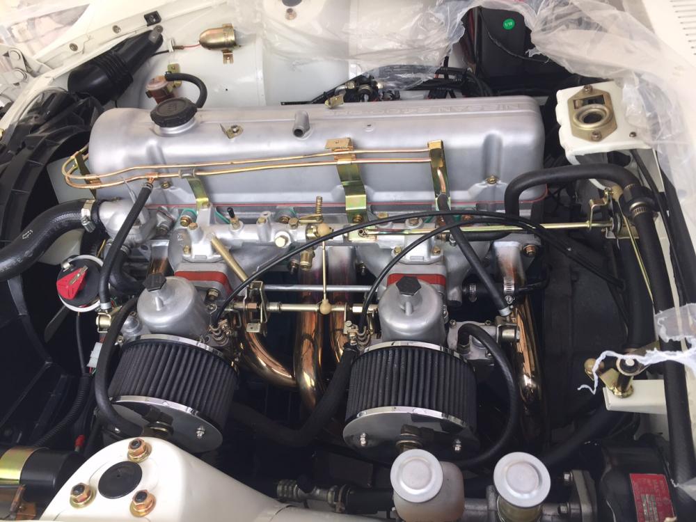

I didn't know whether to put this in the Body & Paint section or Engine section.  A few months ago I picked up a 2400 valve cover that is in very condition.  Years ago the previous owner had cleaned and wet sanded it to smooth it out.  I am wanting to get it back to original as possible but I am having a hard time finding what an original really looks like.  Were they painted grayish silver from the factory?  Did they have a smooth finish or cast finish?  Based on what t looks like now should I just leave it as is?  Any details or pictures you guys have are greatly appreciated.  Below is what it currently looks like next to the series-1 air cleaner I plan on restoring soon.

The valve cover was not painted from th factory.  The finish was a dull, grainy, cast, finish.
I would look at your SU carb domes, and balance tube if they have not also been
polished.  In stock condition, they should have the same raw metal, cast finish as well.
You may be able to restore the stock finish and appearance by experimenting with
media blasting, possibly using glass beading.
www.ztherapy.com has some pictures of valve covers that I believe represent the original
stock appearance.
Hope this helps.
Dan

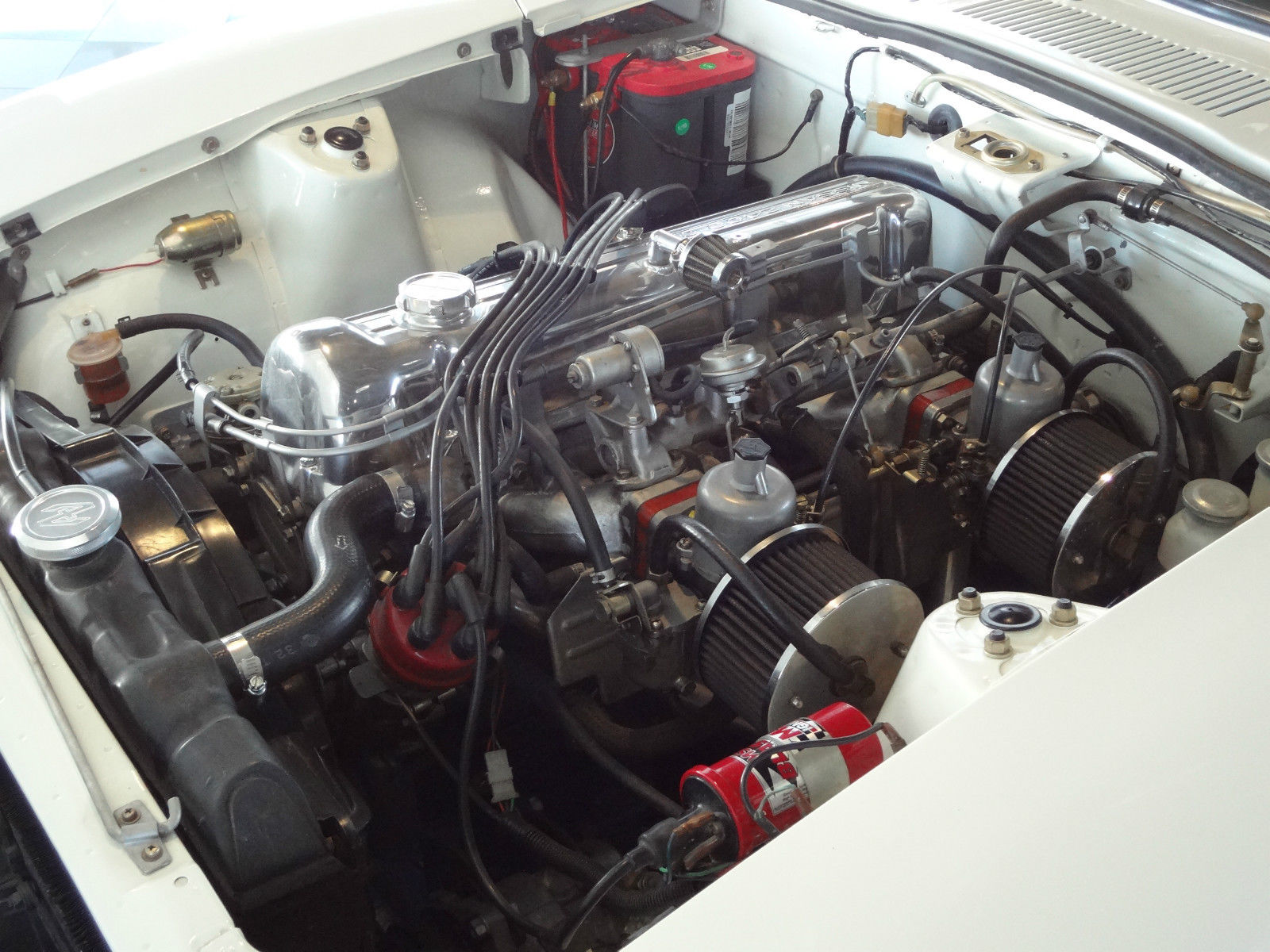

Looks good as is. I'd use  aluminum polish and elbow grease, toothbrush to work polish into difficult areas, and a polishing attachment on a drill for final buffing. Need to shine it up now and then to keep it looking great. Maybe easier when it's on the car except for fuel rail area. A year since I shined mine and it needs it.  Maybe I should try wet sanding mine or using some rubbing compound before polishing, cause that one looks better. Racers used thin black paint for better heat transfer. I saw a beautiful grey one at a car show, owner said it was powder coat. Keeping mine as is, though.
I like your ideas guys of leaving it as is and just polishing it some more.  Plus, it will be easier to maintain with the smooth finish.  I don't want to polish it to a mirror finish but I will work to get the color a little more consistent.  I will post updates as I make progress with it.

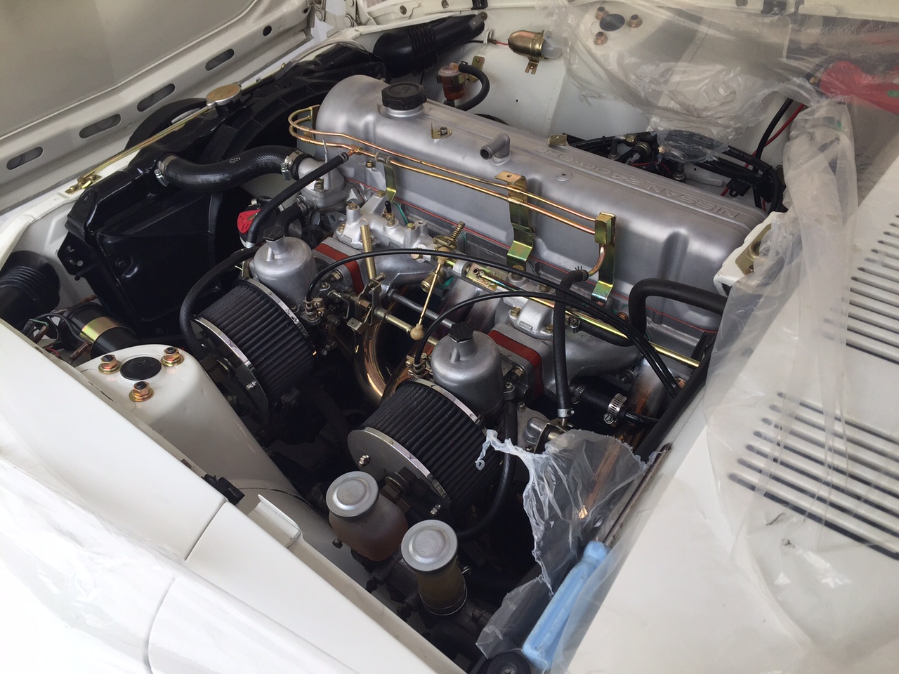

Here are some pics of the valve cover after vapor blasting. Very time consuming and tiring process. It was more satisfying and easier doing the balance tube or any heavy grain casting vs a smoother surface like the valve cover. However, i'm very happy with the outcome and I think it looks very clean. I might coat it with Shark hide to protect it, but for now i'm glad I did it.
